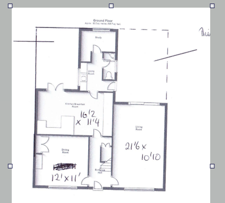

Recent Profile Visitors

  1. Hi all....tonight we've sent an email (our architect is going to approve it 1st) to the planning officer to request an indication of whether we were to knock down our garage (which can be seen from the road) and old utility room (combined floor space of 40sqm) and instead using this space to build the single storey on the back of the house. This way we aren't asking for additional space just moving it. Plus we would then be giving back to the green belt! As requested this was the official decision notice ....... "The proposed development would constitute inappropriate development within the Green Belt and additional harm would result from loss of openness. The harm by reason of its inappropriateness and loss of openness is not clearly outweighed by other considerations, nor have very special circumstances been demonstrated. The proposal is therefore contrary to Policy GBR1 of the East Herts District Plan 2018 and the National Planning Policy Framework"
  2. Thank you all for your comments, we have had a good read and it's given us some thoughts. We are thinking of maybe submitting a new application asking permission to knock down the existing garage and utility room and using the floor area these took up as an addition onto the back of the house in effect creating what we originally applied for without actually asking to increase the size of our property - if that makes sense! Their refusal of our original application because of "openness" surely would then fall flat because we are removing the garage that can be seen from the road and giving back to the green belt!
