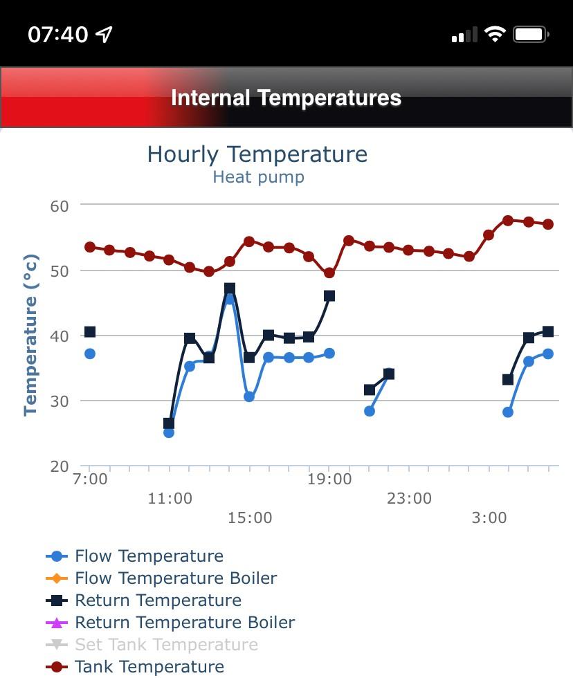

  17. Hi! First time posting. Recently got an Ecodan R32 commissioned and I was reviewing the data on the provided reports and I was confused with the flow and return temps. On the attached report it consistently shows the flow temp being lower than the return, which I think it wrong. Am I right here, based on the screenshot, has my installer put these on back/front? Thank you!
