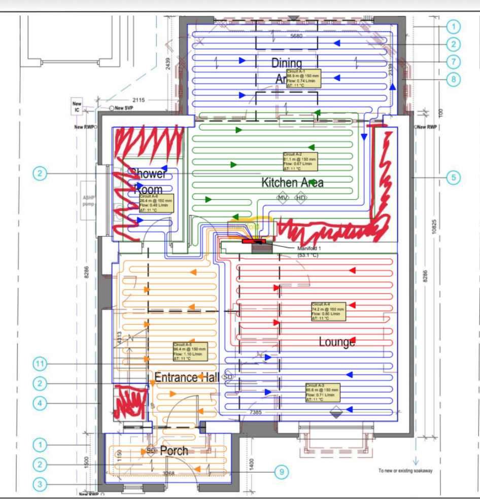

We have a two phase approach to remodelling our house. At the moment we are replacing a conservatory with a single story extension to make a large kitchen area. This will have well insulated floor (150mm PIR) and we are putting UFH in. The room is about 30 m2, it will have two loops but obviously be a single zone. We've had some heat loss calcs done and worked out the pipe spacing and I'm playing in loop cad with designs. The rest of the ground floor will be done in 4-5 years time. Almost certainly add an additional 4 loops. At the moment we will run the UFH from our boiler, but our plan is as soon as we can do phase 2 and insulate the whole house to run the whole thing from an ASHP. We do not want to dig up our newly laid kitchen floor then. It would be way easier to have 2 manifold locations (all be them separated by only 30 cm of wall). One of them for the phase one renovation, and the other for the phase 2. This is because we don't want to lay a porcelain floor then dig part of it up in 4 years. The alternative would be to knock through a part of the wall, install a small beam, buy a 6 -port manifold now, use 2 of the ports but have everything ready for the next phase. The problem is this would come out into our hall. Currently this is (I believe) an uninsulated concrete slab which we will dig out in phase 2. I really don't want to start digging out a section now or try digging around UFH pipes. Can you see a problem with having two manifolds other than price.

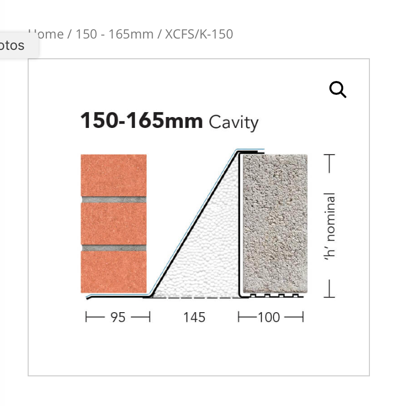

As an update Catnic have a thermally broken lintel but at the cost of 2k from a builders merchant. This seems beyond our price range. Keystone have suggested this beam XCFS/K-150 , but looking at it I can't really see the advantage of it over the UC with a bottom plate that was originally proposed. Birtley don't have thermally broken lintels that would make a 3.8m span. I understand that the detailing around split lintels is complex, but this remains an option. -

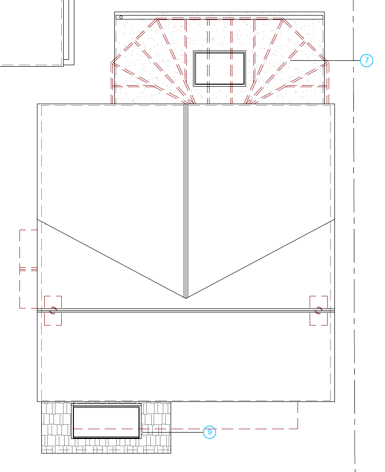

Hi, I would appreciate some advice. We extending our kitchen with a NNW facing single story extension. We're looking at putting in a skylight, but are very mindful of overheating. We're thinking about future climates. The extension part will be about 5.7x2.4m. In midsummer the window will be in shade between 11.30-4pm but will get sun outside of these times. Our roof will be very low pitch (ca. 12 degrees). Option 1 would be a Velux low pitch roof window 114 cm wide x 118cm with anti heat shutters. This would be uValue of 1.1 but if we shut the shutters at night then this will improve. we can also shut out the sun if it gets too hot. This is around 2k Option 2 would be a Roof Maker style roof. This wouldn't open, but we're fine with this. I feel with the upstand this might not look so stylish, but again we're ok with this. The uvalues are better and we can get solar control glass However, I cannot see any options for blackout shutters outside. There are several options for blinds inside. And of course there are solar coatings. I feel that the inside blinds won't be as good for blocking heat. At the moment this will replace a conservatory which has much more glazing but gets unbearable in summer. I would much rather be conservative regarding overheating. If you were in a similar position would you go for option 1 or 2?

Let me try again. It didn't help that I said "manifold" when I meant port. In the long term we plan to run UFH throughout our house from an ASHP, with a unitower located where the manifold is in the schematic. Our house is currently unsuitable for a heat pump, but we are planning to get it heat-pump ready by concentrating on insulation and airtightness as we renovate our house. Due to costs, we will do our renovation in two phases. The first will be the rear extension (dining area) and kitchen. We will replace the floor as port of this. Insulate with 150mm PIR and run UFH in this area. This should need a manifold with two ports, and by my understanding this can be run from our combi boiler with a two-port valve. In the coming years (3-4) we would then replace the floor in the rest of the house with an insulated slab and run the UFH throughout. We really can't afford this at the moment. At this stage we would need to replace our two-port manifold with a four port manifold, and the whole thing can be run from an ASHP. The problem that concerns me with the above plan, is that we would have to dig out a bit of the screed in front of the kitchen door in a few years, to add the additional UFH pipes for the rest of the house (as per the diagram). My concern is that as additional pipes came to the same manifold then we would need to dig out screed very close to the existing pipes. Perhaps this could be done carefully, and would be slightly easier if we used one of the egg crate mats that would help protect and locate the existing pipes. I'm not sure if I'm over worrying about this. My other thought was that when we do the rest of the house, is it feasible to have two manifolds (one 2-port serving the kitchen area & one 4-port serving the rest of the house). If we can do this, and locate them on different sides of the same wall, then we will not need to dig out the screed in the kitchen. I assume that this is possible, but have no idea if it is sensible? I also might be overworrying about digging out the screed in the area by the kitchen door.
