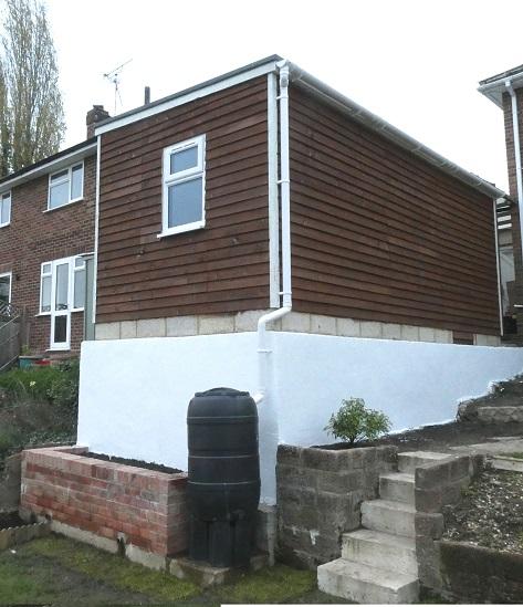

Hi everyone. Just an update on the garage build. I have plastered the exterior of the base for the garage, and then painted it white. Looks much better than before.

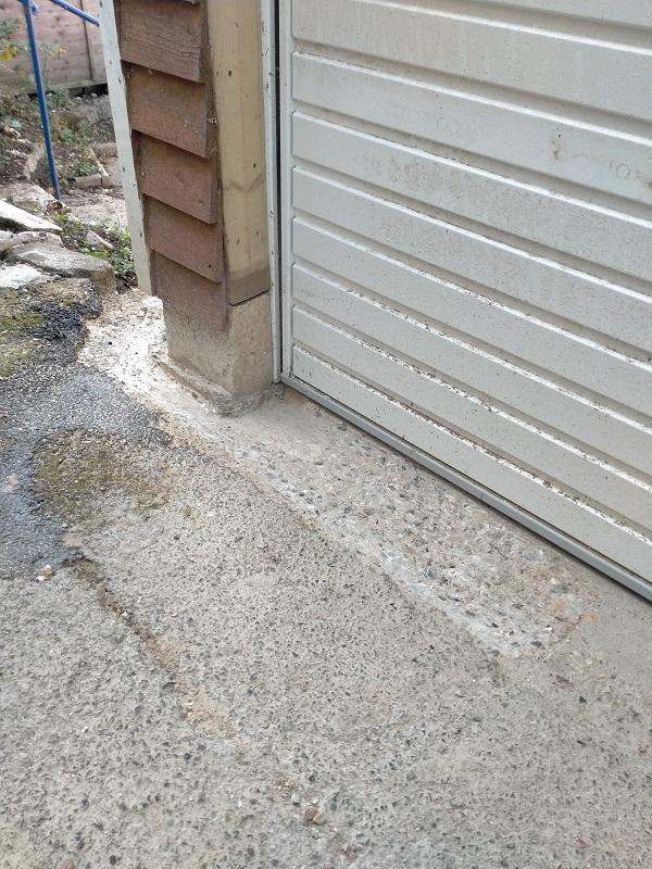

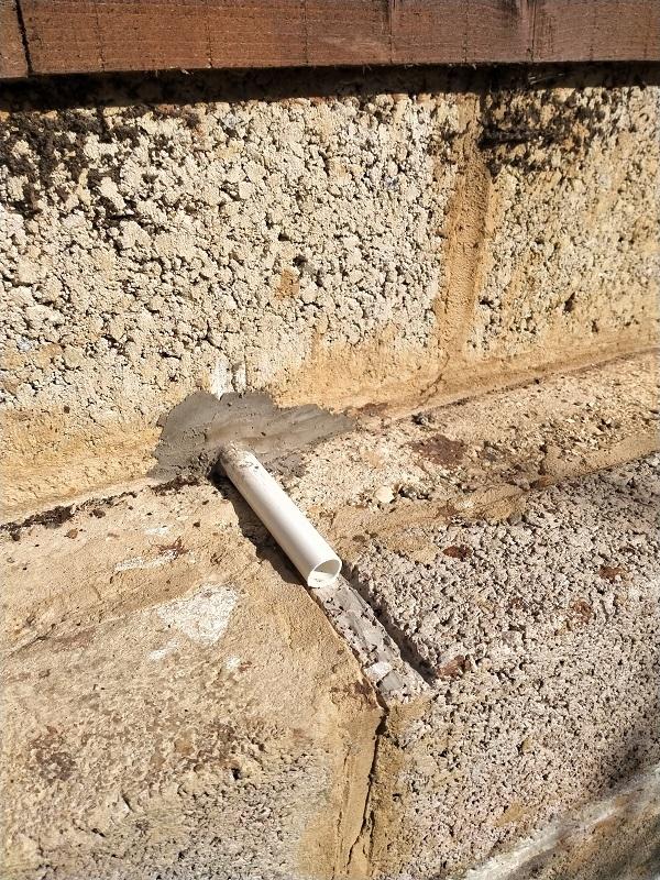

Hi everyone. Have made a few modifications to the garage. 1. As there was little light getting into the garage I have installed a window. I was surprised how easily they are to install given the right equipment and tools. Watching a few 'how to' videos on the internet helped immensely. 2. The recent downpour created a large pool of water inside the garage. To solve this I cut a channel at the entrance to divert any rainwater. One of the tools I used was a 9 inch angle grinder. Don't really like using it because of the risk factor however it does the job a lot quicker. 3. In case there is a rainwater leakage in the future, I have inserted an outlet pipe into the side of the garage.

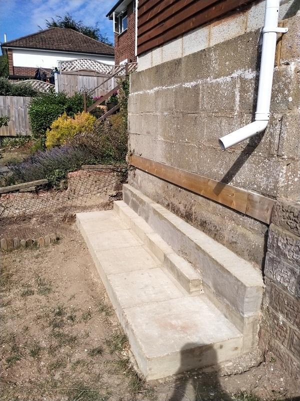

Hello everyone. The underpinning/ concrete base has now been completed. Altogether there were 6 holes/forms to fill with concrete .It takes 7 days for the concrete to fully harden so the whole process took 6 weeks. The next part will be to construct a raised brick garden bed, it will be one brick thick and 5 courses high.
Thank you for the comment. I designed the concrete base/pin myself. The concrete is stepped, the lower step is 320 mm deep and the upper step which helps support the footing is 420 mm deep. The form work used for the first concrete base will be used again as a jig to construct the other concrete base/pins. The upper step form will be modified so that it offset by 100 mm, as it was tricky placing in the concrete for the first base/pin.

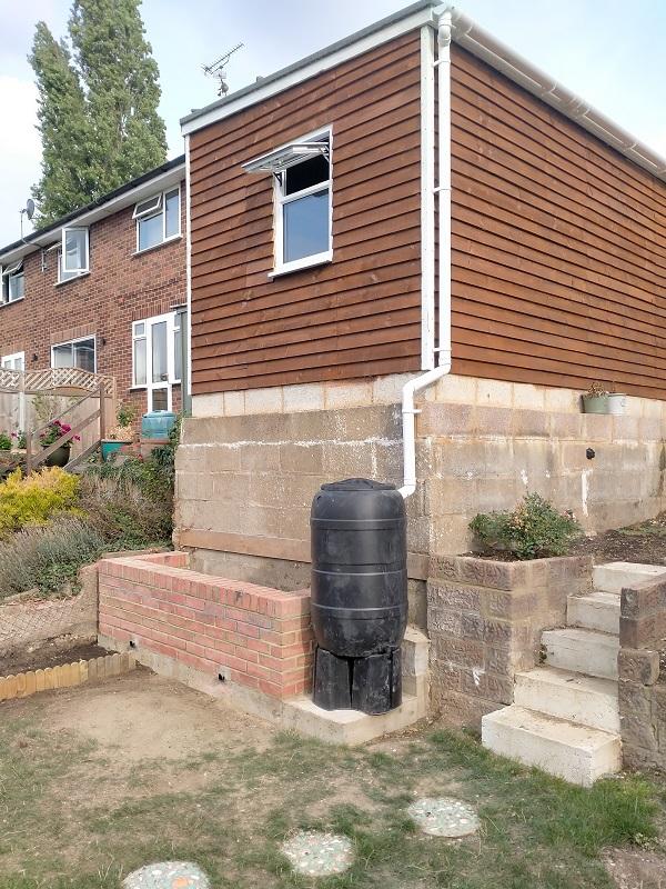

The Garage is now complete, the garage door was installed by professionals for reasons. There will be future modifications made such as adding windows and doors, changing the exterior walls to corrugated steel on the neighbours side and perhaps PVCu cladding on the other sides. Once this has been done sockets and light fixtures can be installed.
Hi everyone. Here's an update on the garage build. As you can see from the pictures it's almost complete. I'm having the garage door fitted in by professionals for reasons. As a response to comments by other members, the walls of the garage will be replaced with corrugated steel on the neighbours side and UPVC cladding on some if not all the other sides. This will make the garage more resistant to fire. I have also bought some Thermoguard Timbercoat fire protection paint which I intend to paint the framework with. When this has been done, it should be safe enough to fit any electrics inside.

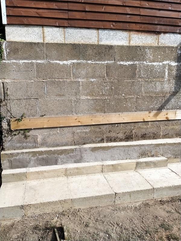

Hi everyone. Just giving you an update on the repairs to the garage foundations. It would appear that concrete pillars have been constructed at the corners to support the foundation and as mentioned by members hardcore has been placed inside. I decided to remove all the concrete blocks along the top which had become weathered and also the concrete block that had cracked. On removal of the blocks no hardcore came out, which was a good sign. I decided it would be a good idea to strengthen the hardcore by adding some concrete (see 2nd pic). As you can see the completed job looks a lot neater and tidy. The next stage will be rendering the concrete blocks with plaster and then painting it white.
