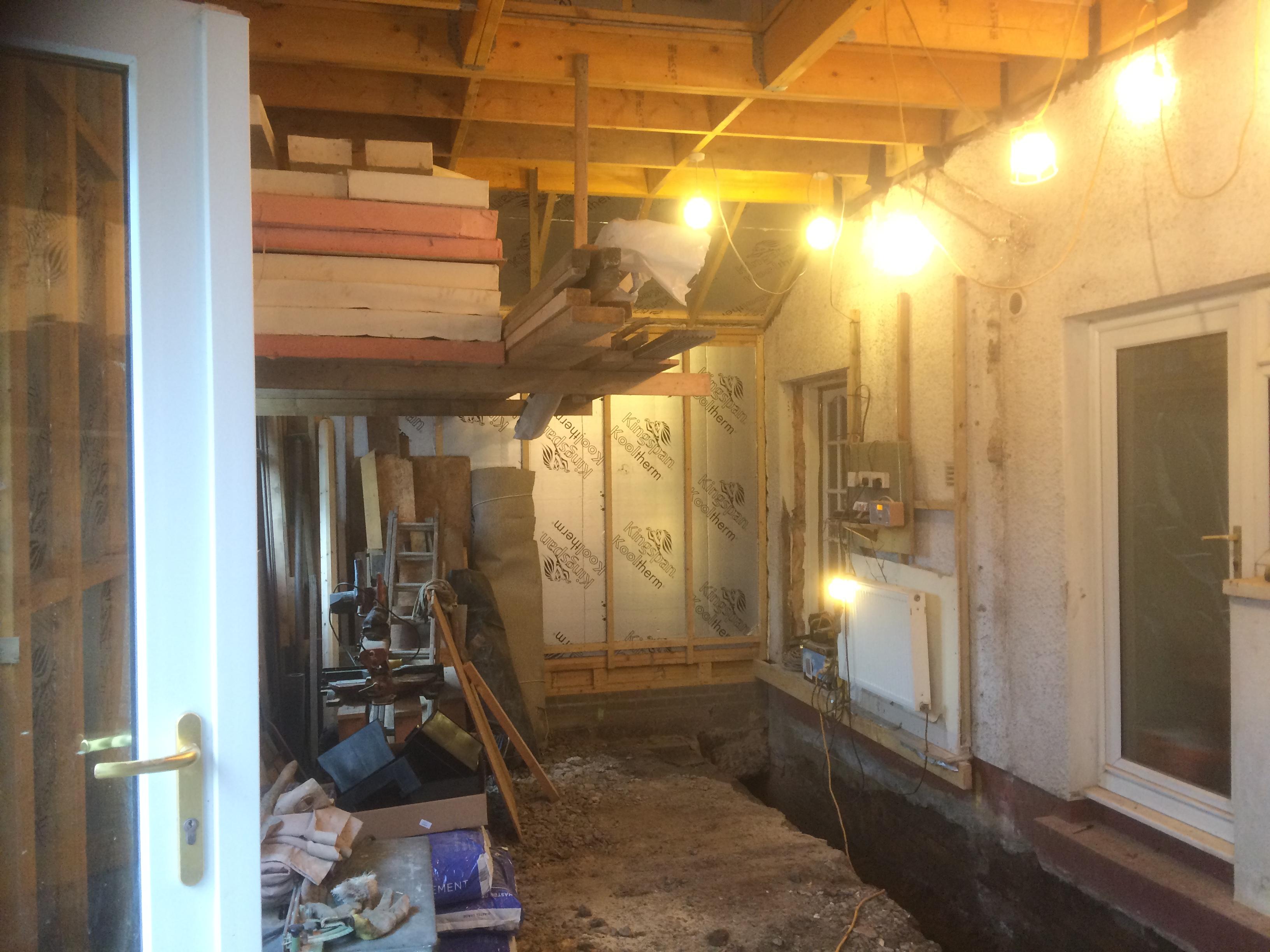

As a quick overview the project involves taking a chunk out of the back of the house and building a rear extension. One aim was to make this as least disruptive as possible so we could keep living in the house with some normality. Other reasons were to save some money and get something bespoke to us.

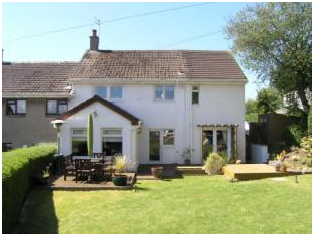

Photo 01: Sun room sticking out – freezing cold – to be demolished but kept as a secure store room for tools for a while.

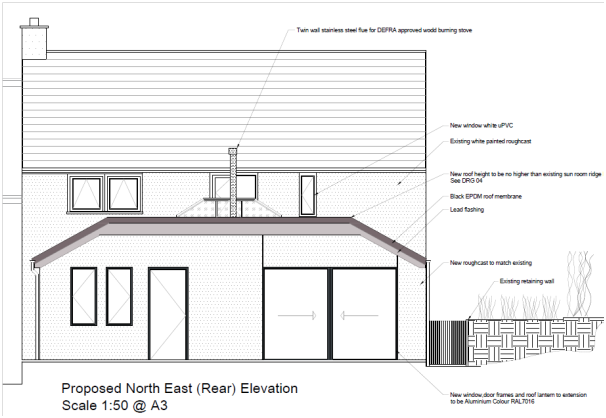

Fig A 01. Eventually..
What’s going on here?

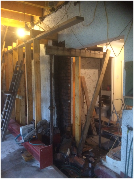

Photo 02 The extension is getting roughed out over the sun room, the sun room was retained for a while to stop dust getting into the house, security and so on. For the eagle eyed.. table saw, yes I know the table saw is missing the guard but it is “under maintenance”
The ladder (ex BT which some may recognise) was gifted to me by an old sparkie, who got it from someone, who got it from..

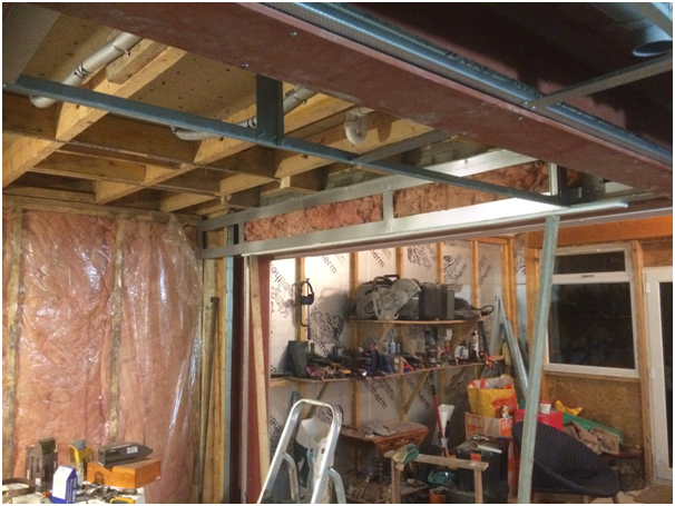

Photo 03:  Old sun room down and preparing trench (under radiator and old back door) for temporary strip found to support props. Really soft ground just outside the original wall hence the temporary strip found. The old doors windows are fitted into the new structure to give a bit of daylight. The radiator still works.. as I’m a bit soft.

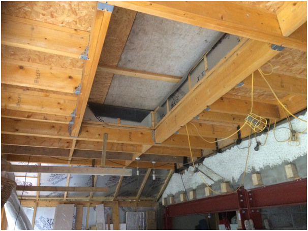

Photo 04: Timber props and needles going in.

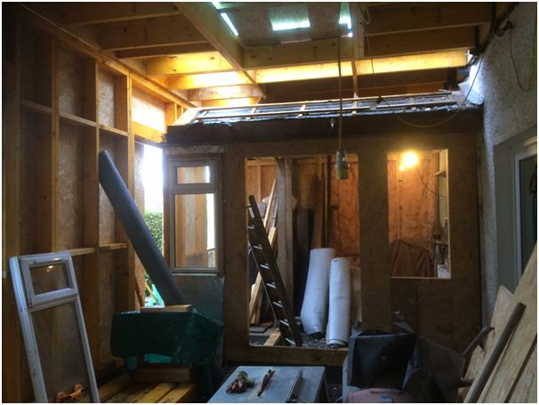

Photo: 05 The upper side of the steel with the needles cut back. “Sadly” the old sun room is gone. The timbers I could reclaim have been.. the rest has gone on the wood burner.
