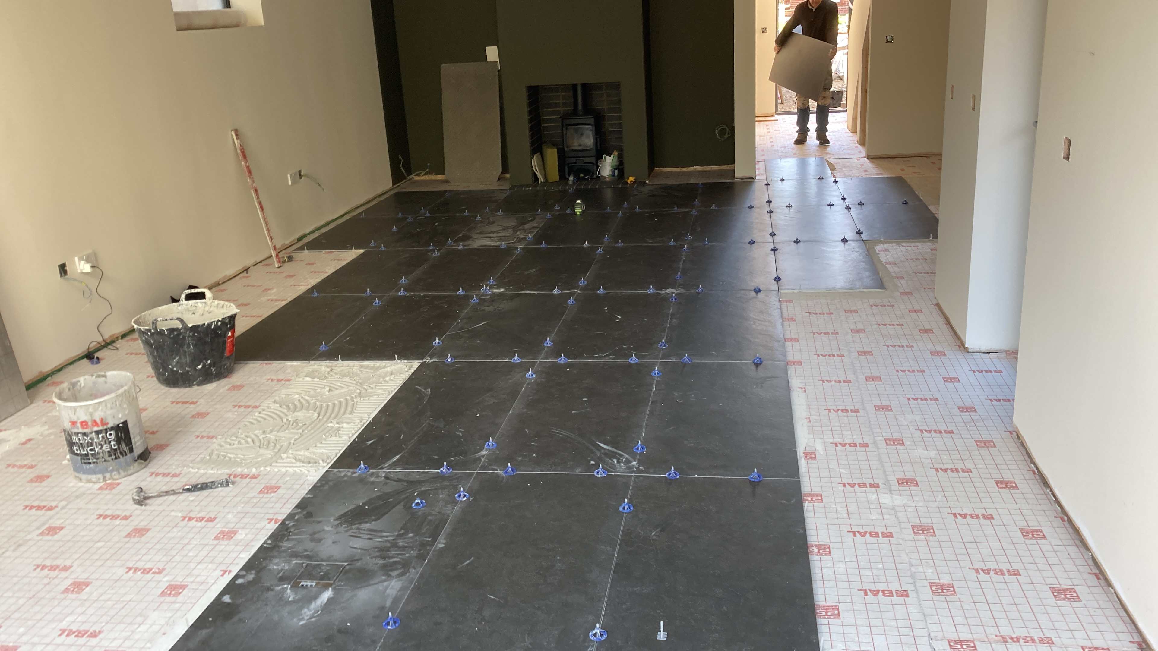

Downstairs we have porcelain tiles throughout, gently cooled by Maxi the moody teenager heat pump.  It has helped enormously and once we have a way of transferring some of the cool to upstairs life will be peachy, though it’ll likely be 6°C outside by then, given the current todo list.

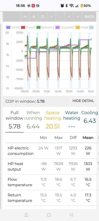

We’ve wrestled with Maxi to get it to a sensible working arrangement, and that work is ongoing.  At the mo if we set the WC curve (no, thats not the shape of the toilet pan) so that the flow temp is set to 15°C Maxi bothers for about 20 to 30 minutes and then sulks for an hour or two.  Following a call with the Energy Lab, the distributor of Maxi, it’s better than it had been as some of the settings weren’t sensible, but it must and will do better.
Our tiles sit at 19°C to 20°C, which matches the return temp to Maxi after a few minutes of sulking.  That makes for a noticeable improvement in downstairs temperature but it’s as low as we can get it without cranking up Maxi to full condensy by dropping the target flow temp loads.  A work in progress which is currently delayed by The Energy Lab being about as responsive as I am when a glowing J asks when I hope to get the fancoil(s) in.   SWC properly tested Maxi when first installed.  Sigh.

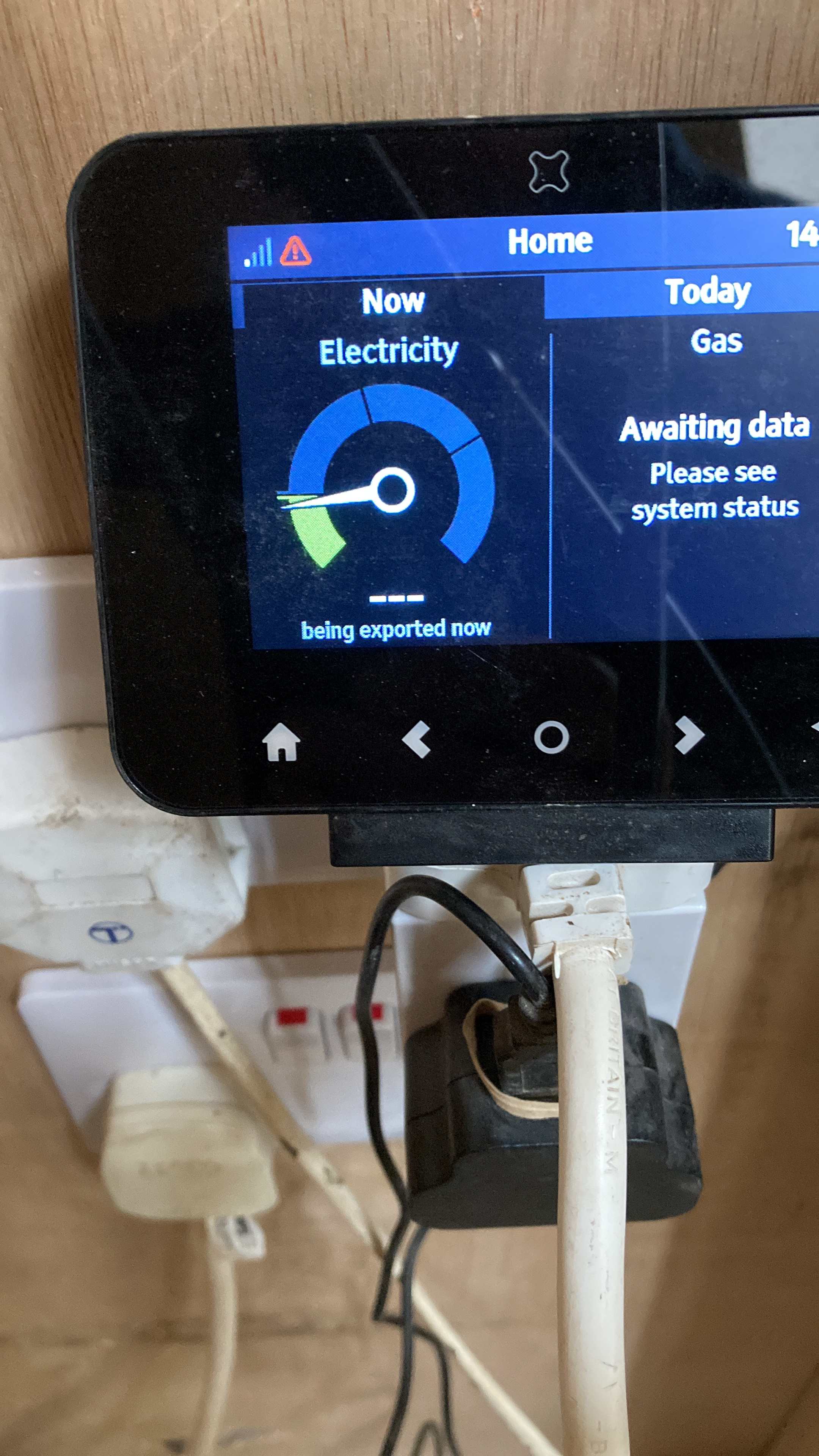

I’ll remember that long after I’ve forgotten the excitement of seeing the bathrooms tiled, or the downstairs porcelain floor tiling grow daily, or the test lighting of the woodburner, or us exporting lecky for the first time.

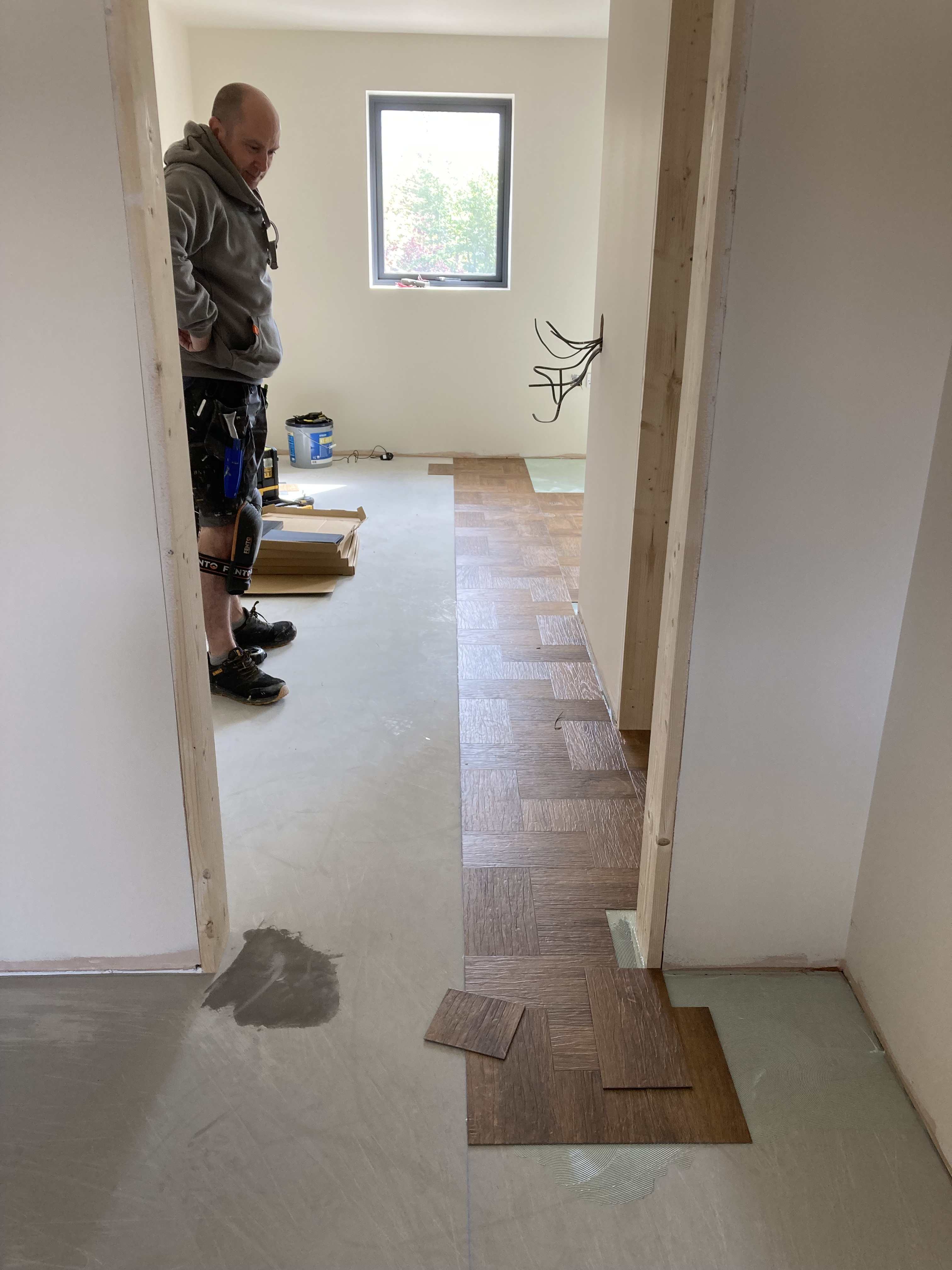

Bits of kitchen and utility room arrived and got fitted, painting got done, internal doors finally arrived many weeks after they were due and got fitted, and in odd moments late each day and at weekends I got to do stuff myself, including some plumbing.

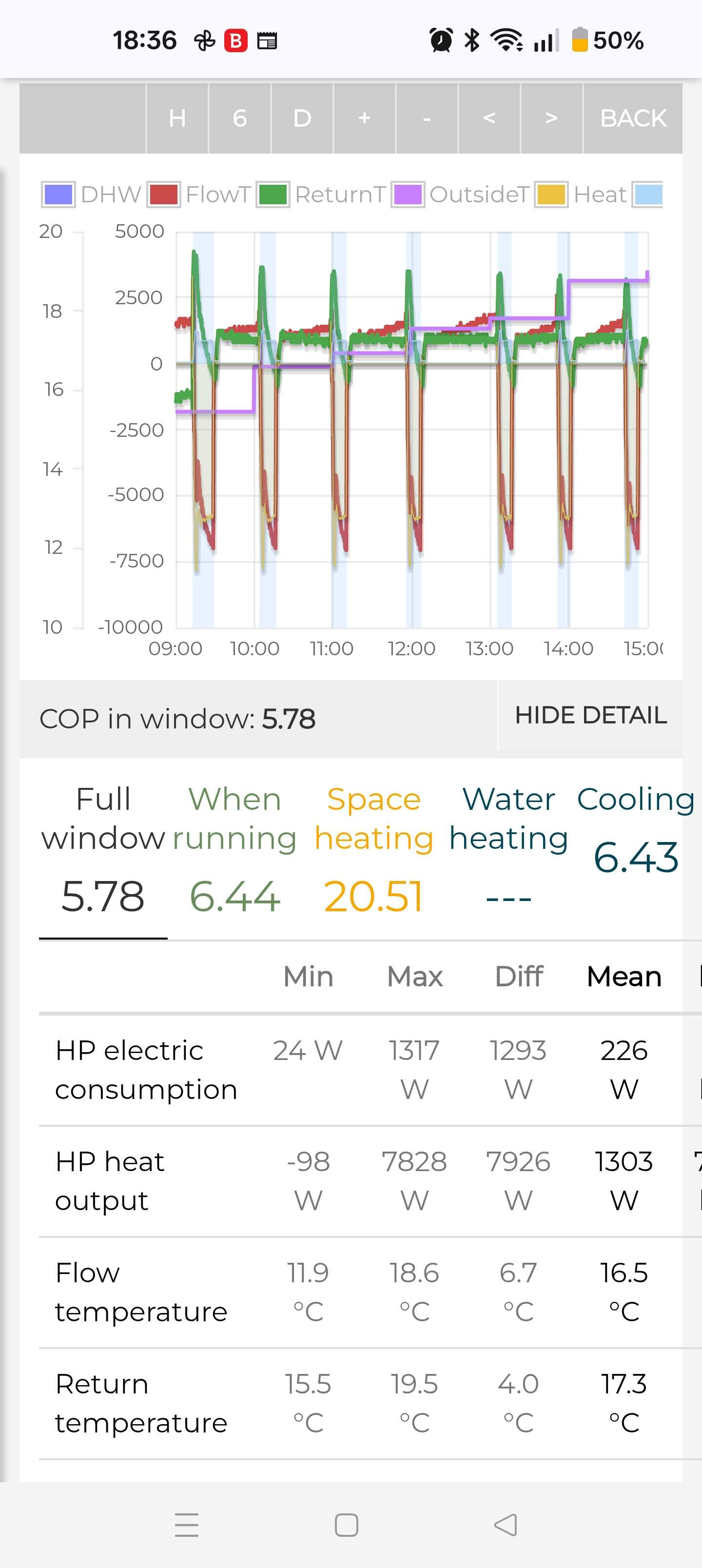

JohnMo
Posted
Maxa running cooling. Here is a shot of ours. With the cycling I sent the target down to 12.5. it made a big difference. Yes manifold got a little damp at the end of the cycle, but only for a few mins. Start from your 15 and lower it down a little at a time.
Don't be surprised if the installer has little or no experience with UFH cooling.
What size heat pump do you have?
