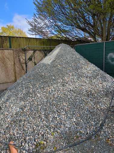

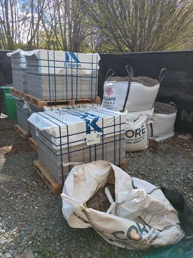

Decided to buy the materials I need to finish the direct surround of my house before Diesel shortages and goodness knows what else takes hold!
image.jpeg.b48e49ed0ffd909556cbb0b9231306eb.jpegimage.jpeg.678db770b47e4a48a59de6a6ed410110.jpeg
50+m2 of paving blocks, 3 tons of paving grit and a full load of type 2 MOT to spread around the house next month!! I plan to get bound resin for the driveway, either do it myself or pay someone (£150 per square meter though and 50 m2 so 7.5K and thats with me doing all the edging and subbase prep!!).
Still there's a couple of wheelbarrows in the materials above to do in the meantime and I did the driveway in my old house next door (fully paved) and it's stood up well. Plan on having a step up to the front door but a ramp off to the right as an alternate path.

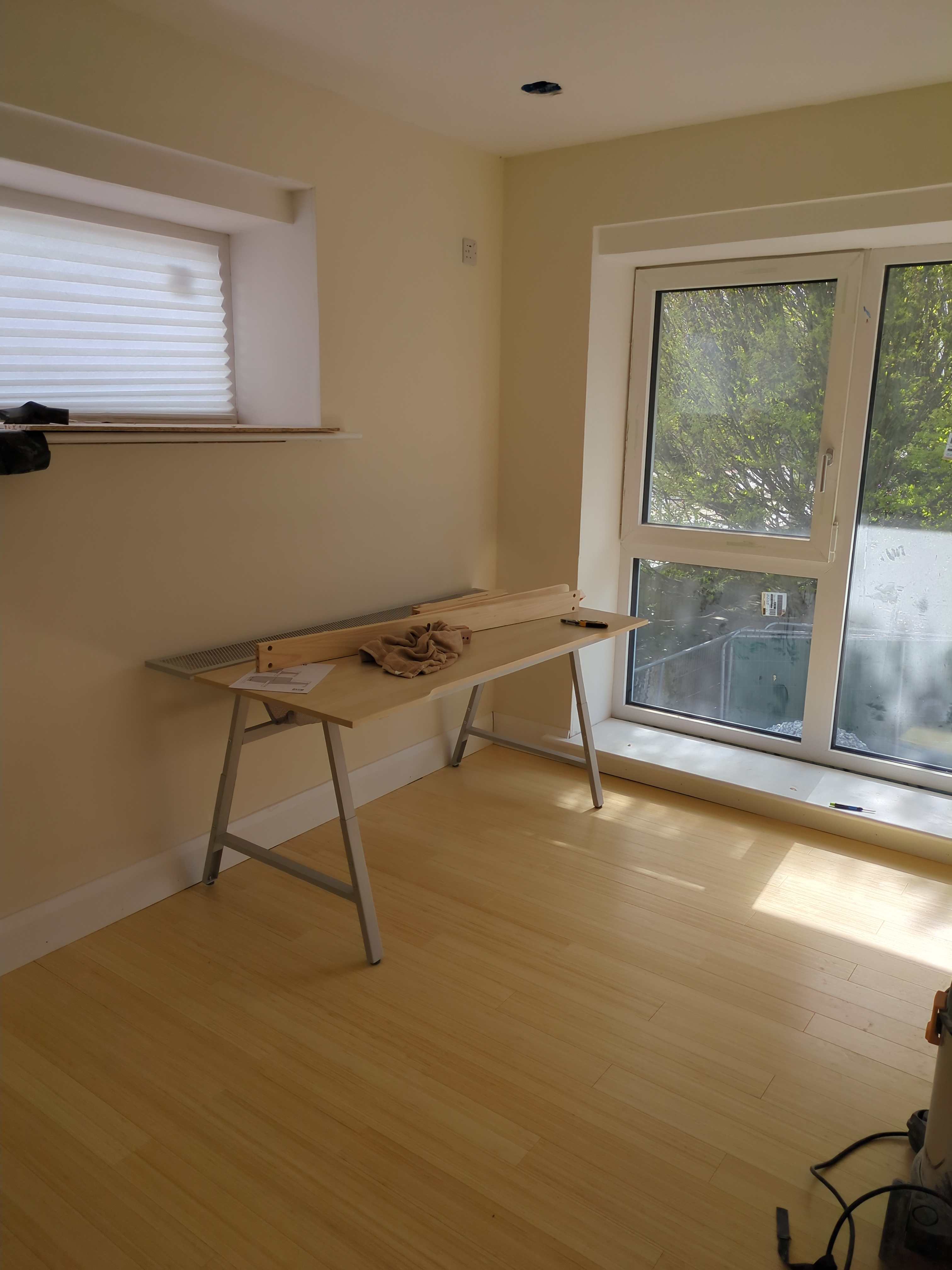

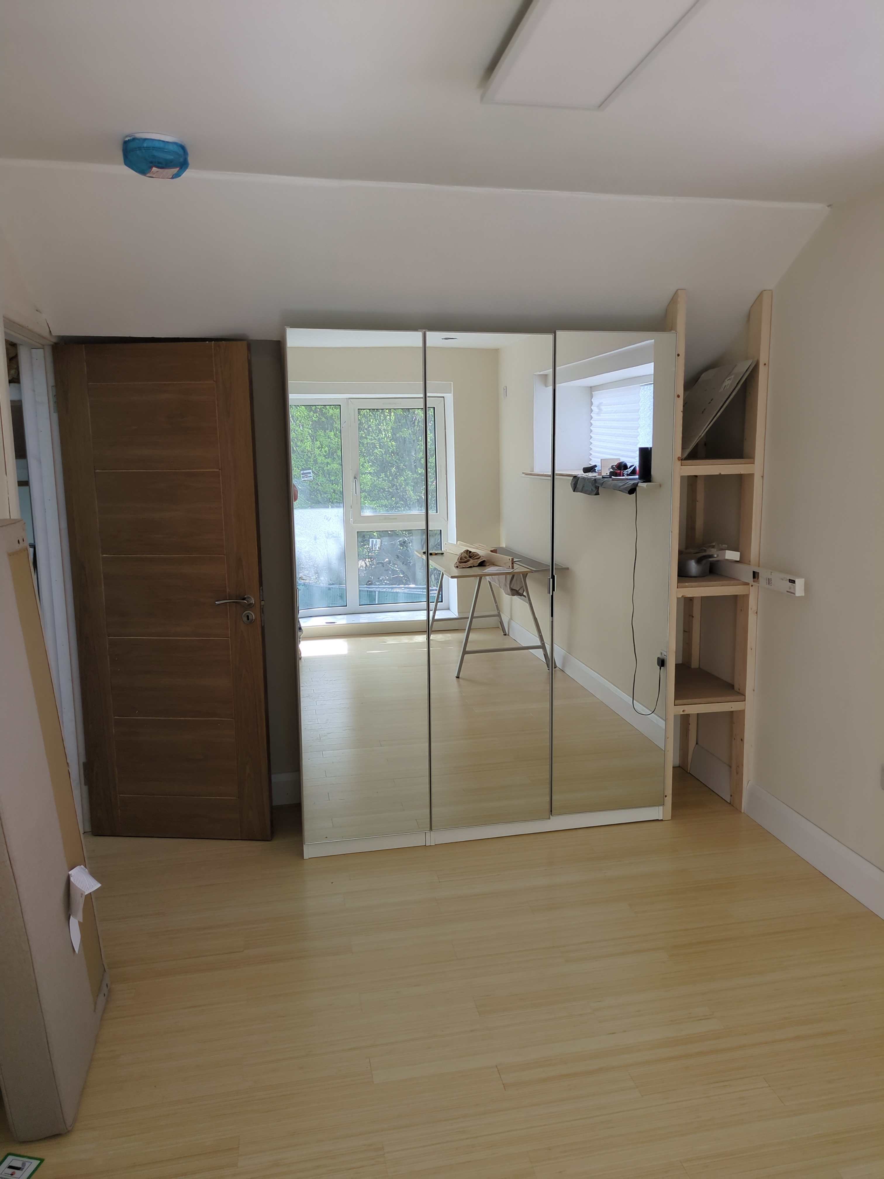

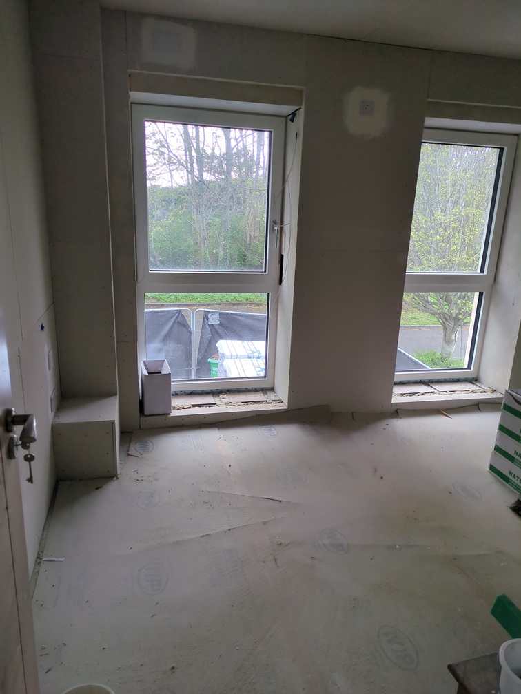

Have been working upstairs getting things finished. Currently have the stairwell, landing and office room completed and kitted out. Just starting the Master bedroom this week. Then it's off to the outside! I bought a pull out sofa bed, extra computer desk and some IKEA PAX wardrobes for the office room. There wasn't space for 4 Ikea units (500m wide each) so I put in 400mm wide shelving instead - I'll paint at some point. I forgot to level the sides of the double wardrobe before tacking on the back so while the sides are parallel, it's more like a parallelogram and one door is offline. Oh well!! That'll teach me to measure twice!! I'm gluing the bamboo floor upstairs also and Iove the look of it. I can now move into it as a full time office and save the space in my bedroom for the first time ever in nearly 30 years (i.e. no computer in my bedroom anymore!).

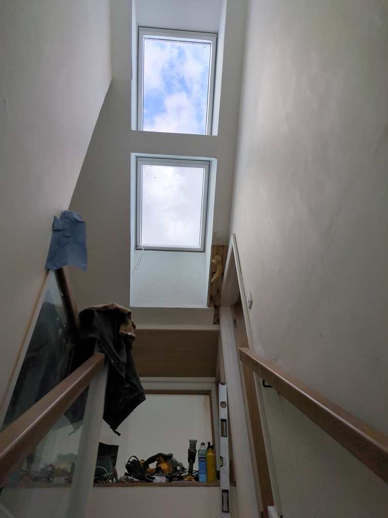

the two skylights at the top of the stairwell work well. I forgot to clean the upper window and take off the Velux protective tape before taking down the temporary platform and finish the sides. I won't tell you what I did with a ladder to fix this on all fours and ended up heading back to the Chiropractor the next day!!
The Master bedroom is a bit tighter but I measured it and think I have a bit of room to play around with 2.85m x 3.5m so a double bed and 500mm lockers either side still gives me a meter on one side or the other to add a dresser or something like that, fitted wardrobes over and around the bed and another at the end of the bed. How to fit a locker into an IKEA system? You can build in space with the PLATSA - I did a free design session with an IKEA rep who showed me how. I'll have to move the plug sockets up or they'll get buried but should be ok otherwise. I plan to fit a table above where the soil pipe boxing protrudes.

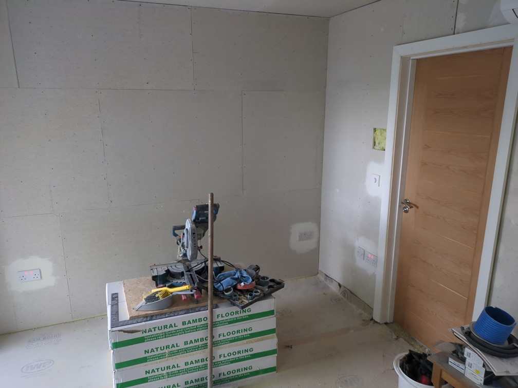

If you spotted a hole in the wall above the light socket, the door lining screw pierced the electrical wire at that location and all the lights upstairs went out!! Wago repair done. Electrician is out later this week so will have a word!!

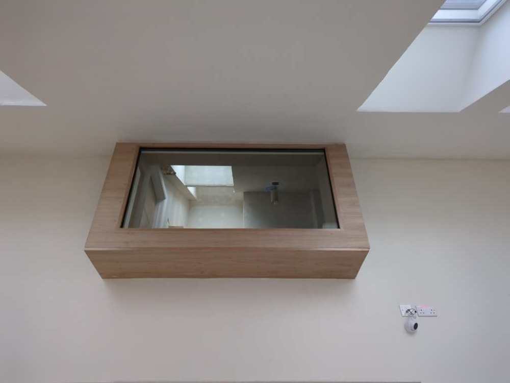

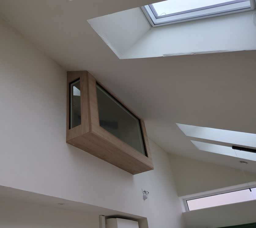

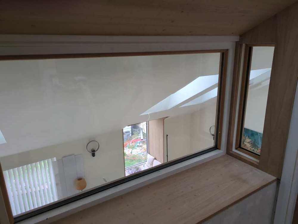

I finally got the glazing for the internal window installed. It's double glazed but with a large airgap for sound proofing. I did considered fire rating it but the price would have been crazy. It's comprised of: 6mm Toughened x 20mm black spacer x 6.4 Laminate for safety. The seat worked out well, just need a few cushions!!

Hi Mike, I just finished reading all your blog to date.  Thanks for writing it, I've found it really useful.
The IKEA wardrobes are not beyond redemption - you can push the backing off from inside so that the nail heads stick up a bit and then pull them out with a claw hammer.  Then get it square and renail. Having them squint like that would drive me nuts!
Can I ask a question about your wall finish?  You've done what I plan on doing and boarded it out yourself. Have you also done the taping/filling of the joins yourself and if so were you able to do that without sanding? Is there a final finish coat of plaster to go on top after that stage?  I hope you don't mind me pointing out that there's a couple of dodgy bits I can see in the plaster around your rooflight reveals - are these getting edged and skimmed later or have they been done but just got bashed during construction on site?

Thanks for the tip! Will get around to small snagging at some point!
I'm using Fermacell so after screwing that in place you use a joint filler for screw heads and gaps (I have straight edged boards, not tapered). Then you sand. Next is fine surface finish all over the board, then you sand again. Then you prime and paint. There are definitely areas for  improvement especially around the rooflights where I didn't get a perfect corner and I didn't use any profiles on the edges at all. I hope to return with joint filler and pack out these area, then sand and finish again at some point but it's "good enough" for now. Especially as the flaring and angles were challenging enough compared to walls / ceilings which had their own troubles!
I'd say any plasterer would be having a good laugh at my work (you should see my outside rendering at a distance!) but it's fine for now. There was plenty of bashing in addition, I dropped a 20kg board from the top of the stairwell and it broke 3 stair threads and dented the front door sidelight before it stopped!
So, my goal is to get all the big jobs finished, then start work outside and return to polish up the inside over the next year or two when I have the energy!!
Hope this helps!
