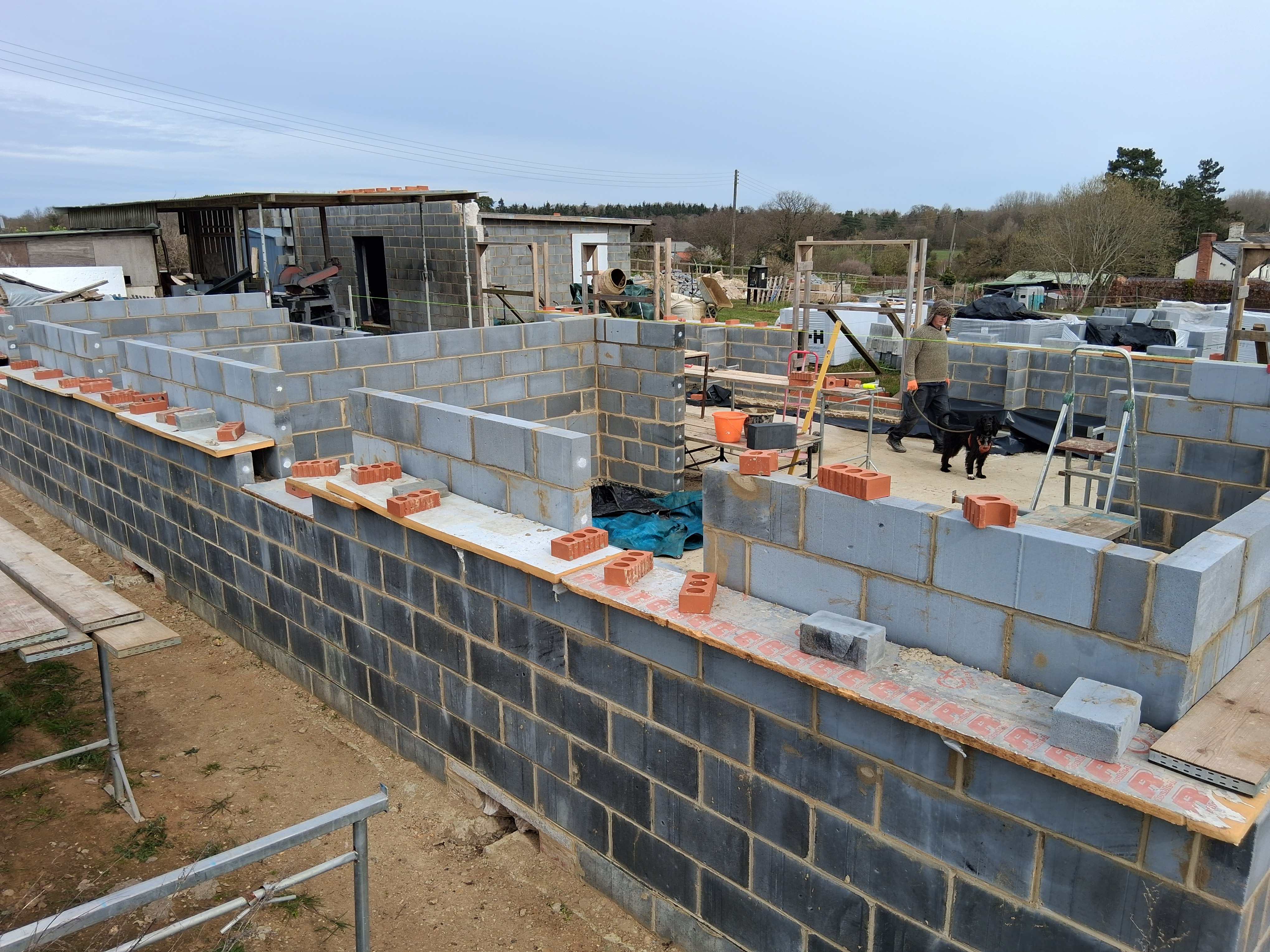

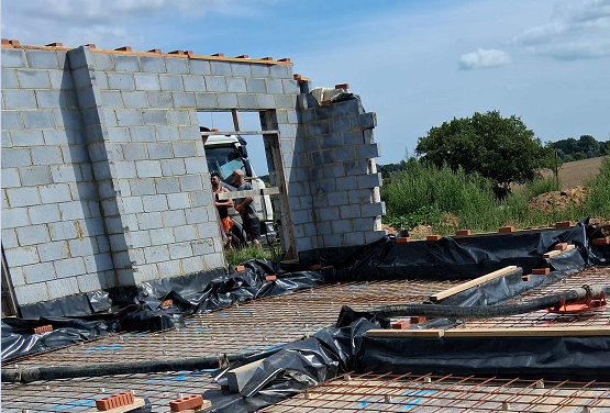

Since my last update last summer (remember that - heat) when it looked like this.
It now looks like this
We had a pretty major disaster last Autumn when a 70 mph storm came right over the field and a wall came tumbling down.
For context that's the wall by HID and dog.
To say that was a low point is a huge understatement.
Comments over the dinner table included knocking everything down and reinstating the stables.

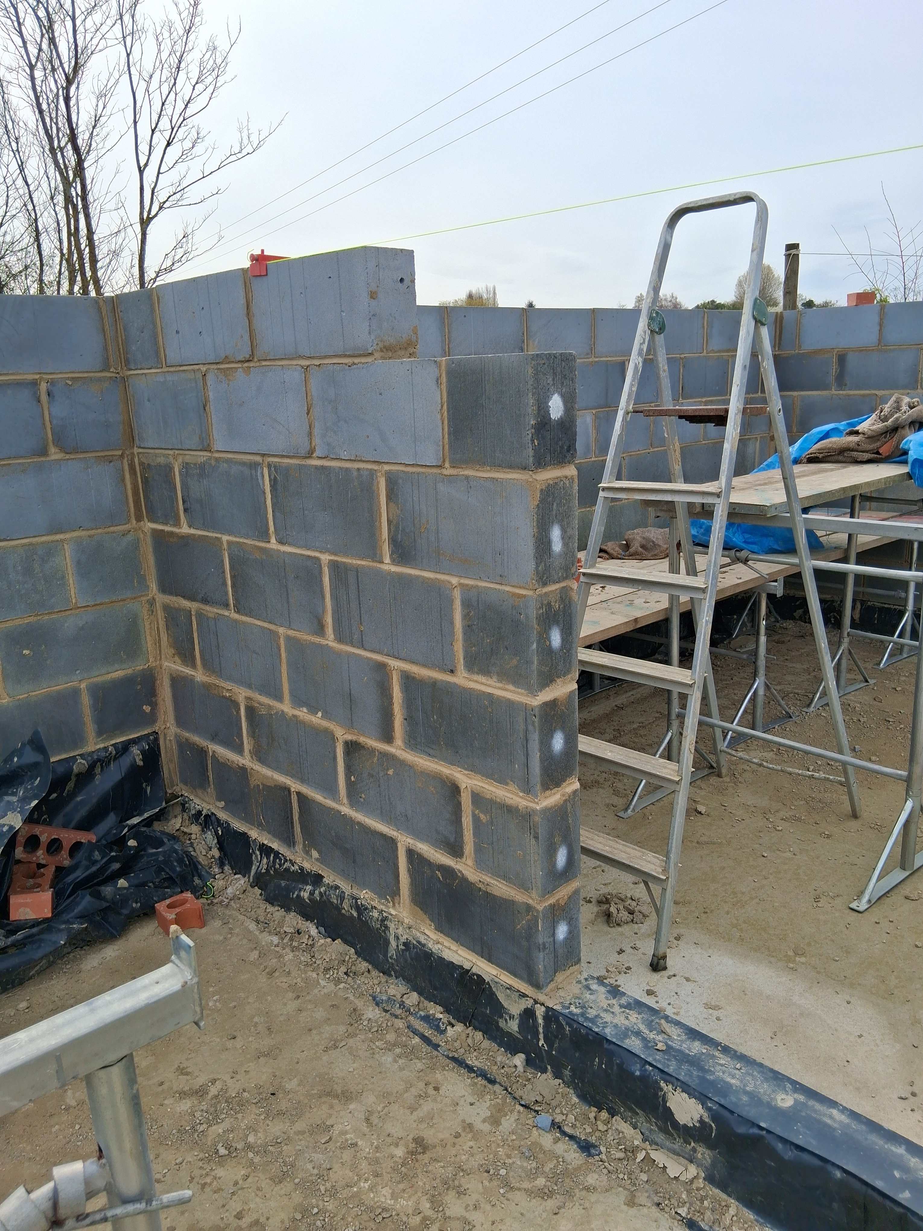

The corner was left but we just knocked that down as well and when it was rebuilt then we've only gone up to 5 blocks so it's not such a wind target.
Obviously, in hindsight we shouldn't have built one wall so high with no support and we are now going up one layer at a time all round.
This disaster also cost us lots in money as the 'wall' is now on the rubbish heap along with the lintels.
I've not got any photos after it fell as I was just too peed off.

To replace the look of the barn we have a sloping flat roof and this middle wall is going to hold the joists for each side.
These are 140 wide rather than 100.
We are looking forward to having the temp window and internal door frames in place soon as that will really start to look like a house.
We reckon that at our usual rate of progress that the walls will be up by end Sept.
As we want to put the whole roof on at the same time we are going to put up temp joists to ensure that all walls are held together.
Then we have a lot more concrete to break and the clay area to consider.
