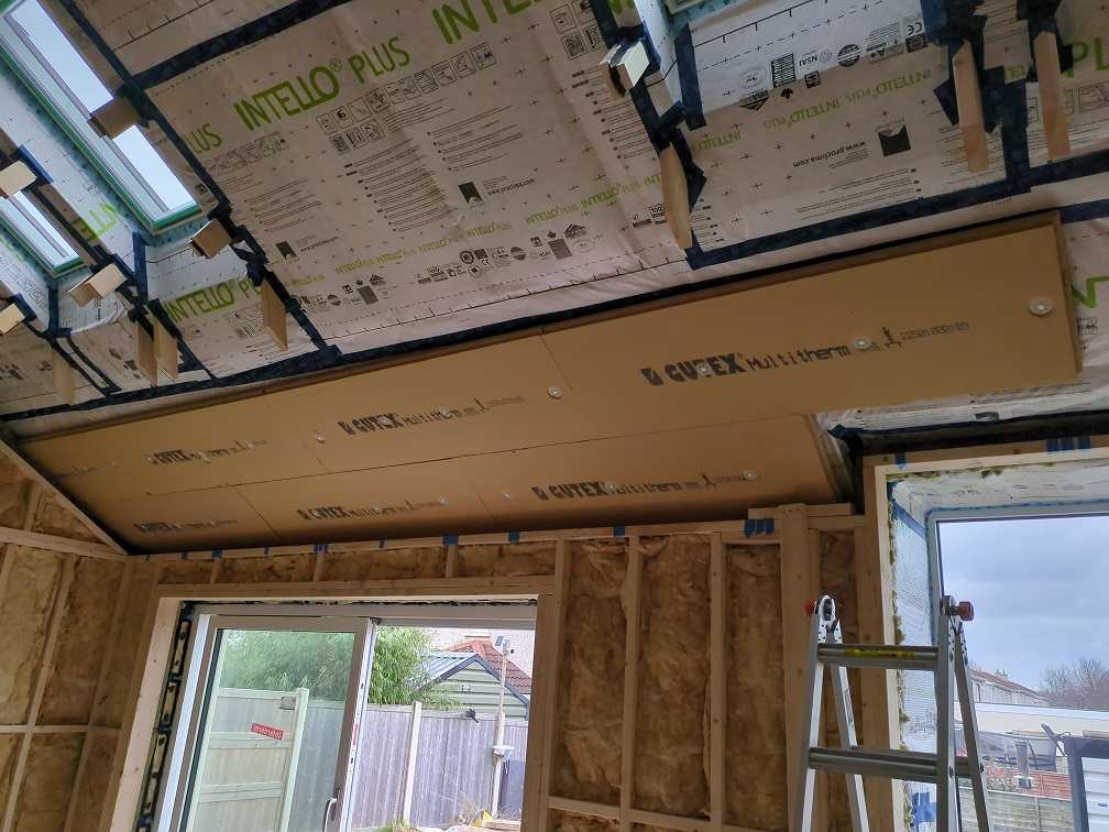

  • Insulation - started Gutex under roof install, walls 90% finished

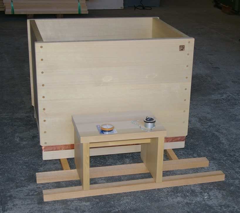

  • Japanese Bath arrived, looks very nice! Bought spa reheating setup and pump

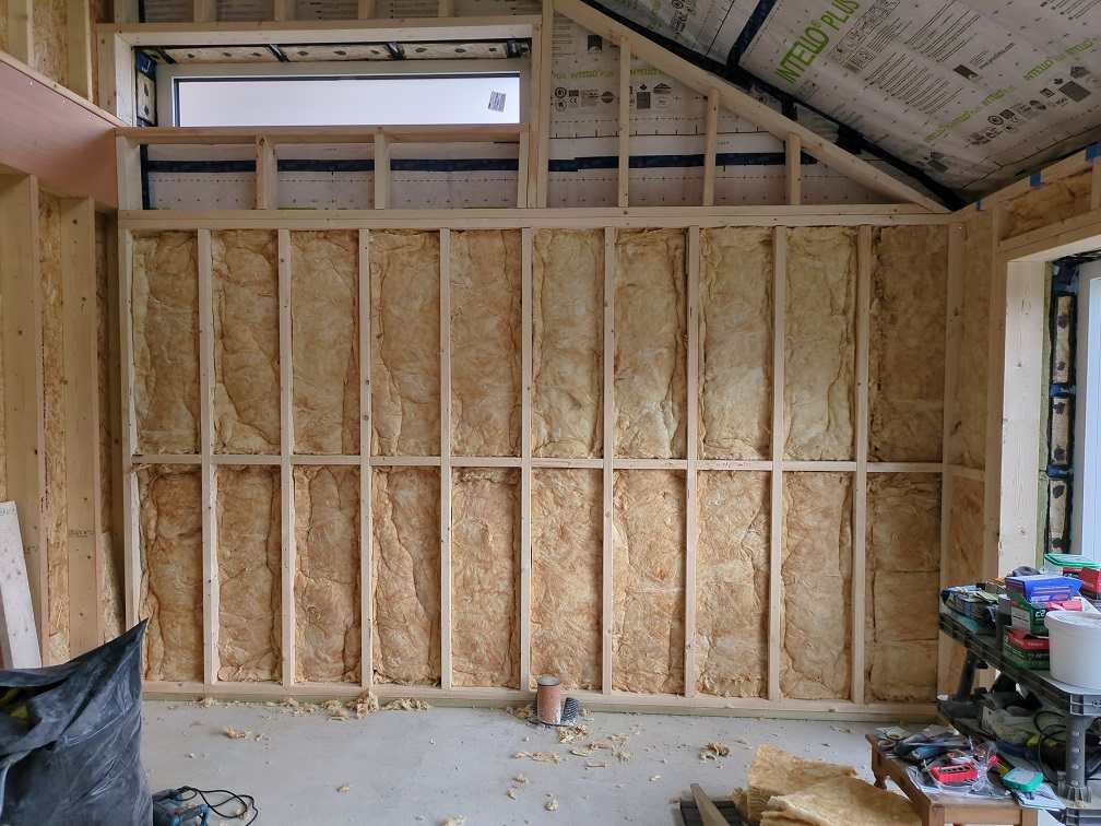

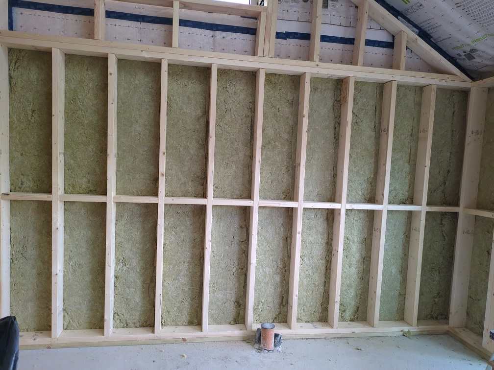

For the external walls (internal buildup) I'm using a 40mm gap and a further 2x6 wall inside. I fill the gap with 50mm rockwool as a thermal break (220mm timber frame) and then add 100mm Moy Metac to hit my U values. I've to use Gutex under the roof in a 60+80mm offset layer with ejot screws & washers and then a 2x4 stud to hold it all in place. Both setups give me a 40-45mm service cavity although the 92mm MVHR pipes will need more carving out of the Gutex when they are installed.

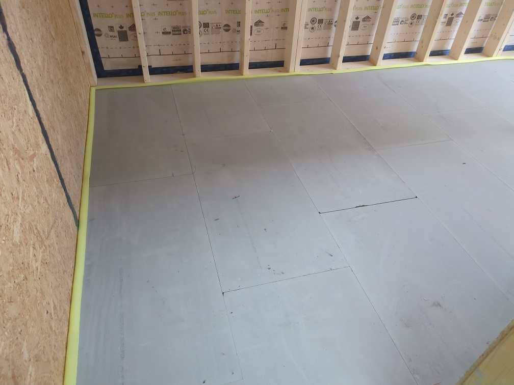

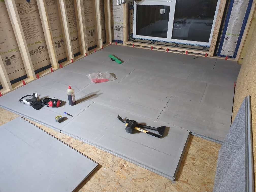

I installed Cellecta Screedboard 28 upstairs to provide soundproofing on the floor. You glue these together and leave a 12mm gap around the room edges for some yellow foam they provide. I ran out of boards and had to get some other boards (5) for the landing as I'd miscalculated and they only ship pallets. I also left a 925mm square gap for the ensuite shower. The boards are heavy (18kg each) - I had 42 of them but needed another 5 for the 33m2 area I wanted to cover. I might still add sound insulation between the Pozi joists but for now, I'm happy!

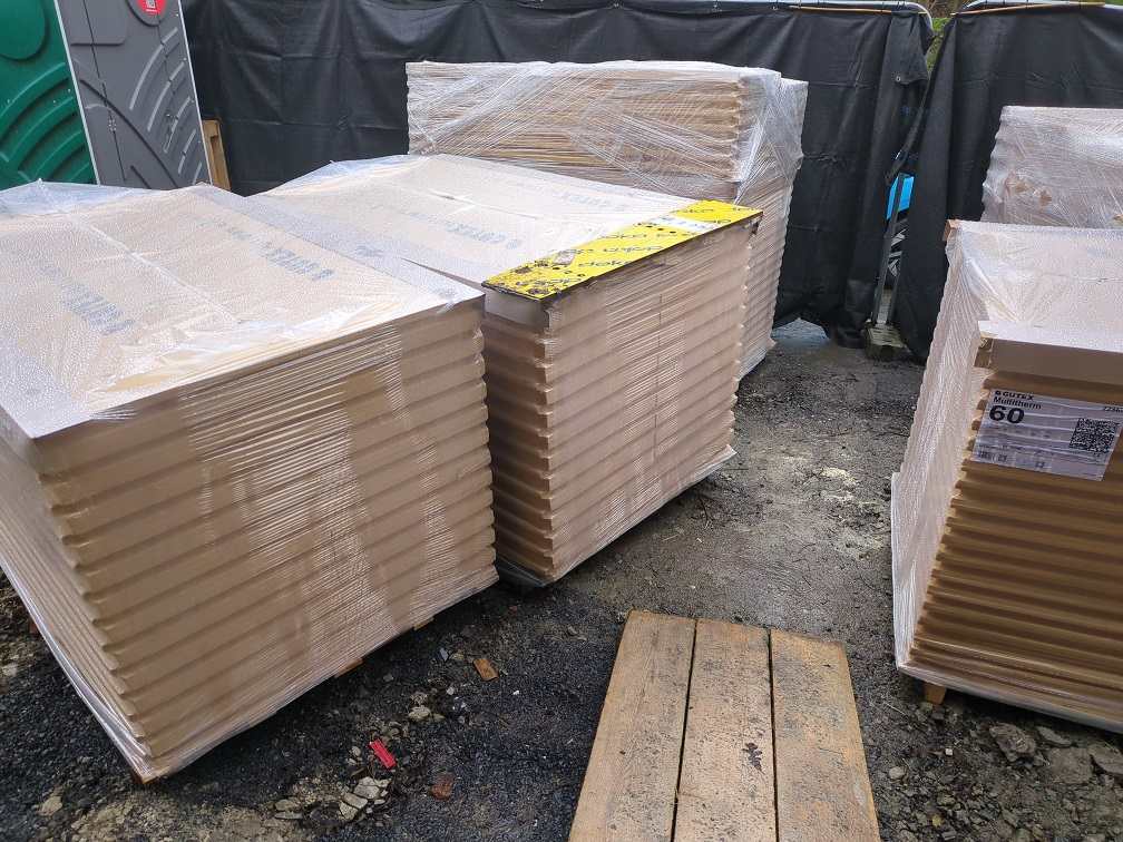

So, about to start first fix and have a lot of stuff on order / about to order to get me through that. Am choosing Fermacell but can get 2500x600 sizes locally.
