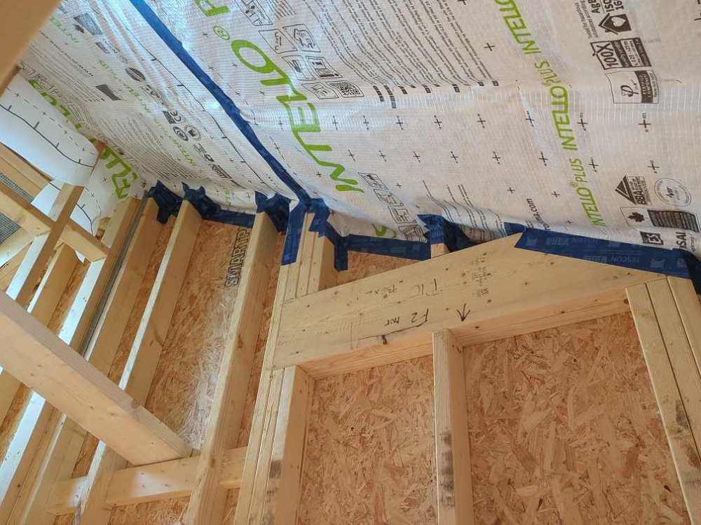

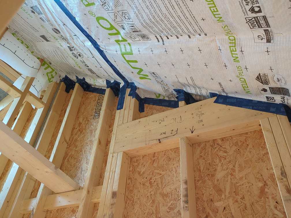

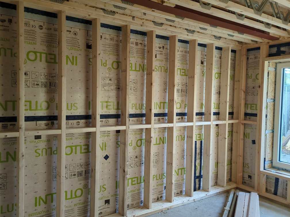

I've been out with my back for a bit but now taking Pilates classes and everything feels fine so far. Been crawling around the new attic and installing the Intello membrane and taping for air tightness lying down and in difficult positions without issue. Phew!! I've put a call into the Plumber for first fix and will see when they are next available in 2025. Once they are available I'll book the Electrician.
Updates are as follows:

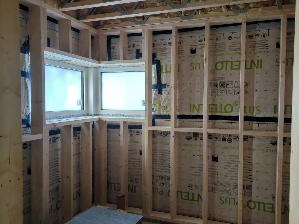

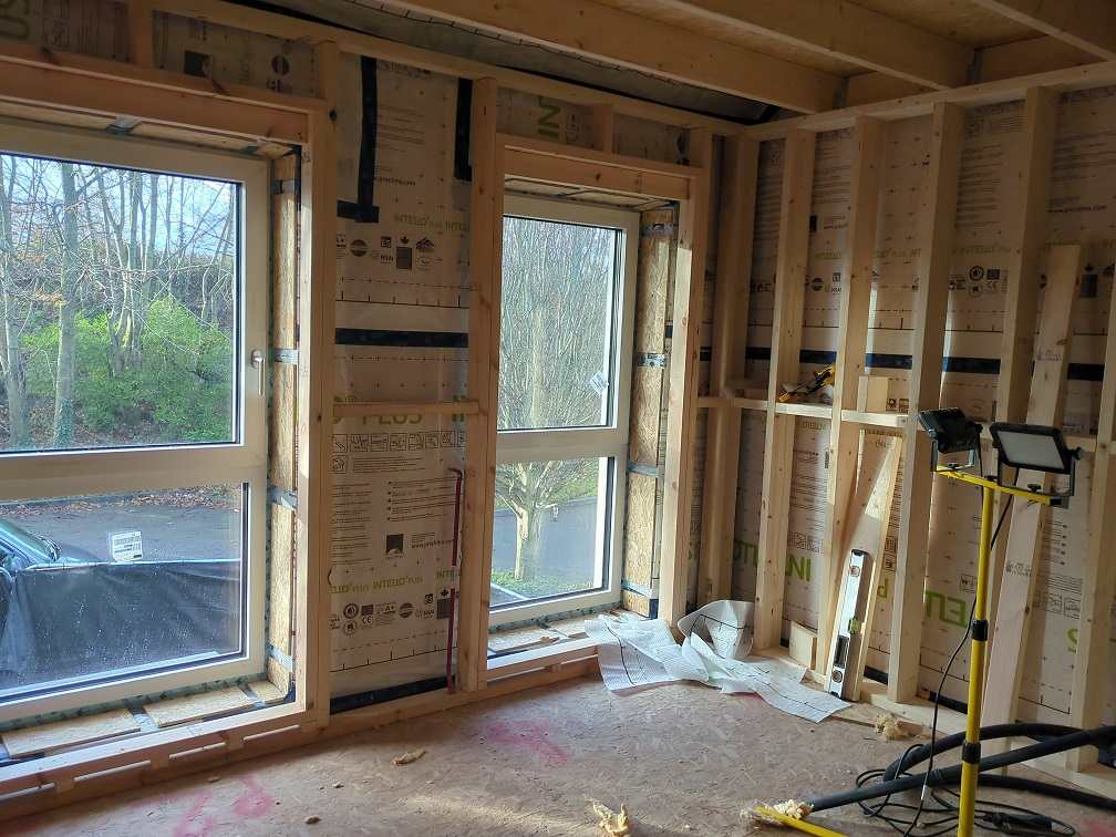

  • Interior stud work for outside walls nearly completed except for open plan area. This is provide additional space for more insulation and a service cavity.

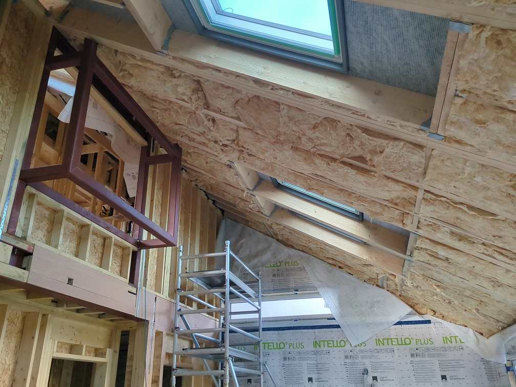

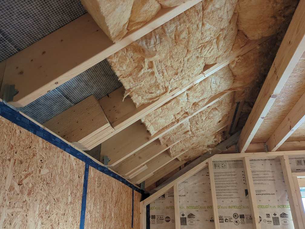

  • 95% of Moy Metac insulation fitted, hope to complete today except for specialized areas (Velux and Oriel Window)
  • 95% of air tightness taping completed except for door thresholds and and Velux/Oriel areas. I've used up my extra rolls of Tescon Vana tape and did a quick run to pick up more from ecological before they shut for Xmas. Needed 2 more rolls, so got 3 !! Very few places stock it and usually I get it delivered but I plan on working on the house over Xmas and needed to have it on hand or I'd have to wait until 2025 to get more!
  • There are some trickier areas to get airtight where studs protrude / the roof intersects, I'm just taping the hell out of it! And using other sealing products to help.
  • The place is a lot quieter with the insulation in place and even though its 3oC outside, the attic work was comfortable as the heat from my efforts is being retained up there! Helps a lot but when I take a break and sit downstairs it gets cold fast and I can see my breath!!
  • Thinking about the outside drainage and have a shopping list as not heard back from groundworker so if I have to do this solo wanted to figure out what I'd need. Tempted to buy now but need to stop distracting myself and work out exact quantities of internal products needed to finish insulation, plasterboarding and to fit out bathrooms
  • I'm the proud owner of three toilets, a wall hung cabinet with sink, tap and led mirror. First time buying any of those! The plan is to get a working bathroom up by Spring so I can ditch the Tufloo outside! I can flush by bucket!
So, what a 2024! Slower than I expected but I'm nearly ready for 1st fix and when the trades get onsite they won't hang around. I found an excellent bathroom outfit who can provide a tiler and everything I'm looking for and are local. I plan to let them tackle the main bathroom and all the tiling but may do some of the ensuites myself if I feel up to it! I've used 53 rolls of Moy Metac so far and am the owner of a wide array of power tools. Am proficient in working without main electricity and just off battery power only most evenings (No temp supplies allowed where I am). All the evening work has added up nicely!
