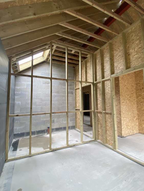

Week 9 and 10 Roof OSB and internal walls
Week 9 and 10

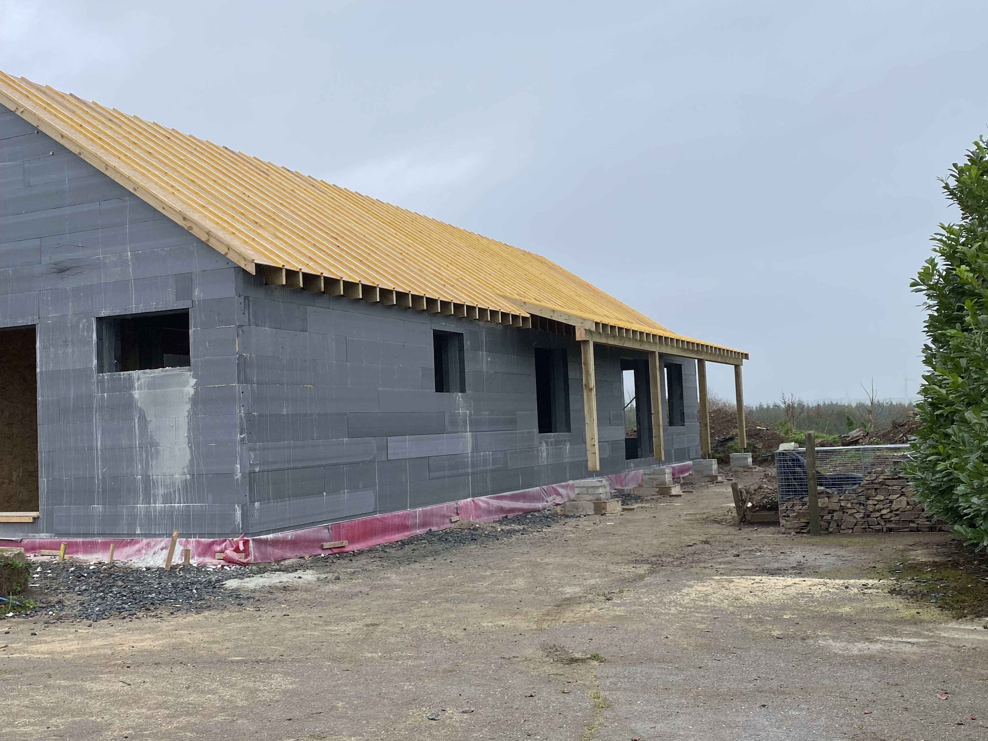

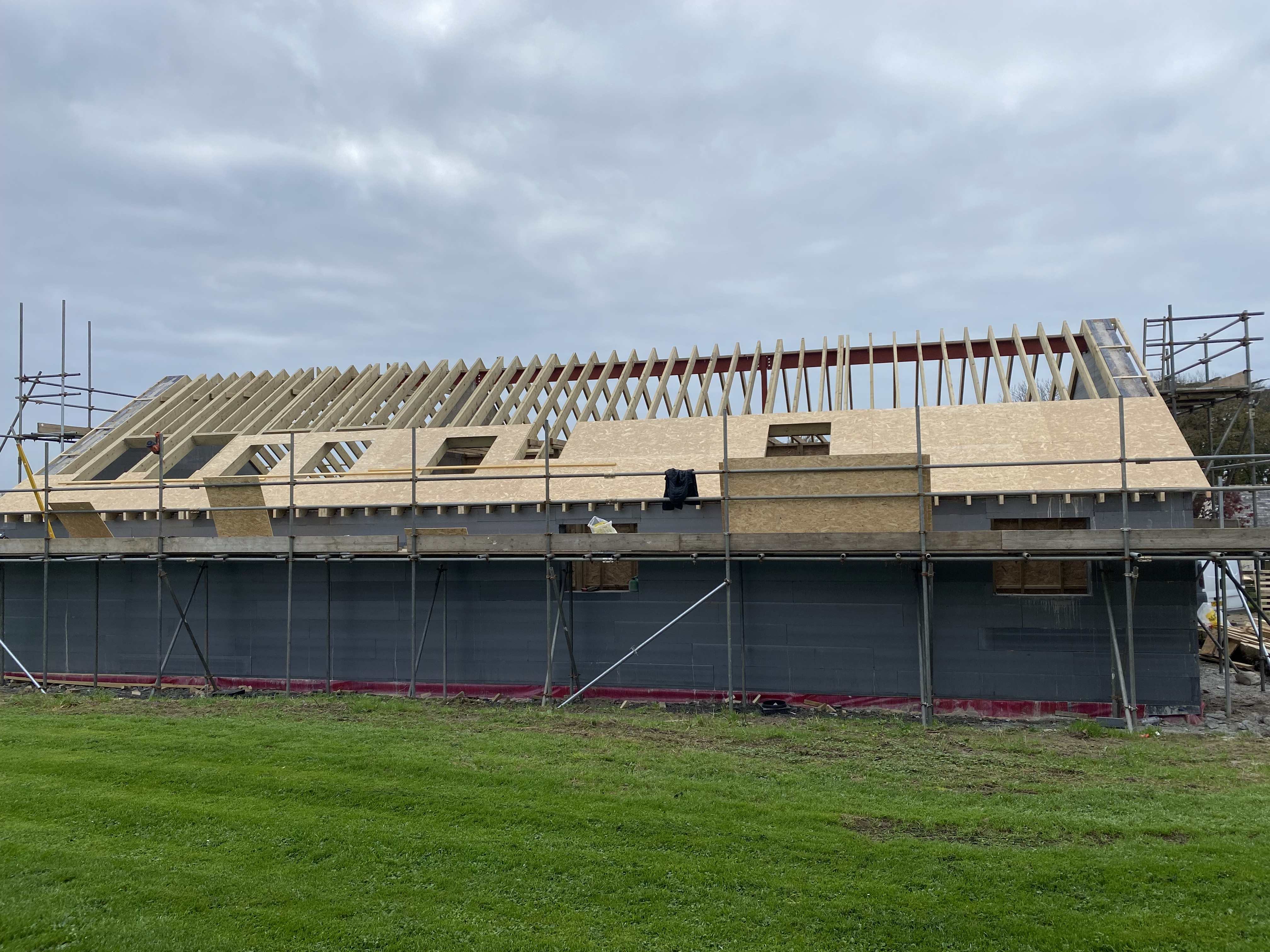

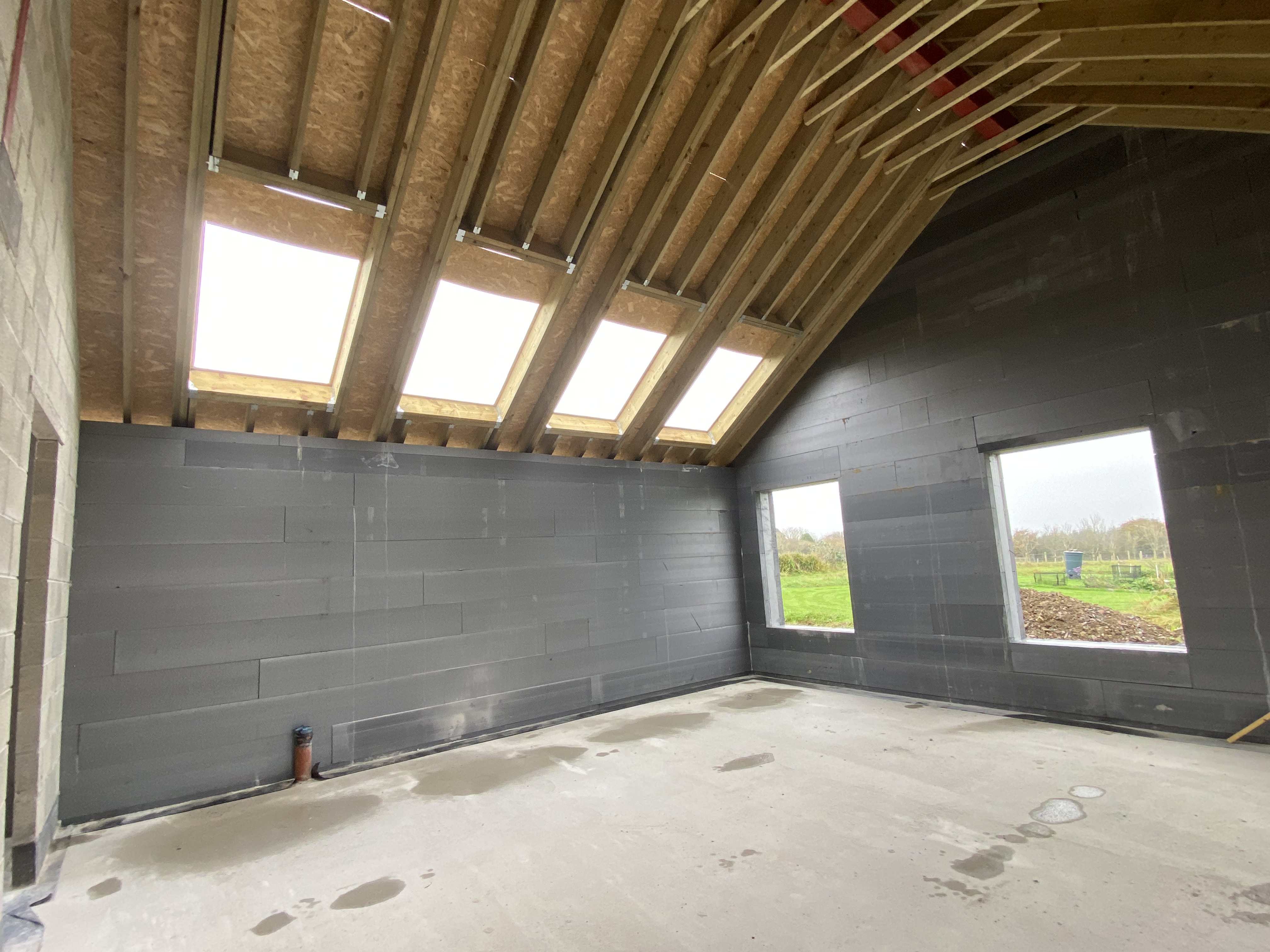

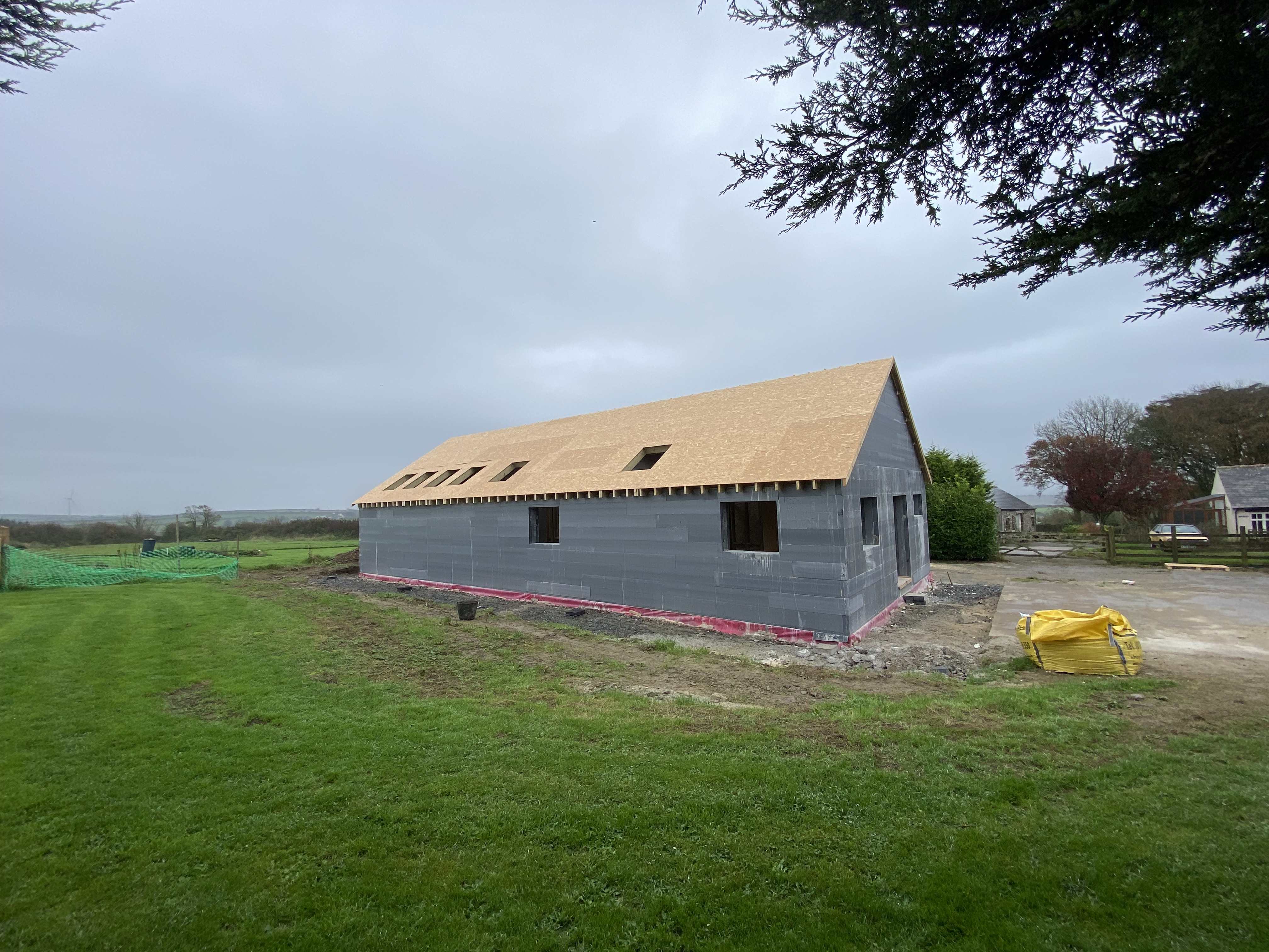

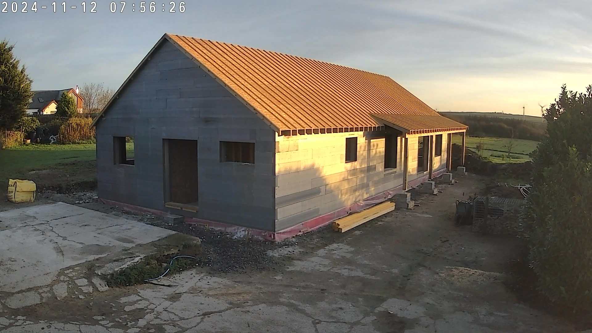

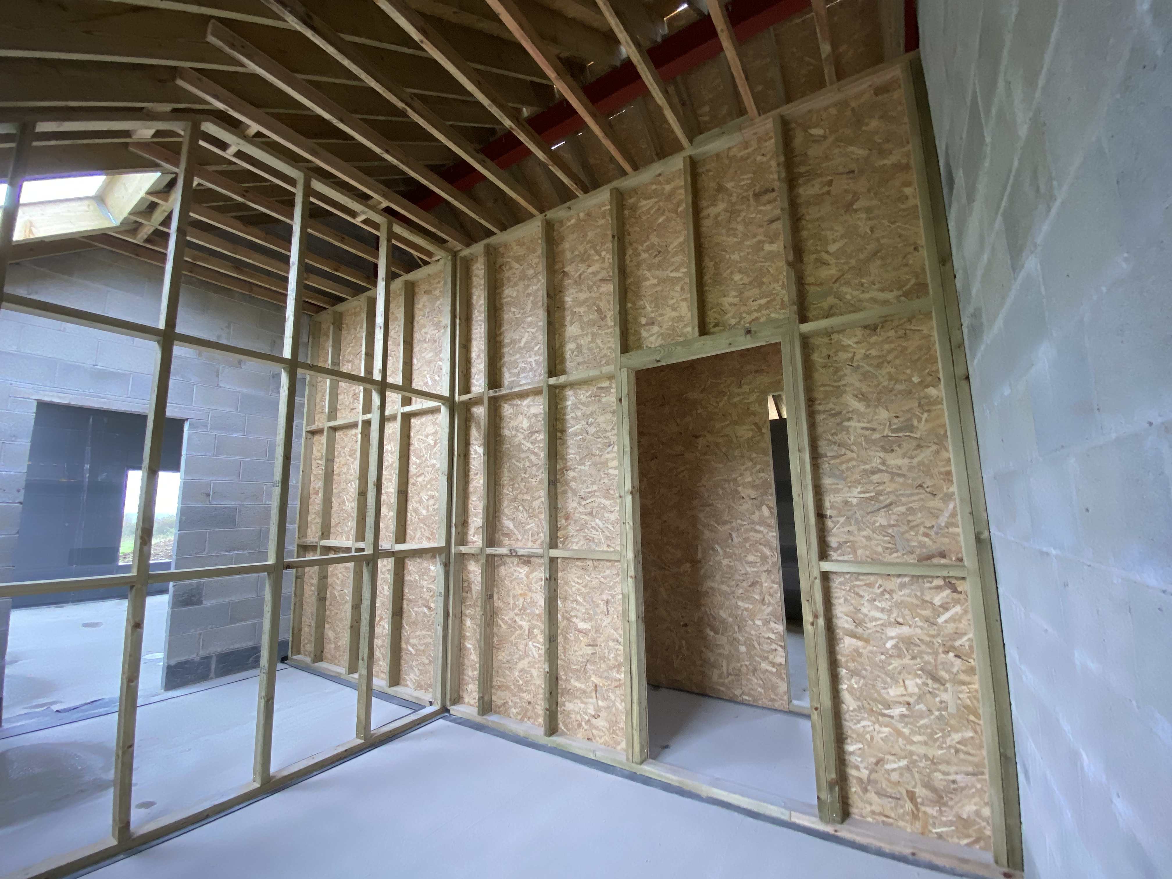

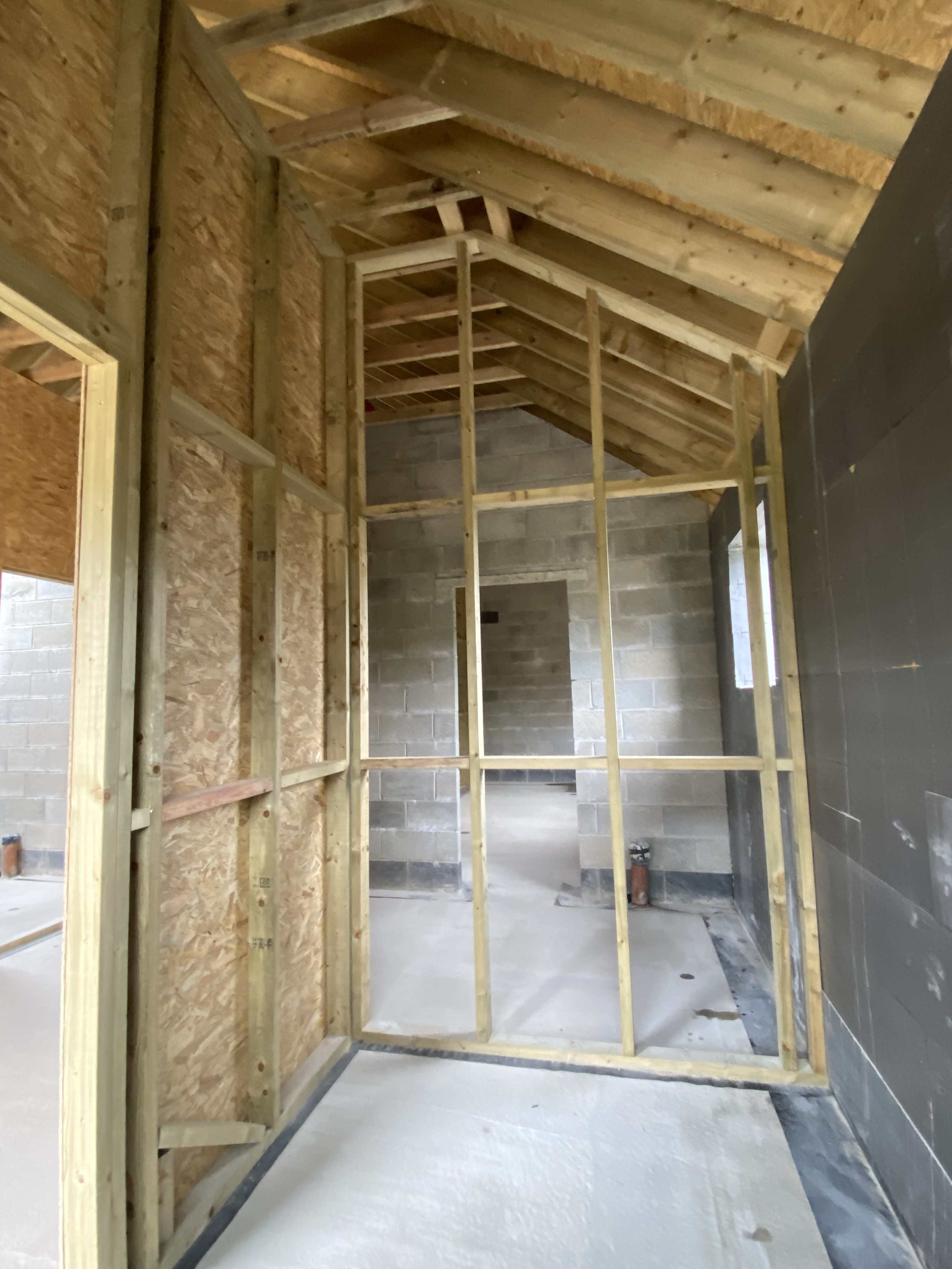

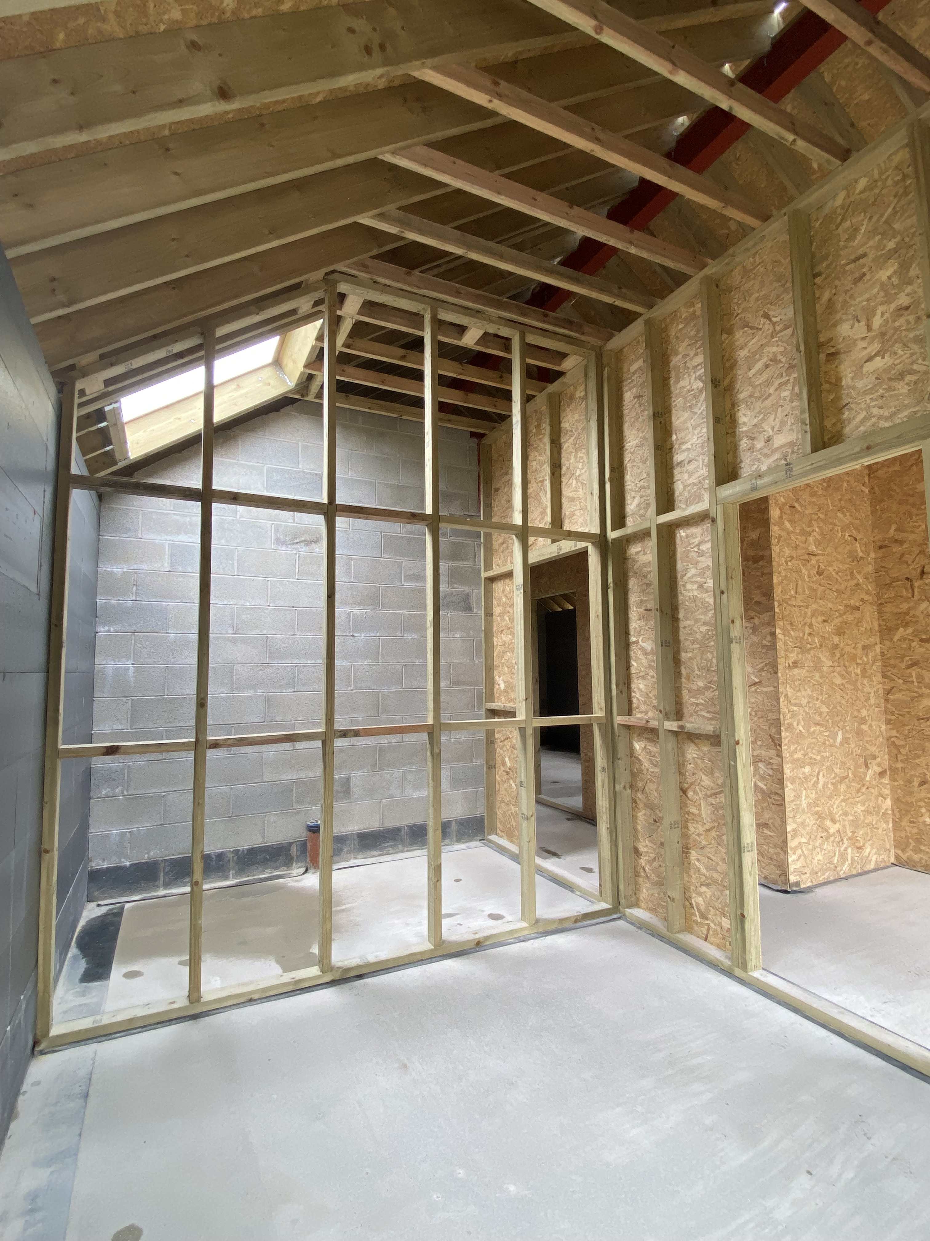

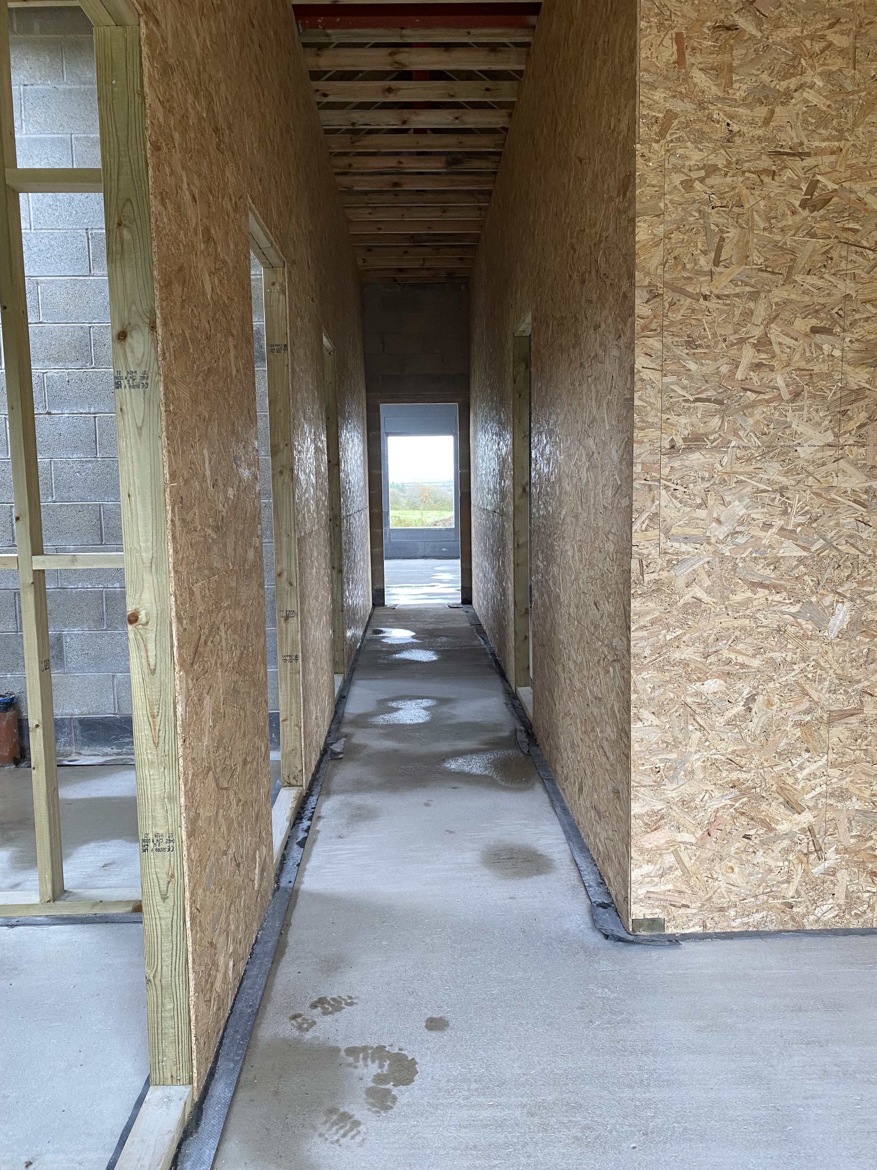

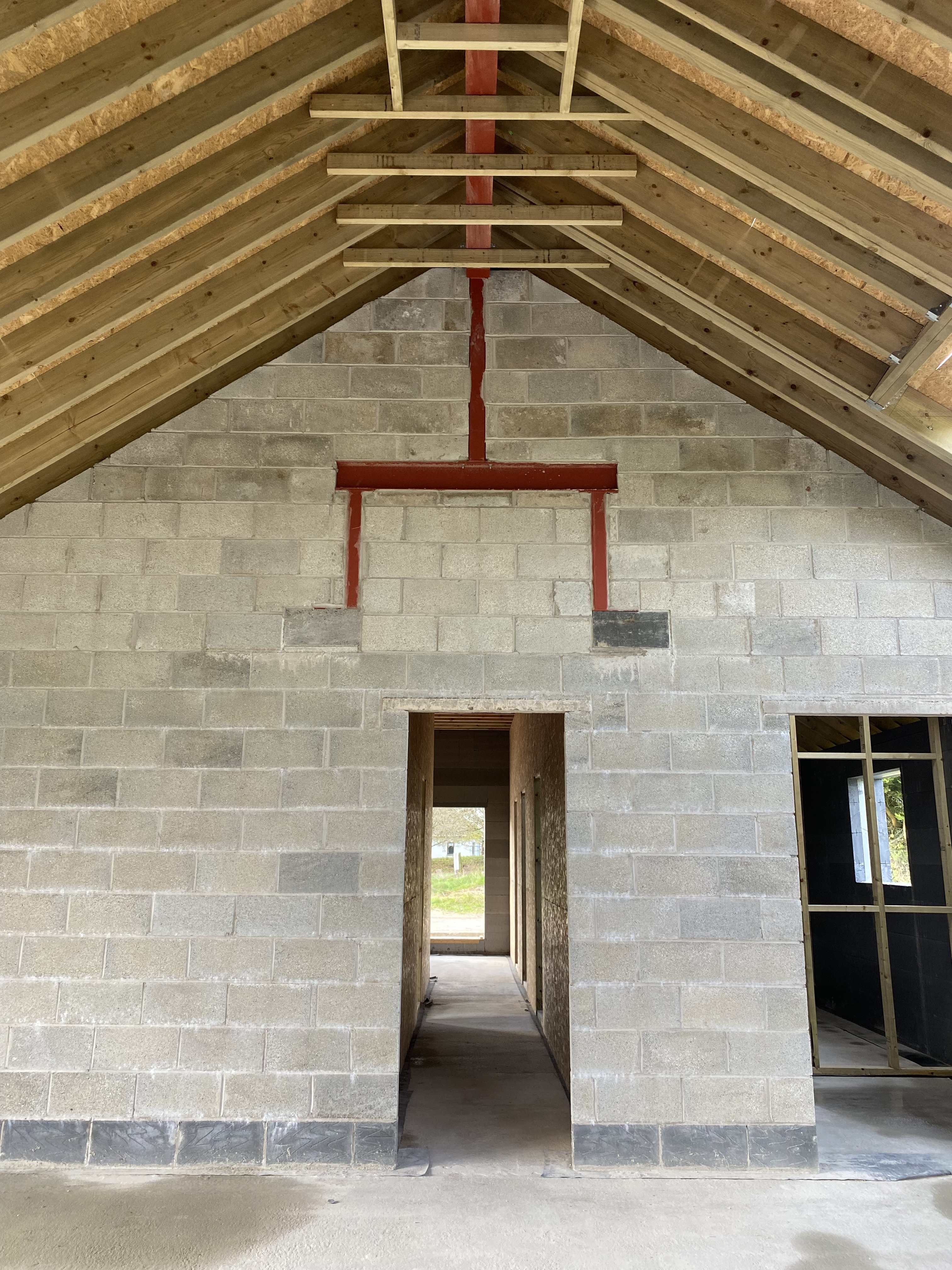

The gable ladder is up, and the OSB 3 is installed over the rafters.

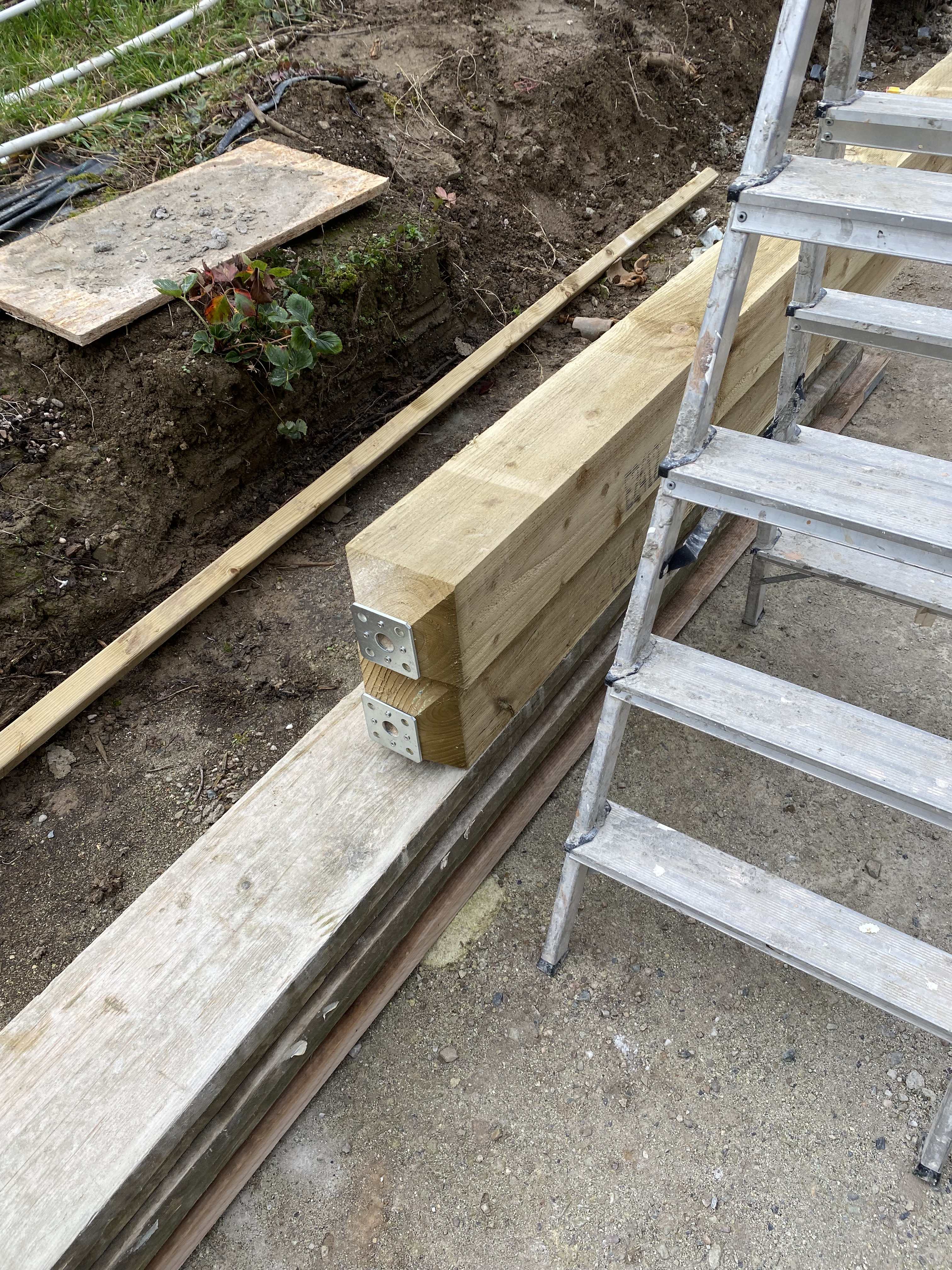

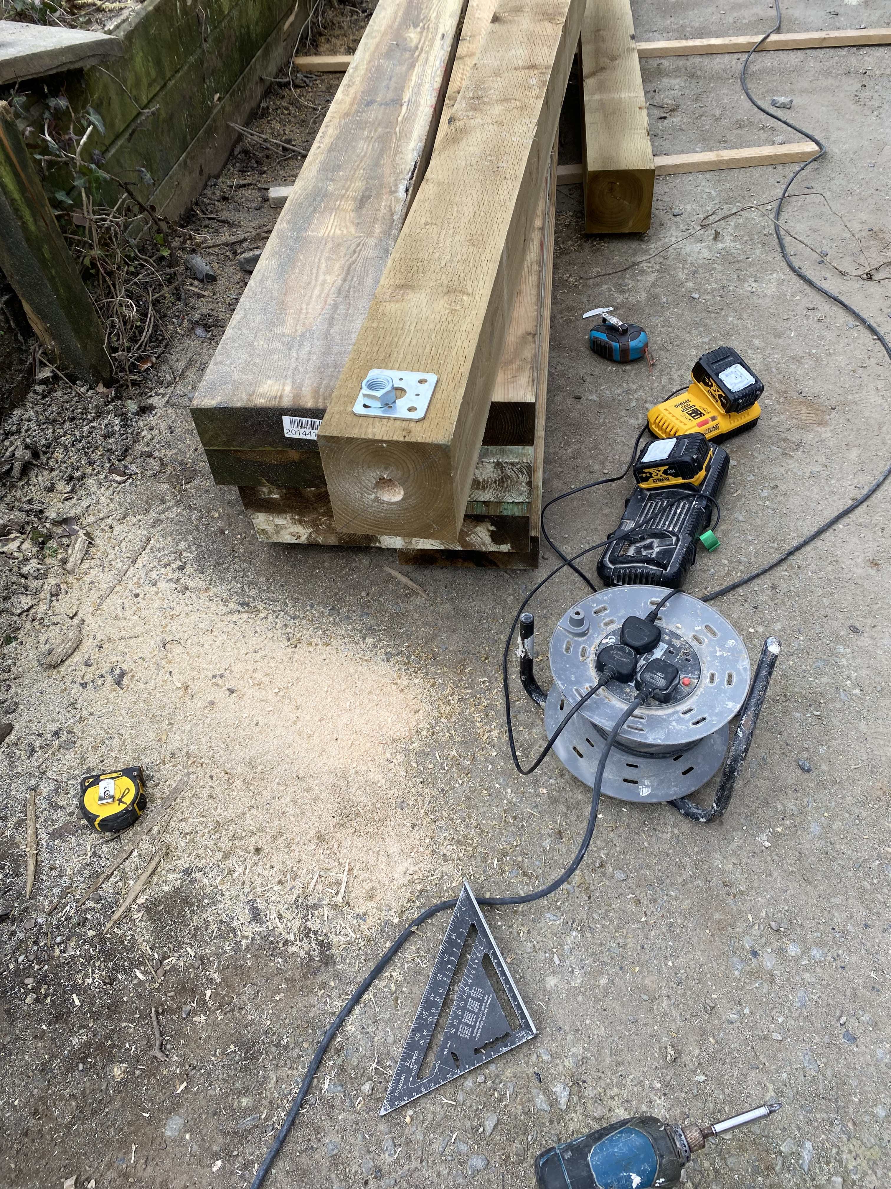

The overhang supports are shaped for the secure attachments and put up. The South side of the roof gets its cross batten. The scaffolding comes down, unfortunately due to miscommunication between the director of the company in the office and the director working on site the scaffolding comes down before the North side gets battened.  The builder has given us the materials and refunded us an amount for the labour.

IMG_2607.thumb.jpeg.bf752b34ee43c806432c13cfda66c9a6.jpegIMG_2609.thumb.jpeg.f3dc345fb430dcf9f07efc436b7ec421.jpegIMG_2632.thumb.jpeg.e320a1876c54d0acf42a118142bbbb8c.jpegIMG_2633.thumb.jpeg.0d855867120dade66b7bd51ebdb72908.jpegIMG_2659.thumb.jpeg.7c48f98ec8b397a1222d5f08923d6625.jpegIMG_2672.thumb.jpeg.0f592c7411f591319d2135dd4a4949b6.jpegIMG_2637.thumb.jpeg.a4f314977cc687917f60a889280ce1e1.jpegIMG_2642.thumb.jpeg.b0ccffbde39963944f2207bed14dae51.jpeg
IMG_2606.thumb.jpeg.dc3bde8dad0085d9eb86f30d0922ca06.jpegIMG_2630.thumb.jpeg.1e333094000a149b6116f42c52daf61a.jpegIMG_2646.thumb.jpeg.ce8398094763a8a634719a1a42927a2c.jpeg5CE93118C029_20241112075627684.thumb.jpeg.1d70d09615df51c5570083b92435f09d.jpeg
