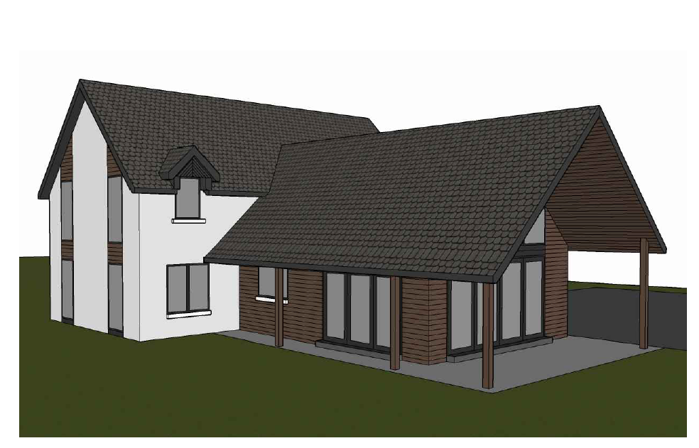

It's a SIPS build with an Insulated foundation system, MVHR, UFH, ASHP. Aiming for high levels of airtightness and all the good things that go with it, however not passive standard.

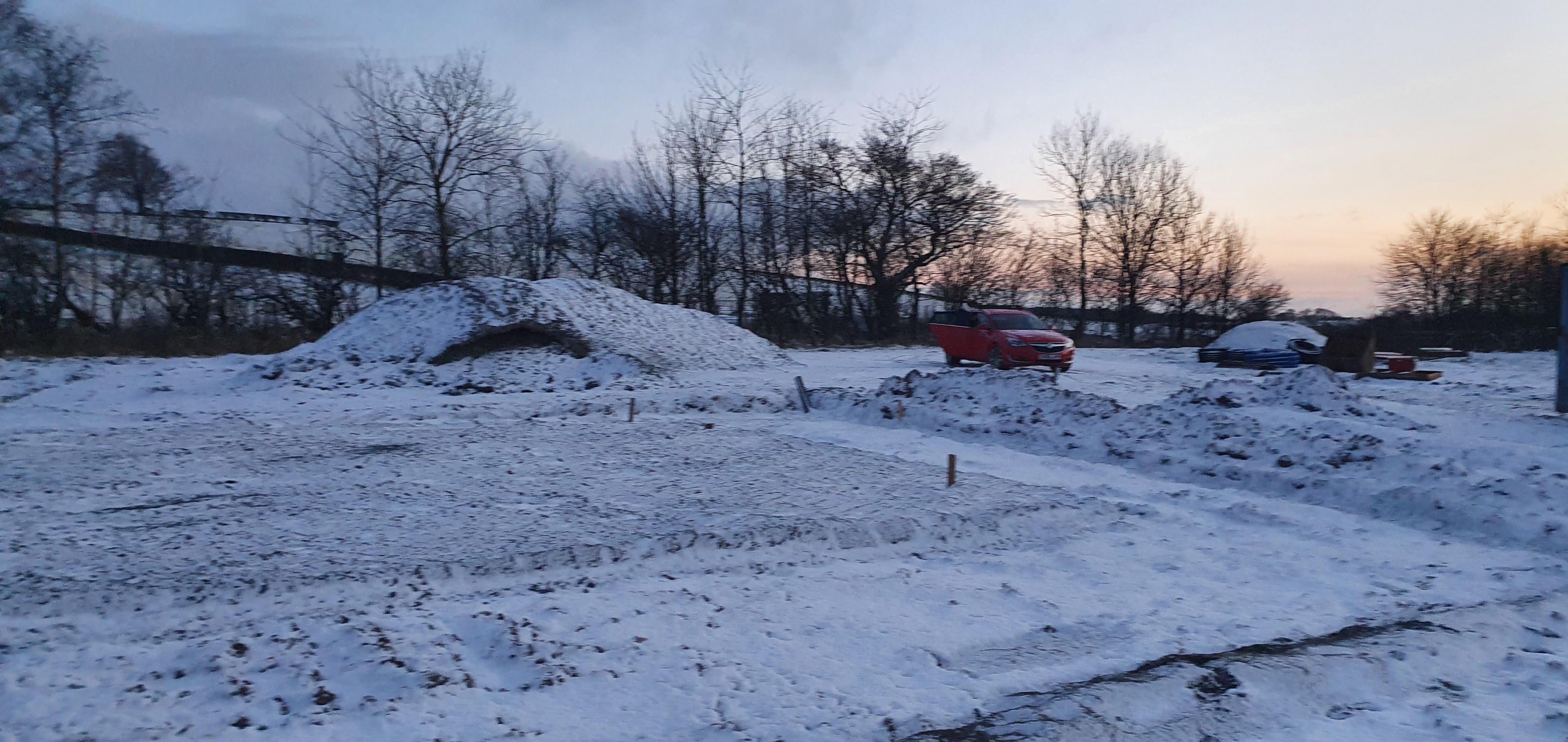

Foundations - Stage 1 - Nothing but Snow and ICE
Well, a few weeks have passed since my last past.   We finished up the road and last post we had scrapped back the house footprint. I feel like we haven't come that far since then, but in reality we probably have actually now that I look at the pictures.    Once we had scrapped back the top and subsoil we got the levels down to where I thought we should be. The house was meant to have FFL of 138.5m (referenced to sea level of course!) but I increased the height by 0.75m. It w
