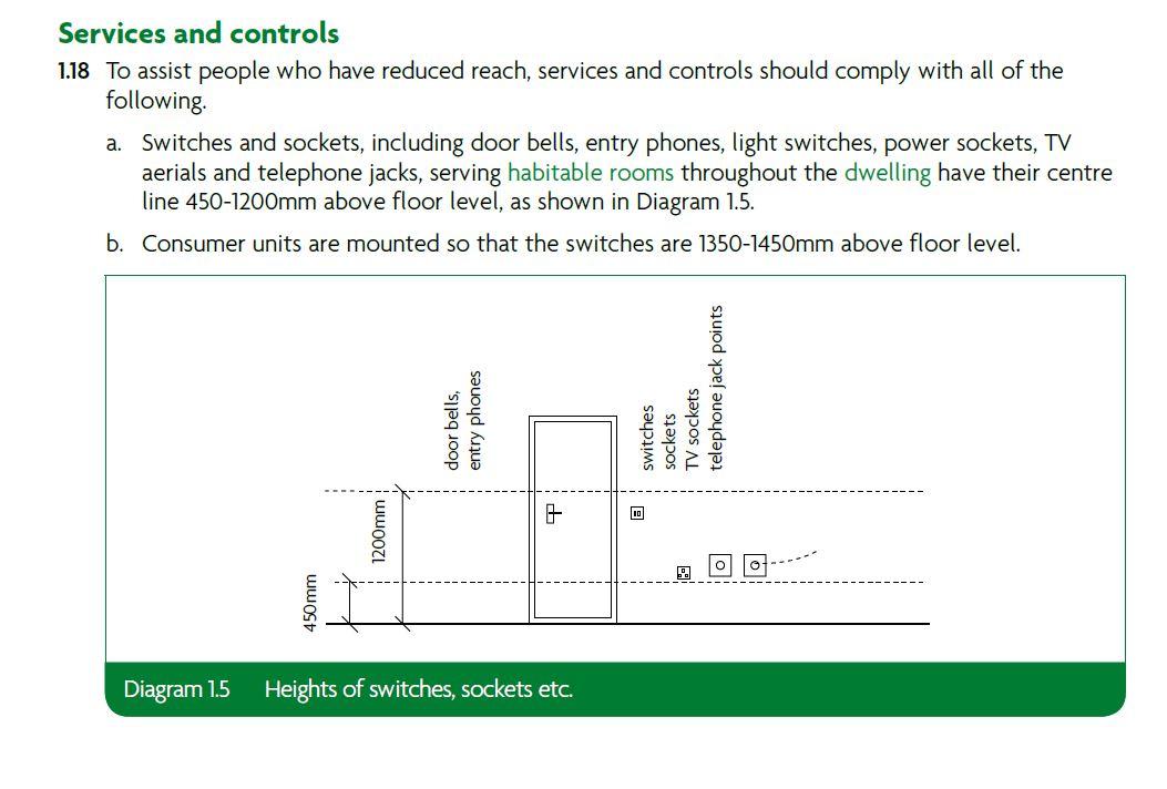

Has anyone adhered to the Part M requirements for their outside sockets? Could a jobs worth BC inspector argue that a patio area is deemed to be a habitable room?!
No need for Part M compliance for outside sockets as far as I'm aware.  None of mine are Part M compliant (they are all too high) and neither the electrician or building inspector batted an eyelid.
