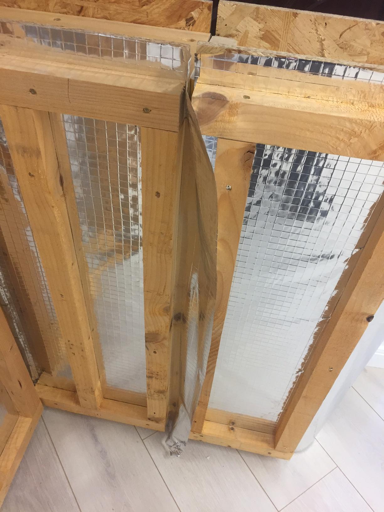

I went to see a Timberframe supplier recently and this is an sample of their closed panel.
They factory fit the interior VCL and service battens, the battens where the VCL from one panel joins to another panel would be left off or be loose. In terms of air lightness would it be better to attach the foil VCL once the panels has been erected on site?
