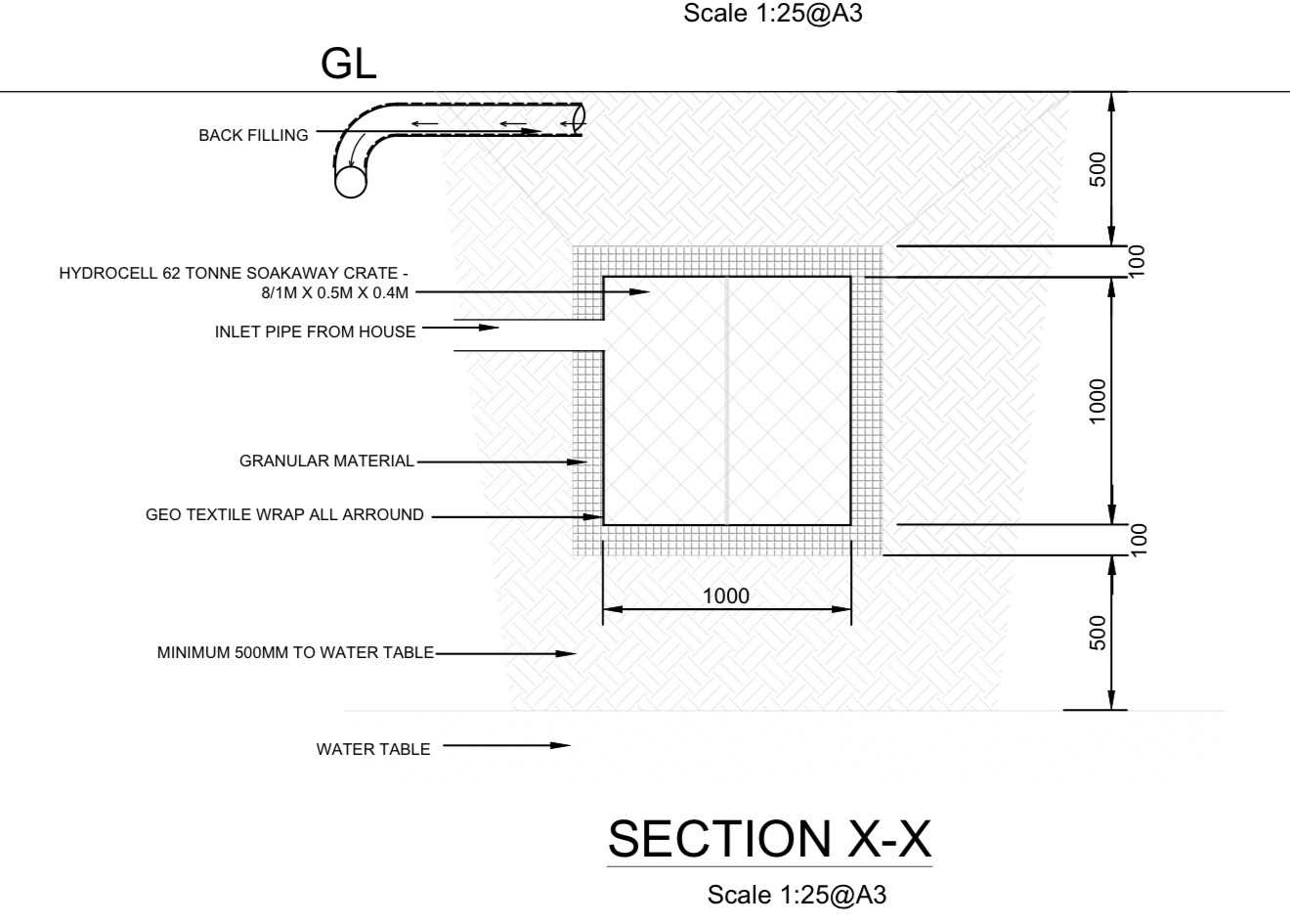

i need to do a percolation test to satisfy building control my soakaway design is large enough.
my inlet pipe is going to be approx 800mm below ground level (image attached)
so if I dig 1000 deep and 0.30mm x 0.30mm
and measure the rate of drainage from 750mm down to 250mm
just checking I have the calculation correct so hypothetically it takes 120 seconds to drain
Calc for VP value will be 120\500mm =50
and repeat 3 times per trial hole?
