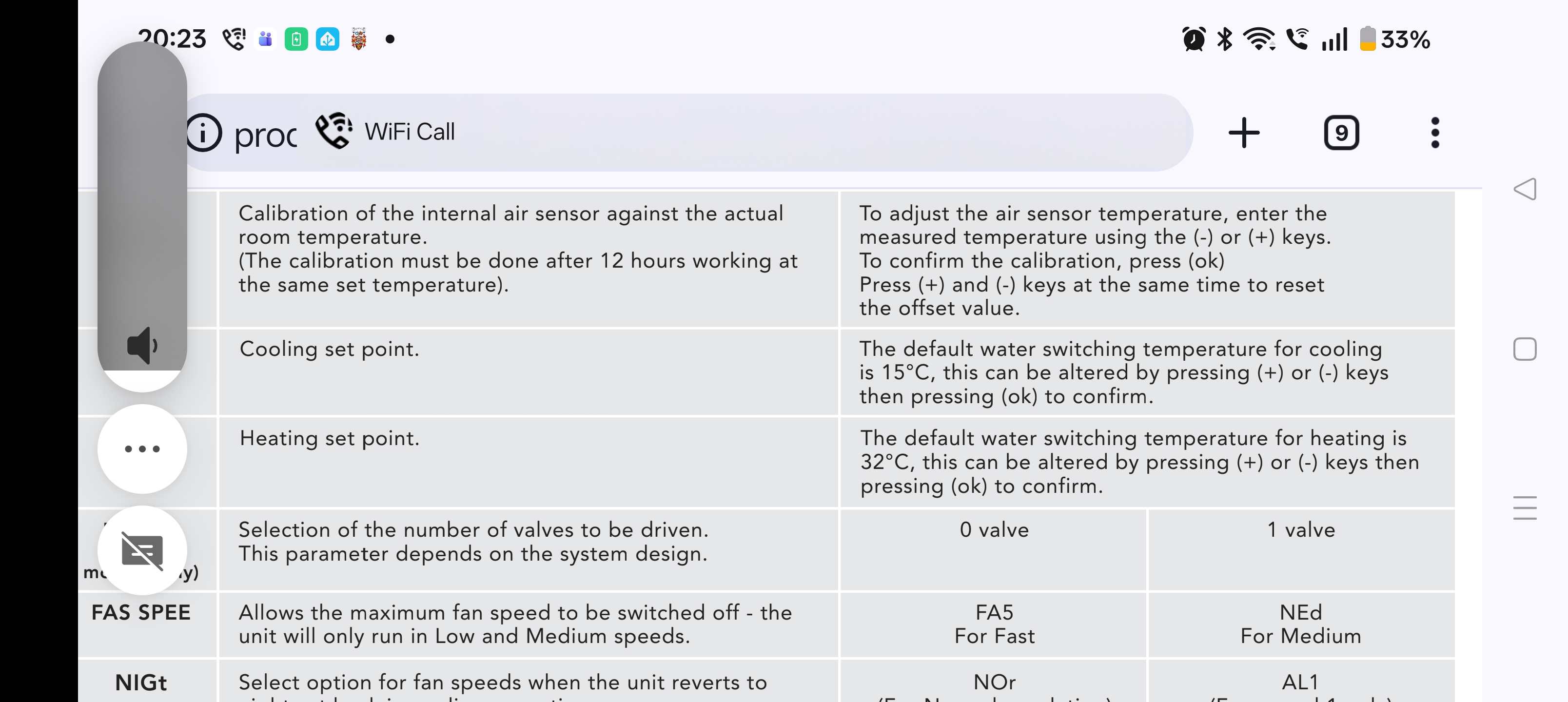

Get the manual downloaded, many have adjustable temps for cooling and heating. Don't ask read the installer manual. We have a Myson iVector MkII, it allows for adjustment of the flow temp to start stop the fan.
You can manually put fan on a fixed speed but then you don't get a modulating output.

Re the Myson you have the installer manual says the fans won't turn on in heating mode unless the flow is 30degrees C. Is this true?
*Edit your manual looks like it cracks on if it doesn't detect a flow temp probe.
No, the 30 Deg figure is adjustable you can also run fan in manual so it runs 24/7 if you want. Our flow temp in heating is about 28 at most. So mine comes on about 24 for heating and about 18 for cooling
