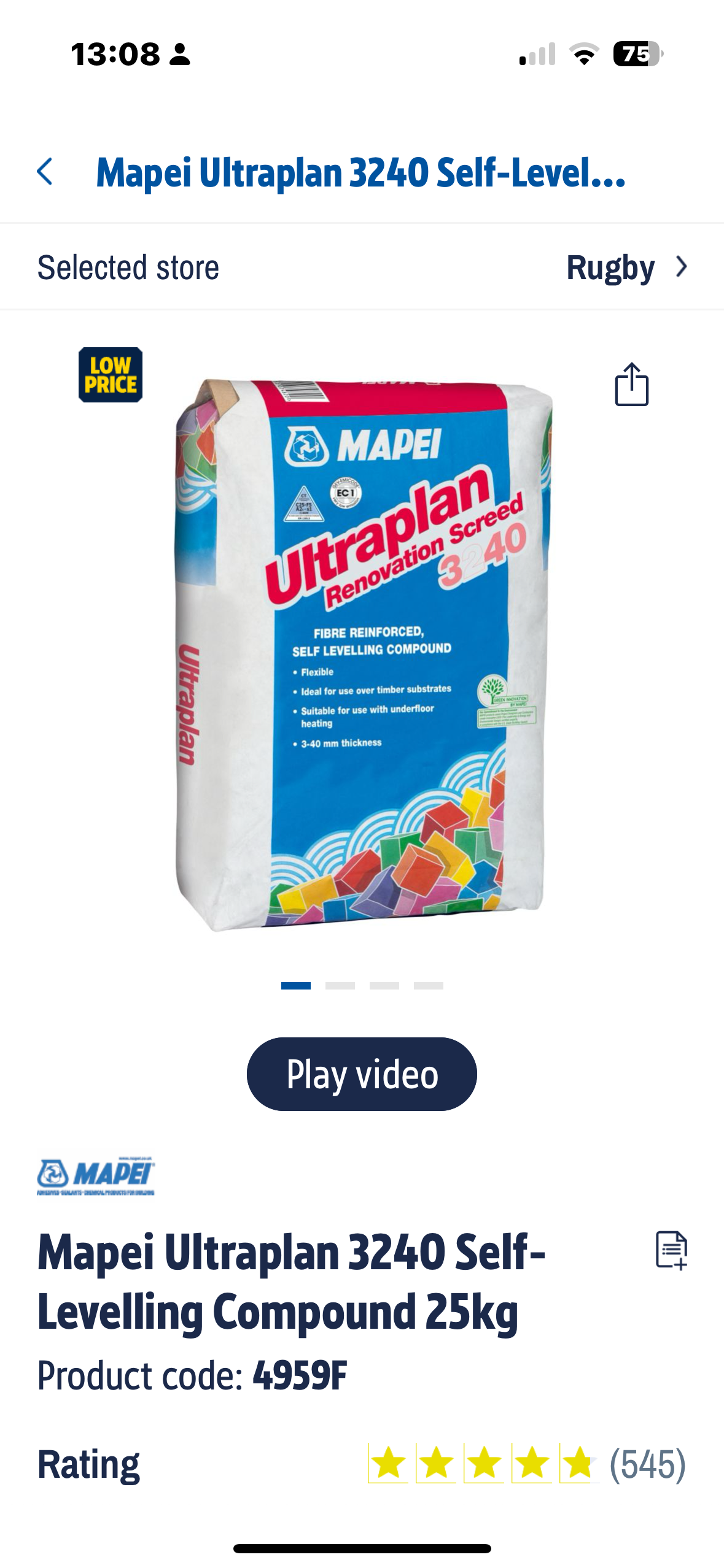

I’ve done these types of jobs hundreds of times over the past 35 years, and defo zeto need for a stainless plate; I think that would make the repair fail again.
Do as you suggest, clear the trough and hoover it all out. Prime (saturate) with 50/50 PVA/water, applying copiously until you don’t see it being sucked into the concrete any more, and then pour in some of this:
Will be right for life after that goes in there. Mix it with fresh water and to a consistency a-la a thick gravy.
If the pipes are bare copper, try and tape these up with gaffa / duct tape.
Lay it directly on to the soaking wet PVA mix and don’t fear that being any compromise to it, it’ll be fine.

I suspect the original problem may be that there is only about 20 mm of cover above the pipes. I've also received advice suggesting that pipes under a slab would ideally have compacted fill around them and significantly more concrete cover above than I appear to have.
If, after opening up the floor, I find that the pipes really are only about 20 mm below the existing surface, would you still proceed with the repair using the mortar you recommended, or would you be concerned about the lack of cover?
Also, if I discover that the void has been caused by settlement of the original backfill beneath the pipes, would you:
  • remove all loose material and fill the area entirely with the repair compound, or
  • first try to reinstate support beneath the pipes using compacted sand or pea gravel before repairing the concrete above?
My concern is whether pouring repair mortar directly onto exposed pipes is the best approach, or whether it's preferable to provide compacted support around and beneath them first.
Finally, would you expect a repair with only around 20 mm of cover above the pipes to remain durable in a normal kitchen walkway, or does that depth itself suggest a more substantial repair is needed?

Any loose material alongside / under the pipes needs removing. Attempting to compact anything in this small void is completely OTT and (IMHO) a waste of time and effort. You’re far better off with the whole void fully filled in one sitting, as a single solid mass.
Foot traffic is considered ‘light’, so fully encapsulating the wrapped pipes with 20mm over them will be fine.
That compound I linked to is particularly well suited to this exact application because it has fibres in it, so it’s very tolerant of the tiny amount of movement you’ll get here.
A wrap with duct tape will offer some more protection and ‘decoupling’, which os best practice vs just pouring onto bare pipes. You can do this in lots of little bits of tape and it doesn’t need to be perfect as every little helps.
