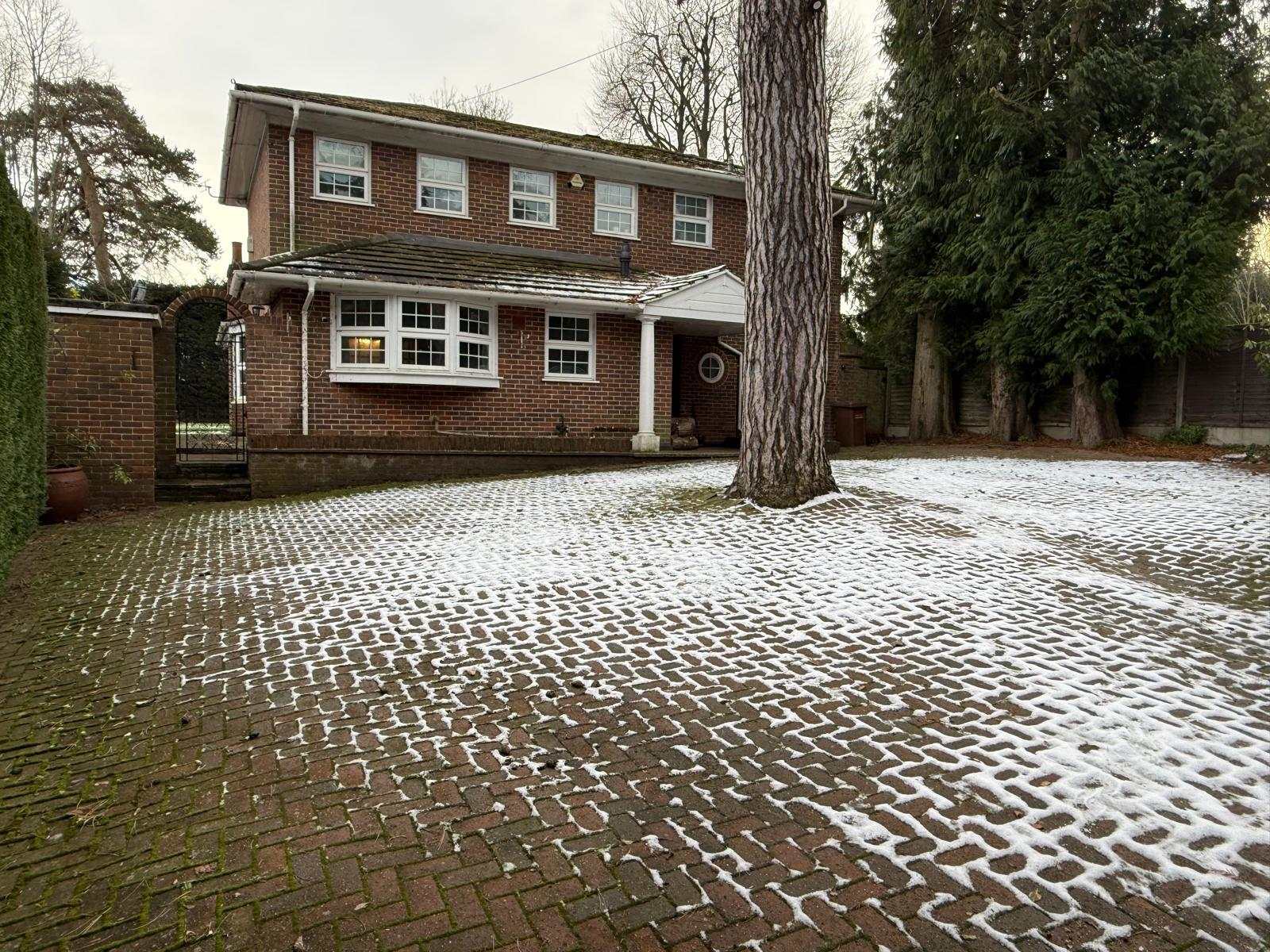

I’m planning a loft conversion and would really appreciate some practical input from those who’ve dealt with steel replacement and logistics. My structural engineer has confirmed that both of the options below are structurally acceptable, but I’m keen to understand which is likely to be more straightforward and lower-risk to execute on my site with restrictive access and a nearby tree.

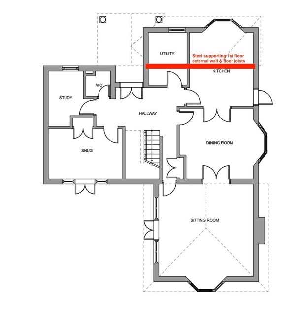

Replace the existing steel beam above the ground-floor kitchen/utility with a larger beam that can support the additional load from the new cut-timber loft structure (see below).

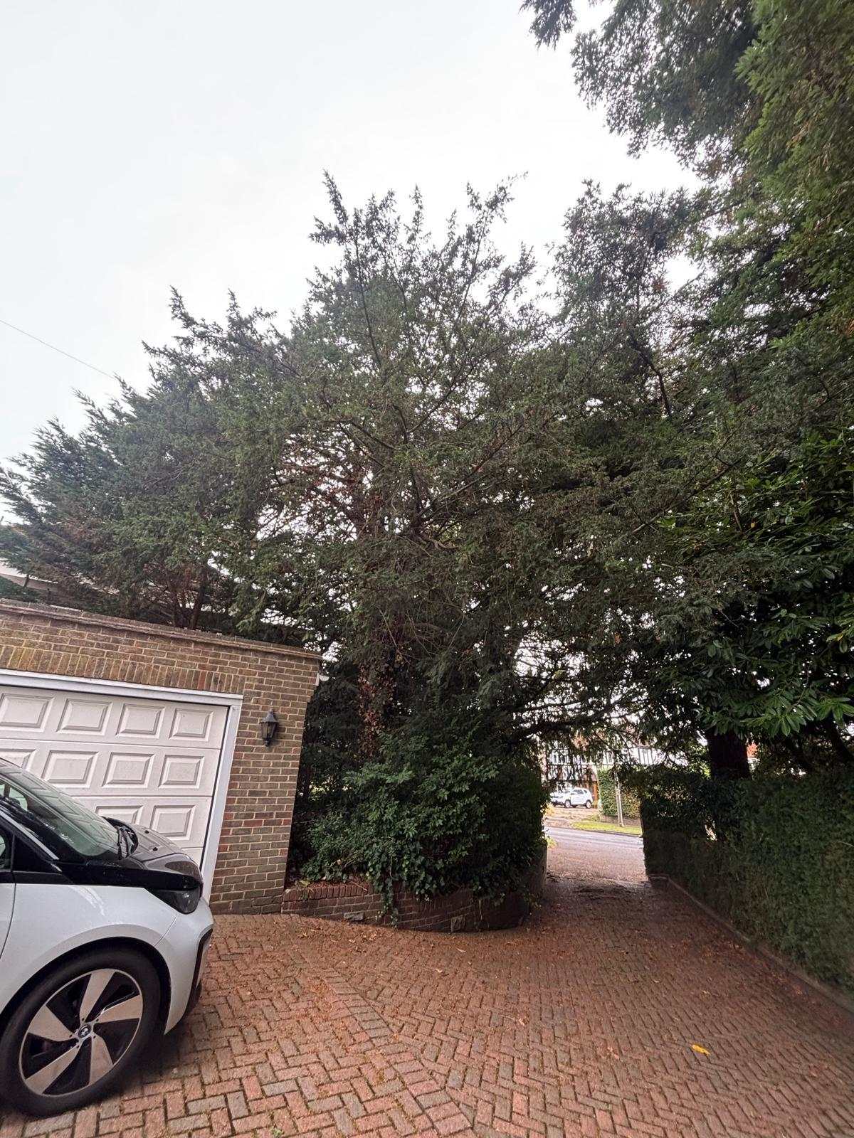

Access to the site is restricted. The only access is via a circa 2.7 m wide driveway running alongside a retaining wall. There is also a large pine tree at the front of the house, which limits lifting options.

  • expose and replace an existing internal beam at ground floor ceiling over 2 rooms, or

The access you have is not really a constraint, for a large crane yes, but 6m beams or UC’s are unlikely to be more than 300 kgs which isn’t a problem to deal with. Mini cranes or even spider cherry pickers with lifting attachments will access very tight spaces.
I think your real question is what would you prefer ? . Aesthetically and disruption while work is ongoing.
