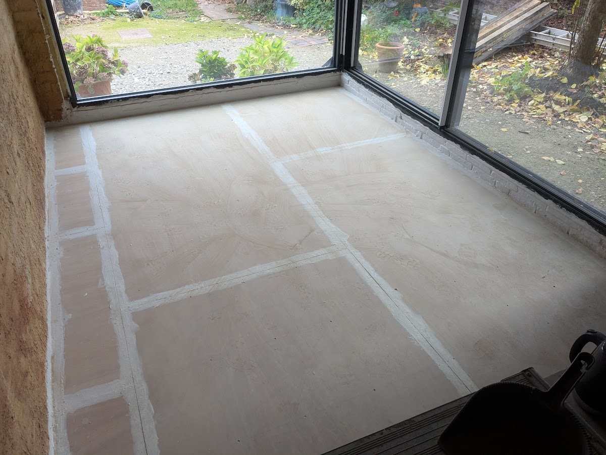

I doing a full heating install into a victorian reno and at the minute the plan is to install UHF in two rooms.
Given the small areas that need covering, and limited onsite access, I am searching for screed options I can mix up myself onsite.
One room has a block & beam subfloor, therefore traditional sand and cement laid at ~65mm thick is the go to option.
The other room has a suspended timber subfloor so I am looking to save Dead load in this particular room, this can be achieved by using a liquid screed at 40mm thick.PXL_20251030_151810134.thumb.jpg.9e756c0bf0570b59133c0347c88ec9a2.jpg
The suspended timber subfloor is newly installed.
I have ran the numbers through ChatGPT and it can comfortably support the weight of a 40mm thick liquid screed laid on 100mm PIR.
Mapei ultraplan reno screed  looks like a potential option, it can be laid to 40mm an UFH compatible although I'm unsure if it is suitable floating on PIR on a suspended timber sub floor.
I don't have a specific concern, so just wondering if anyone has used it in a similar situation?
EDIT:
I called Mapei Tech and they advised that ultraplan reno is moreso a self leveling product and instead recommend using Topcem, however thhe minimum thickness it can be laid at is 55mm, so a weight increase that I will have to check
