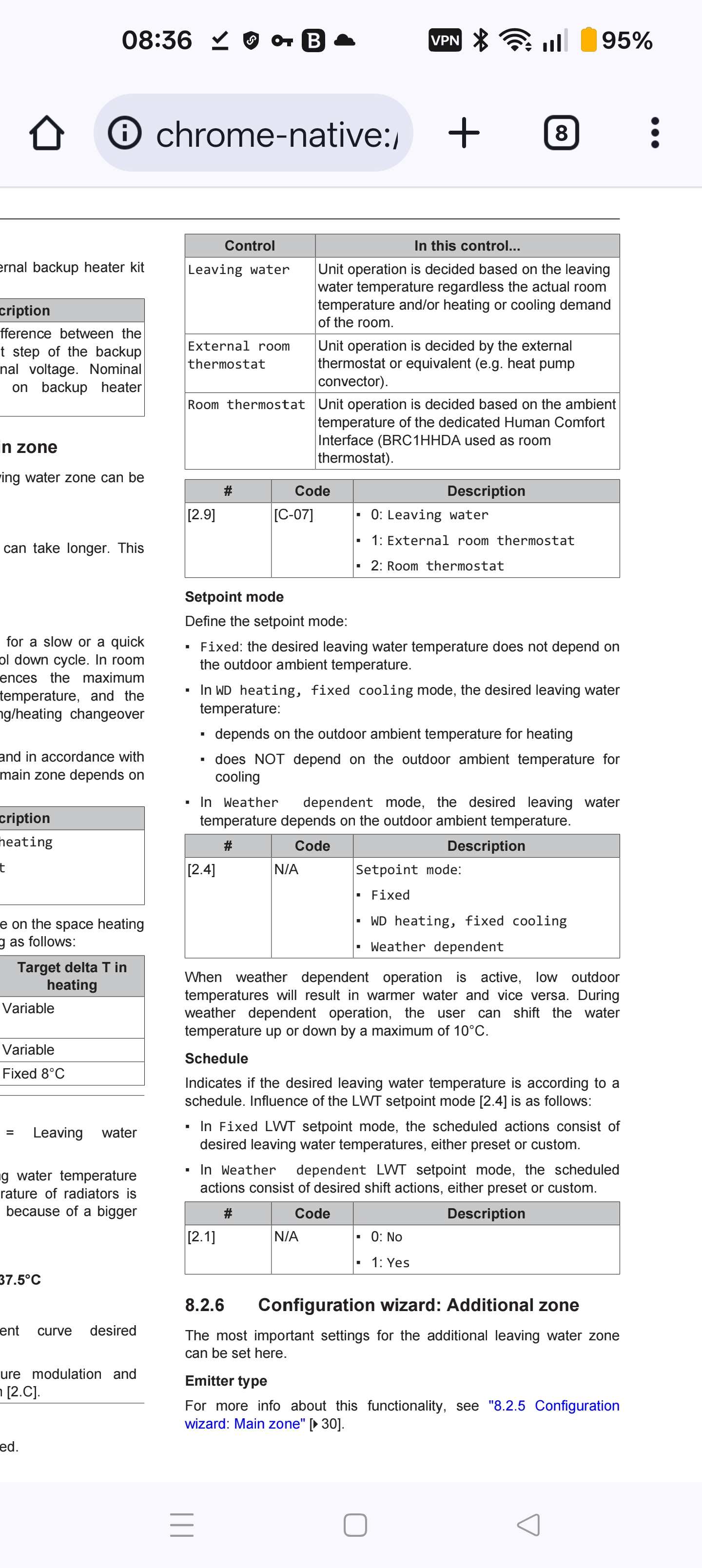

Do you have the control settings, set correctly?
Screenshot_2025-11-07-08-36-57-53_40deb401b9ffe8e1df2f1cc5ba480b12.thumb.jpg.c26bd4c9a225d72e9210a5bbc51e76d3.jpg
Leaving water, external thermostat and room thermostat looks for different things. If you have selected room thermostat and don't have the required interface, it's looking for a signal it will never get.
Get the manual out or download and go through everything in the setup wizard, the only stopping it starting is a setting.
