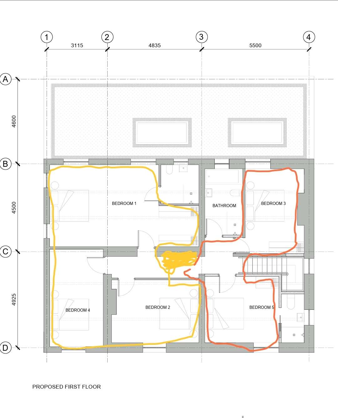

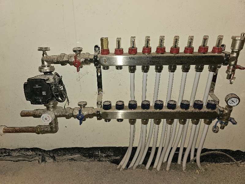

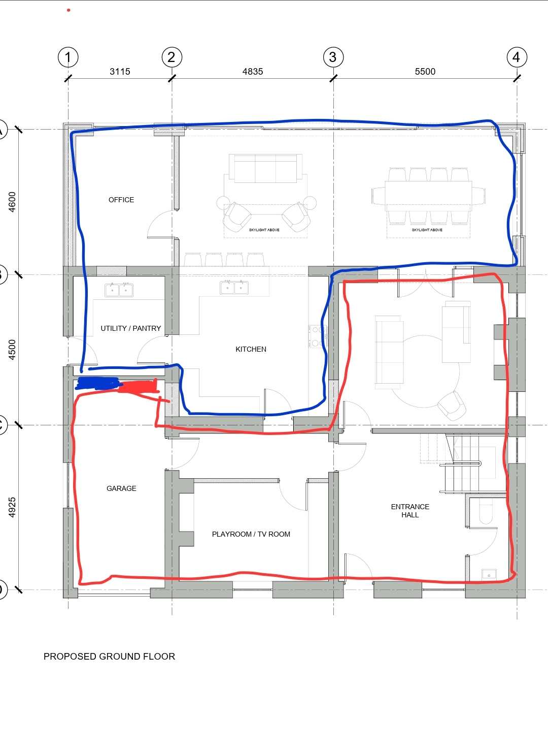

October 27, 20251 yr Hello, I started a project hastily and it has somewhat escalated. The information here has been amazing. We have a 5 bed detached farmhouse (half/half previous extension, half solid 50cm stone walls, half insulated cavity). Very exposed to winds and rain. We made the decision to put ufh downstairs and upstairs, but admittedly I really should have had a proper heat loss done and spent the extra on a heating engineer. Lack of knowledge and poor advice at the time... but here I am. Build up is 70mm hardcore/blinding, DPM, 150mm concrete slab in mesh, 150mm PIR, 16mm ufh pipes at 150mm centres clipped to insulation with 75mm sand/cement dry screed to SR2. Upstairs, removed old floorboards, leveled the joists, extra reinforced those that needed it, noggins etc... 5cm PIR between joists, soundproofing tape, routed floorboard for 16mm pipes at 150mm spacing. Primer, Perimeter 6mm expansion strip tape and then 1 to 3cm flow screed over the top to level, fill in boards. Upstairs is 6 valves for 5 bedroom zones. The bathrooms are on electric ufh mats. Downstairs is on 7 valves doing 4 zones. I am likely going to add another 5 valves for 3 zones for an extension in the future. All runs are below 100m, 16mm at 150 centres. My thought was this way I can reduce flows and wouldn't be left with a cold house (cant insulate internal or externals of the old part of the house). The 3 manifolds have a manual mixing valve and each with its own pump. Each manifold has a heatmeiser control that I am told connects to actuators that go on the valves. Then each room will have a thermostat that switches the actuators on and off when the rooms hit the set temperatures. I had assumed that my current boiler/cylinder would have been enough to supply the system. But my builder's plumber says that it is a very old boiler 10+ years and they would recommend an upgrade. Finally to my question and thanks for reading so far: My heatloss is around 15 to 18kw. I have ruled out ASHP due to only having access to cost/space and single phase electricity. If I am going to upgrade my heating system, I would like to have weather comp option and hot water priority. I have had lots of mixed messages and designs about this from different plumbers, with huge varying cost. So here I am asking for option on what people have done with wet underfloor only set ups. Current recommendation has been a heat only system with a low loss header that supplies ufh and the cylinder... In my head I was thinking a 4 pipe system boilder that has inbuilt domestic hotwater priority. Some kind of communication centre that means the heatmeisers can call for hotwater at a different temperature to the hot water cylinder. Do I need a low loss header for the 3 manifolds to connect to and blend from? Have I shot myself in the foot with the kit I already have (manual mixing valves and heatmeiser) to have weather comp? I am happy to invest time tweaking flow rates etc... to get a more stable heatoutput to stop the actuators constantly opening and closing. Sorry if you think this is better suited to the the ufh forum Thanks again Edited October 27, 20251 yr by RedSpottedSev
October 27, 20251 yr For me, I would reduce to the number of zones down to a minimum. Your issue is you will have a slow system response and you room temps could fluctuate quite a lot of you are bouncing of a thermostat. Next choice of mixers, IVAR or electronic (ESBE etc) only. Or do you even need a mixer anywhere? Can your system boiler provide enough flow for all loops on its own? If not, heat only boiler and keep manifold mixer and pump. Then a single thermostat per manifold. Run an almost flat WC curve of about 35 to 40 degs. Low loss header - no Flow needed will drive system or heat only I suspect. I would start by looking at the longer loop and all pipes to and from that loop and look at pressure drop. Once you have that, it will set pressure drop for system, then add all the flows you need together all loops). Now you have a pump duty point. You can now make a sensible choice of system or heat only. Thermostats, implement in each room - but don't give all active control, use for analysis for system balancing. Don't install manifold actuators. Use a manifold wiring centre to just switch pump on or off if you keep the mixers. No mixers and balanced system still leave off you add later if you have a problem room that overheats.
October 27, 20251 yr Forgot to mention your current mixing valves are unlikely to work or work well with WC. They may require to run at circa 50 degs to have any authority of manifold temperature. 42 minutes ago, RedSpottedSev said: Some kind of communication centre that means the heatmeisers can call for hotwater at a different temperature to the hot water cylinder. A boiler suitable for X or W plan or 4 pipe will have suitable control for switching between the two duties (CH and DHW). Look at Viessmann, Atag, Intergas boilers. Size about 20 to 24kW. If you are doing a new cylinder, buy a heat pump cylinder (3m² coil) so you get decent condensing and or rapid reheat when doing DHW.
October 27, 20251 yr Author Thank you, My understanding is that the current system boiler cant provide enough flow. So I am looking at a new boiler and will upgrade cylinder as we need 250L vs the 170L currently. My priority is avoiding constant on/off yoyo switching of each room and making sure they stay as constant comfortable temperature as outside temperatures fluctuate. Efficiency gains would be a bonus. I was sold the manifolds with pump and mixer initially before I had done any research (and hadn't planned upstairs ufh and getting rid of all radiators) so I have some of the kit ie pump, mixer, manifold, heatmeiser control and thermostats. So, talking about the ideal set up (which I may have to do in stages and accept some wastage of things already ordered), I can swap out the fixed/manual mixing valve on the manifolds to ESBE. I haven't come across IVAR but will read about them. Each manifold will then have ESBE/grundfos upm3 auto as a pump station and a hestmeiser. Manifold 1 - main downstairs (can reduce to 2 zones) Manifold 2 - kitchen and extension (high heat loss - glass sliders etc.. reduce to 3 zones) Manifold 3 - upstairs (single zone but option to shut off guest room when not in use) So... can I have a set up where if and when properly balanced, the heatmeiser and actuators close/open rooms that might not be in use, and the rooms in use will just have thermostats for info only, with the esbe running weather comp? How do you decide where the call for heat comes from for each manifold? (Coldest room and then adjust other flow rates down?) Also do I need extra wiring pulling up alongside the 5 core (heatmeiser) for the ESBE valves? Which boiler and control unit is likely going to offer the easiest communication/connection set up to the heatmeisers and esbe? Thanks again, I appreciate I have a lot to learn yet..
October 27, 20251 yr Not sure you really save anything by not heating rooms, the unheated rooms just suck in the heat from other rooms, so net energy input really doesn't change. Would really try to move to a single zone per manifold, the loops in that manifold get balanced to get room temps you want. Having room sensors in each room allows you run all loops or none just by switching pump. So example, room 1 is targeting 20 and rooms 2,3 and 4 targets 20.5. if any room drops below there target all loops come online and later all go off. But better still balance the whole lot to run WC. If suitably balanced all should be ok. Issue I found was if you are shutting down loops you can run into the situation where only one zone is calling for heat and the boiler goes into meltdown, short cycling and all the gain just get burnt with excess gas consumption. Share your current boiler and mixer model/make?

November 1, 20251 yr Been thinking about how best to do this system I would do 3 zones - one for each manifold, so no actuators are needed on the manifold, retain you pumps and mixers, but control pump on manifold with the zone thermostat - no wiring centres are needed, but install if you have them (if you want). It may be way easier to install a buffer, but size to about 100L. This will keep boiler happy. Nibe (they do heat pumps) have good design buffers, there are a couple on eBay at the moment at decent prices. Buffers can be installed in various ways, I would recommend a 2 port setup. So a 2 port is just that, you use only 2 ports. One at top, one at bottom buffer. Each port has an oversized tee, so if using 22mm pipe do a 28mm tee at each port. This gives a hydraulic separation between heating and boiler. So you operate the two sides independently, the buffer you add a thermostat and the thermostat controls the boiler only. Set to about 15 degs above max UFH flow temp this allow UFH mixer to have some authority. Boiler has one job keep buffer happy. UFH just draws from buffer, but when boiler is on, will draw water direct from the boiler and flow and return will by-pass the buffer, as zones switch off, excess flow from boiler will pass through buffer. For DHW you have a 3 port diverter between buffer and boiler. Boiler flips to DHW, runs flat out to charge cylinder cylinder, buffer continues to feed the UFH. At end of DHW, boiler moves to charge buffer. You don't need zone valves if you don't want them. The other option is a fully open system, no buffer, no mixers and feed whole lot from a good boiler that does weather compensation. You may need to add additional pump to the system return. But you need to be prepared to fully balance system, adding zones will miss with a lot of settings and you would run full WC.

November 8, 20251 yr Author I have just realised a flaw in my plan, as one Heatmeiser can't control 2 manifolds, so it is looking like the buffer tank set up.
November 9, 2025Nov 9 On 08/11/2025 at 00:19, RedSpottedSev said: only use 2 heatmeiser UHF-RF V2 (upstairs/downstairs), I can have the downstairs heatmeiser controlling the 14 loops, as I understand each 'zone' on the heatmeiser can control 4 actuators If you are controlling the two down stairs manifolds as a single zone, you do not need actuators on the manifolds at all. All you need to do is start and stop the pumps. This is done via the pump outlet of the UFH controller - use one controller and take a second power signal to the other manifold. Then you have one thermostat calling for heat for the whole down stairs. But maybe better install several thermostats and allow either to call for heat, any thermostat starts the pumps. Any cold spot is likely to be followed soon after by other ones, so allow whole downstairs to run. With buffer you get hydraulic seperation so you don't even need two port valves in the system. Upstairs. Maybe get a simple stand alone wireless thermostat - something like Computherm Q20RF, very adjustable, come with free standing and wall brackets. LLH are something for industrial systems and need very careful sizing avoid. On 08/11/2025 at 00:19, RedSpottedSev said: in hot weather the boiler will essentially have another 100L of water to keep warm Your boiler if you add an outside temperature sensor will manage that for you, you should be able to set at say 15 degs outside temp switch off heating. But I would also add a WC curve, say start at 20 outside flow 20, so the boiler does nothing when it's warm anyway. Then say 45 when -3. You may have to fiddle with the settings depending on how your mixers respond and house temperature. Set the mixers at say 38 as a safety net only. The idea is the flow temp takes an age to heat up house and then you don't allow it cool too much and the heating just ticks away topping up as energy is lost.
