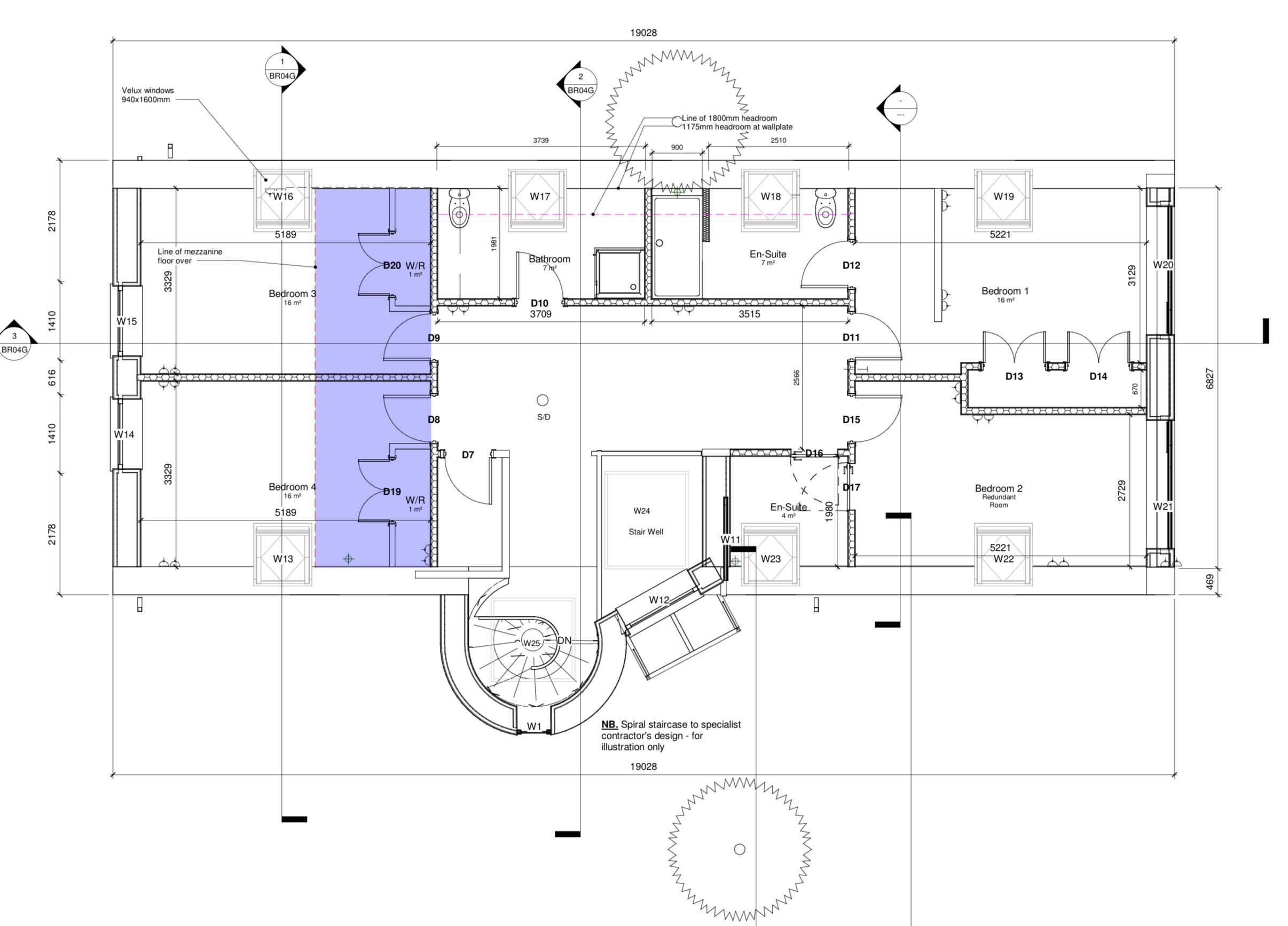

Copy of the upstairs floor plans and section for context / interest - the ceilings are very high, so when it comes to heating and sizing the MVHR I’m trying to work out how much the volume affects the sized of ASHP and MVHR.
High ceilings affect form factor, so you have a bigger surface area exposed to the outside. You just do the room by room heat loss calculation as normal, you will just have more wall and more roof exposed (if vaulted). Small impacts on a well insulated house.
Depends on where you are in the country for ventilation, just follow building regs guidance to size, England is different from Scotland. You will be turning the system down after completion anyway, because you end up over ventilating at BR rates.
Bathroom heating, you normally want bathrooms warmer than bedrooms, so you need heating in them. Bedrooms can be ok at 18-19, bathrooms will feel very cold at that. With a cooler bedroom they suck the heat from ensuites, so you need bigger than calculated towel rails.
