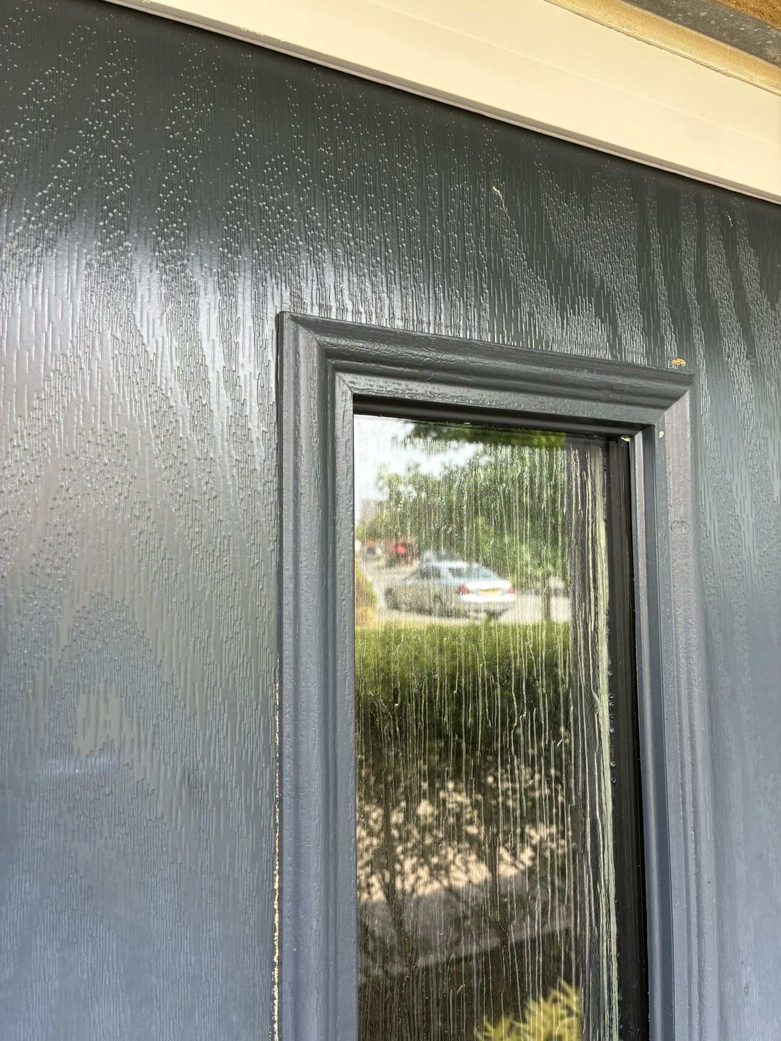

We bought a new build in 2017 which has a foil lined front door. Over the years it has failed and some of the beading is shrinking leaving a small gap around the glazing. What's the best method of painting the door (if at all) or bringing some of the colour back.
Close up pic which makes it look better than it actually is.
Foil lined is basically a plastic covering. So use a paint suitable for plastic or a primer suitable and any suitable paint for the primer over it.
I just bought some of this for painting some outside plastic, covers really well and great finish. No primer used.
