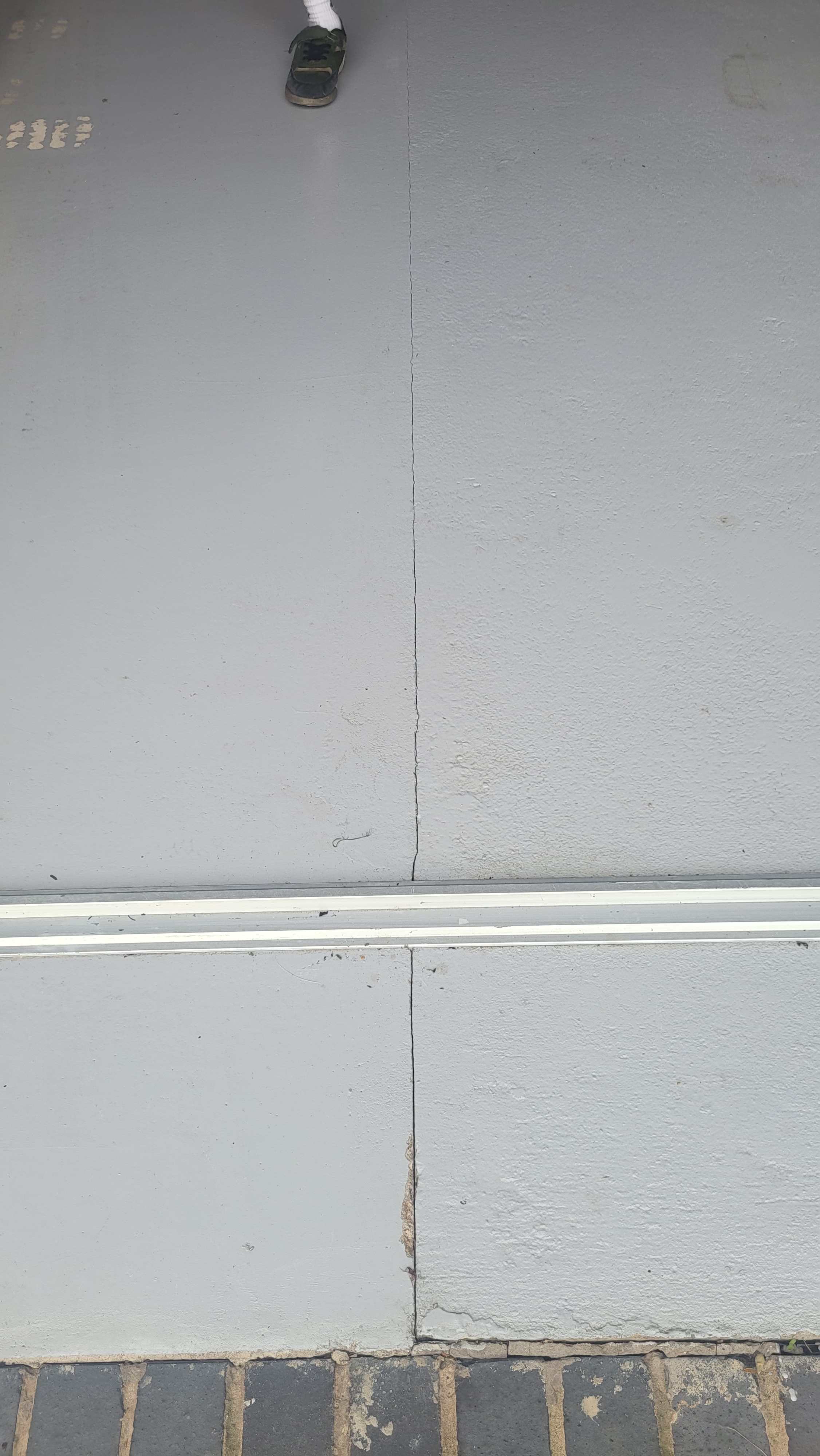

We had some movement where a subbie used insulation under the screed in the garage floor. Found out after a year of use, but builder came out and dug out and redid the area.
However, I now have this slight join between the two different slabs, and with my epoxy resin coating it really shows.
Before the builder rectified it, when the original crack was there I tried some two part crack filler but it was gritty and impossible to get a smooth/flush finish.
Any recommendations for how to make it as seemless as possible, but also slightly flexible with the two different slabs?
Grind it out and use a mastic that’s designed for this job.
You can hire a grinder on wheels like an electrician uses for chasing out. Then put a blade in that’s wide enough to give you a decent bit of space for the mastic to have some purchase.
Would flexible grout be worth a shot? We have 2 x 7 seater cars, and it's block and beam so some slight movement may occur?
Nope. As you have movement a grout will just deteriorate and crumble away.
Use a mastic as it is a dynamic not static deck.
Figured as much, was just hoping for something more seemless, but makes sense! Thanks
