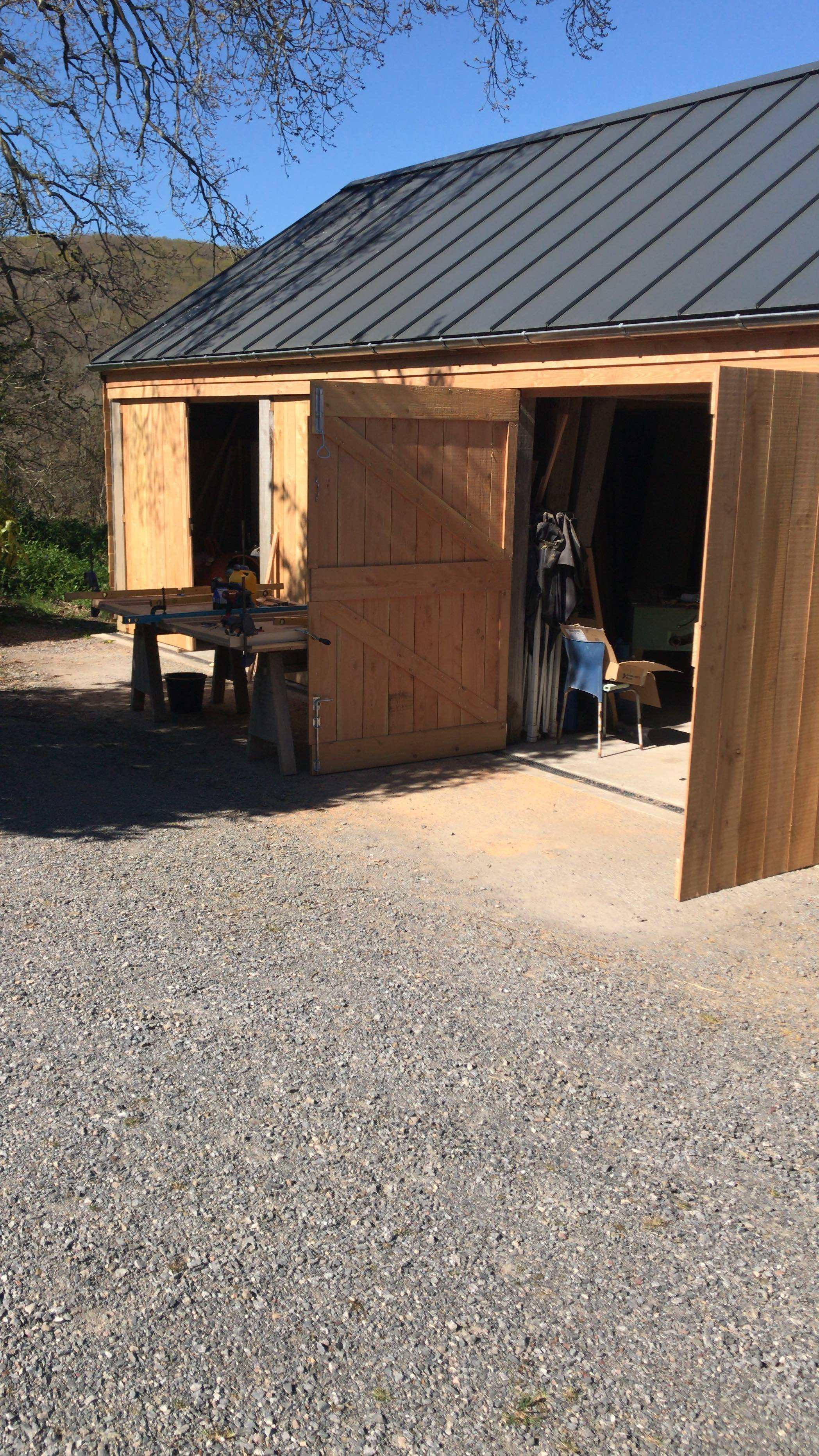

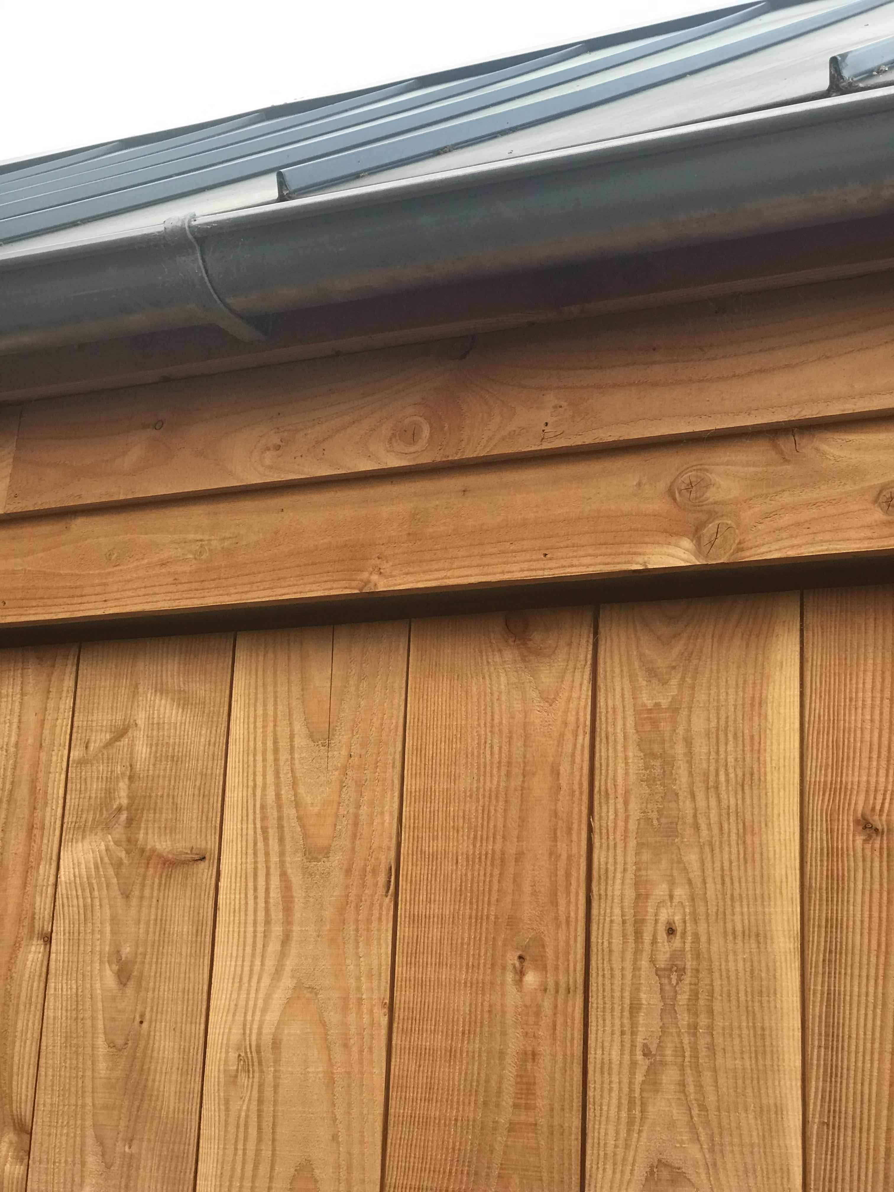

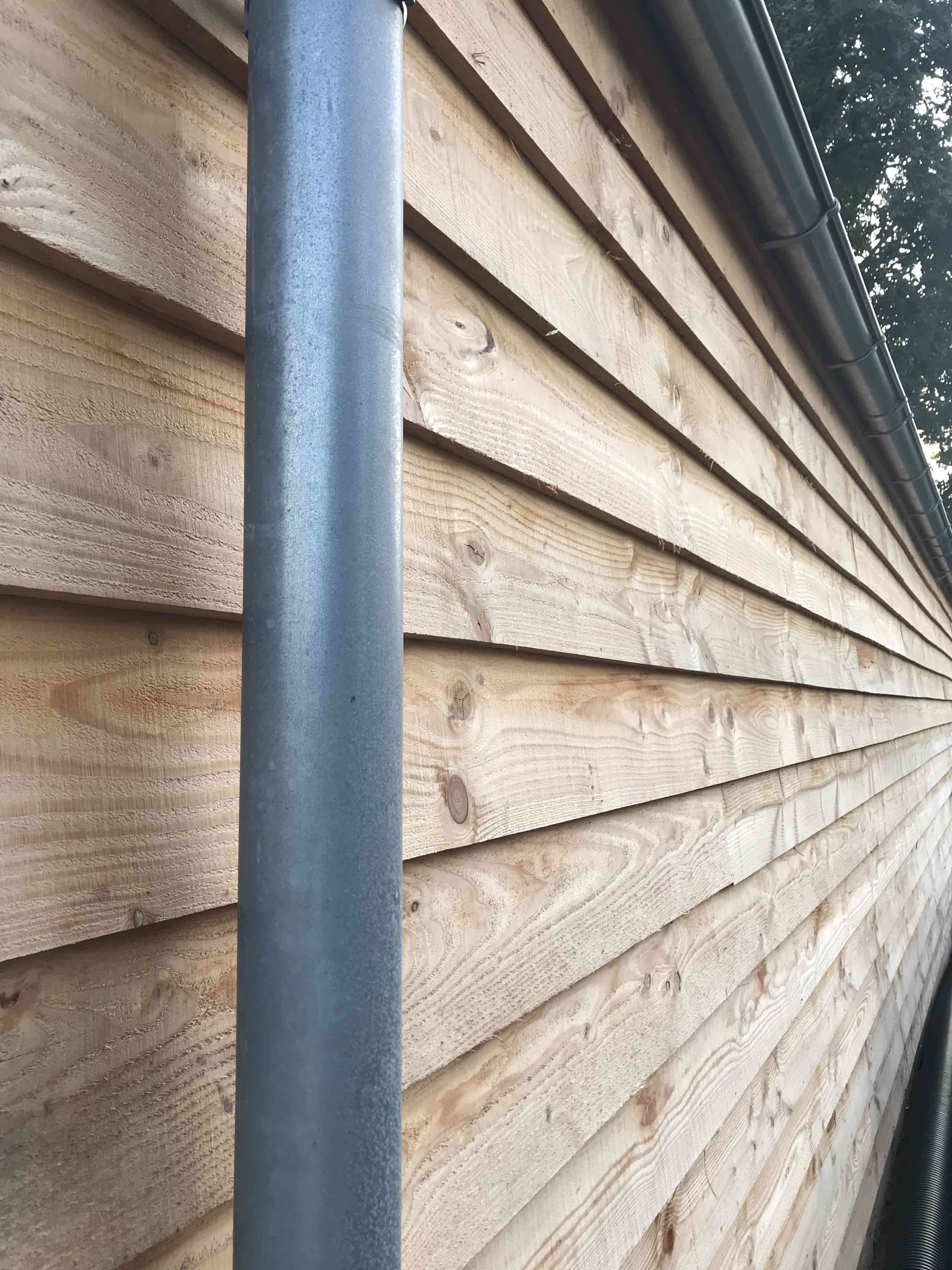

I made and fitted the fascia boards first before fixing the horizontal Douglas fir cladding.
Does that help?

Your fascia detail looks fine to me in the drawing, all my feather edge on 25mm batten. I had to make a combined fascia / soffit board out of Douglas fir due to the overhang.
