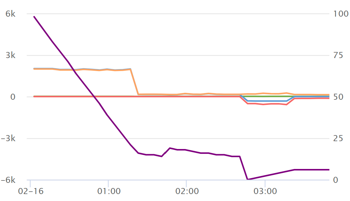

Every time my battery charges and discharges, even though the minimum discharge level is set to 6%, it always overrides that and discharges to zero then recharges to 6%. Anyone know why that happens?
Hi @PhilT Your going to have to give a little more info than that. Even an indication of what the different coloured lines mean would help!!!
However, if your batteries are really going down to zero, this could damage the batteries depending what sort and the set up.
M.
At around 02:40, with consumption (orange) continuing at a background level, there is an unscheduled light battery charge (blue and red lines) but, bizarrely, in the first 5 minutes, the SOC (purple line) drops from around 17% to ZERO, WITHOUT ANY CORRESPONDING CHANGE IN CONSUMPTION OR OTHER OUTGOING POWER, then gradually goes up to around 6% SOC at around 03:20 at the end of this mysterious little charge cycle
Do the batteries have some form of internal heating function? Could this cause the discharge?
could be - the specs say it has "low temperature protection", but that's a very short warming time and it happens every single discharge irrespective of temperature

Maybe not that then, only mentioning that as we had a similar issue with a leisure battery in our Campervan, it would self heat every night as the temperature dropped if we were not using it.
