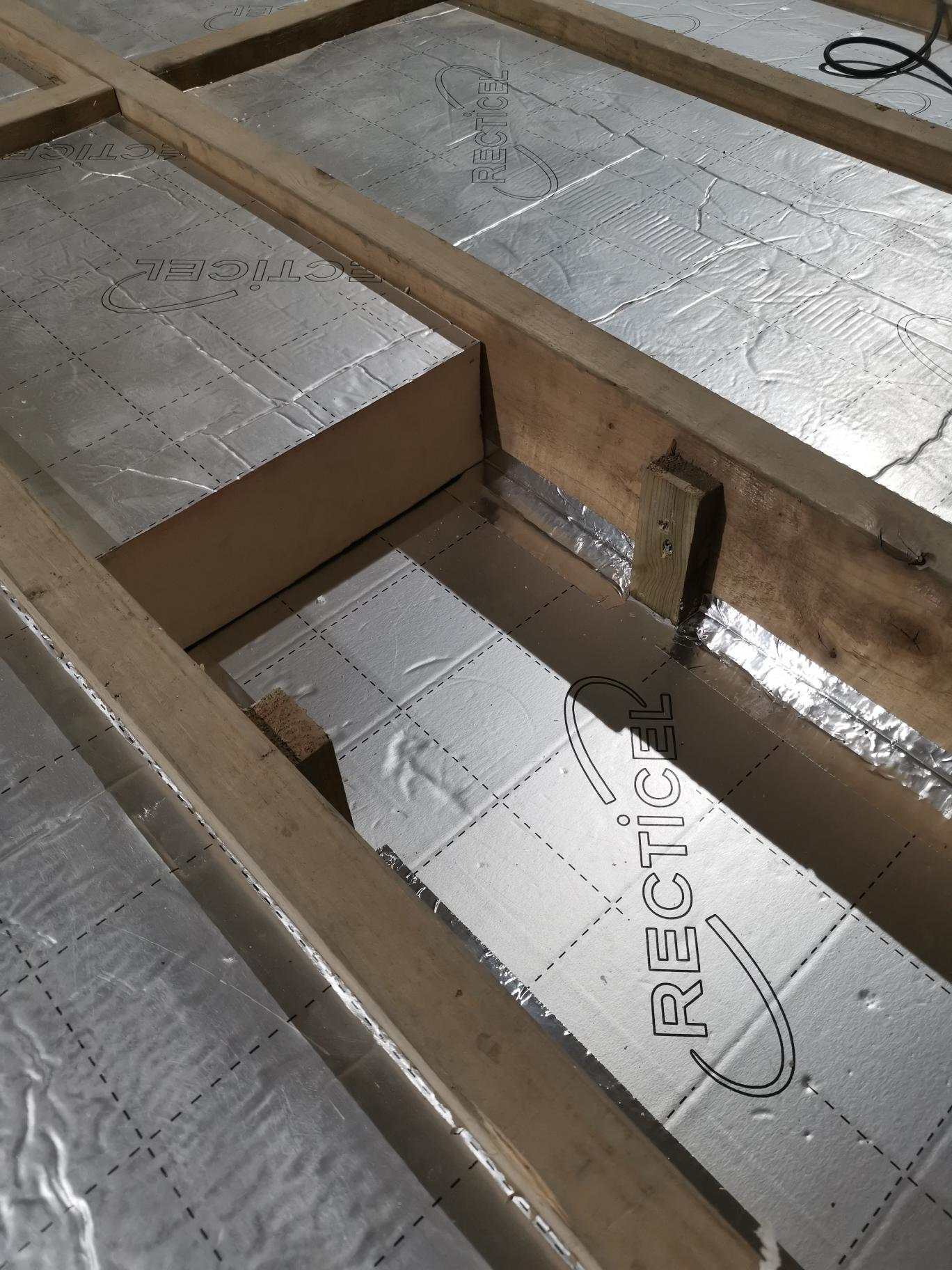

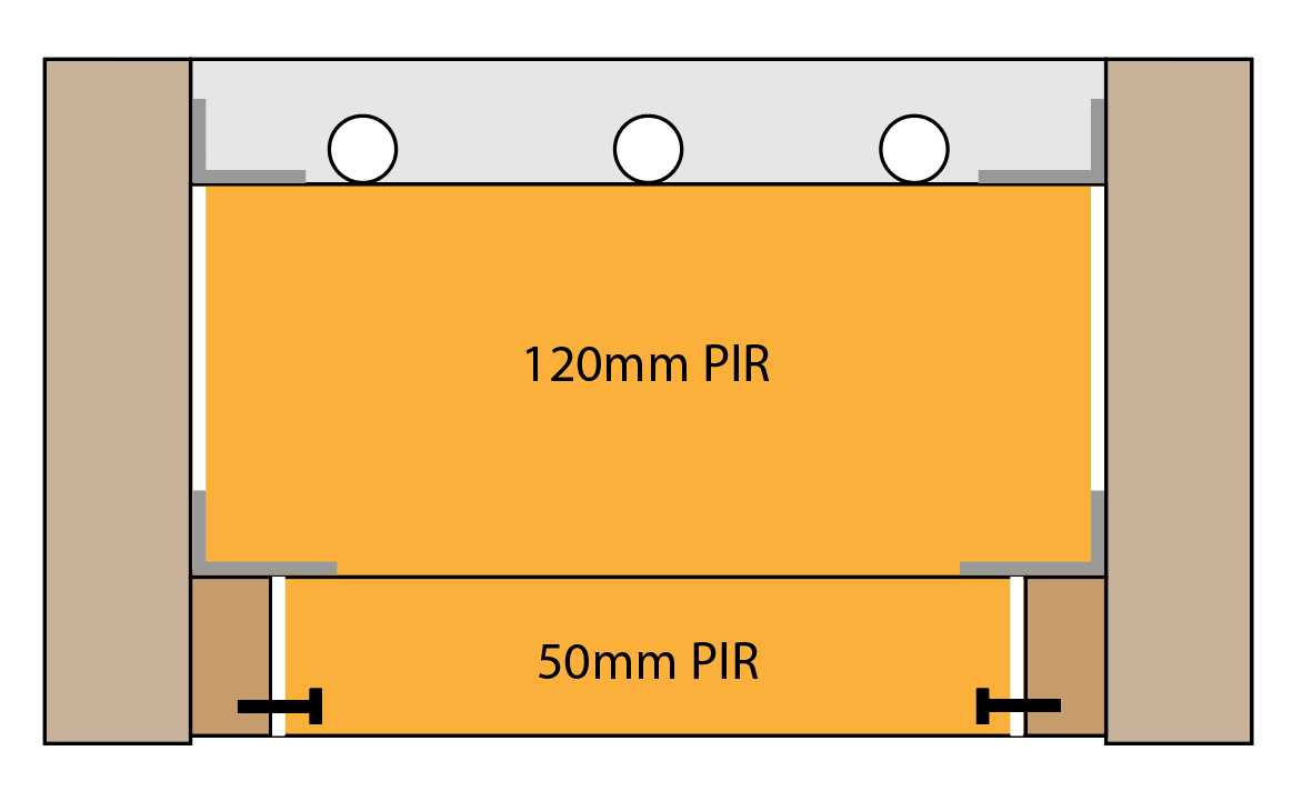

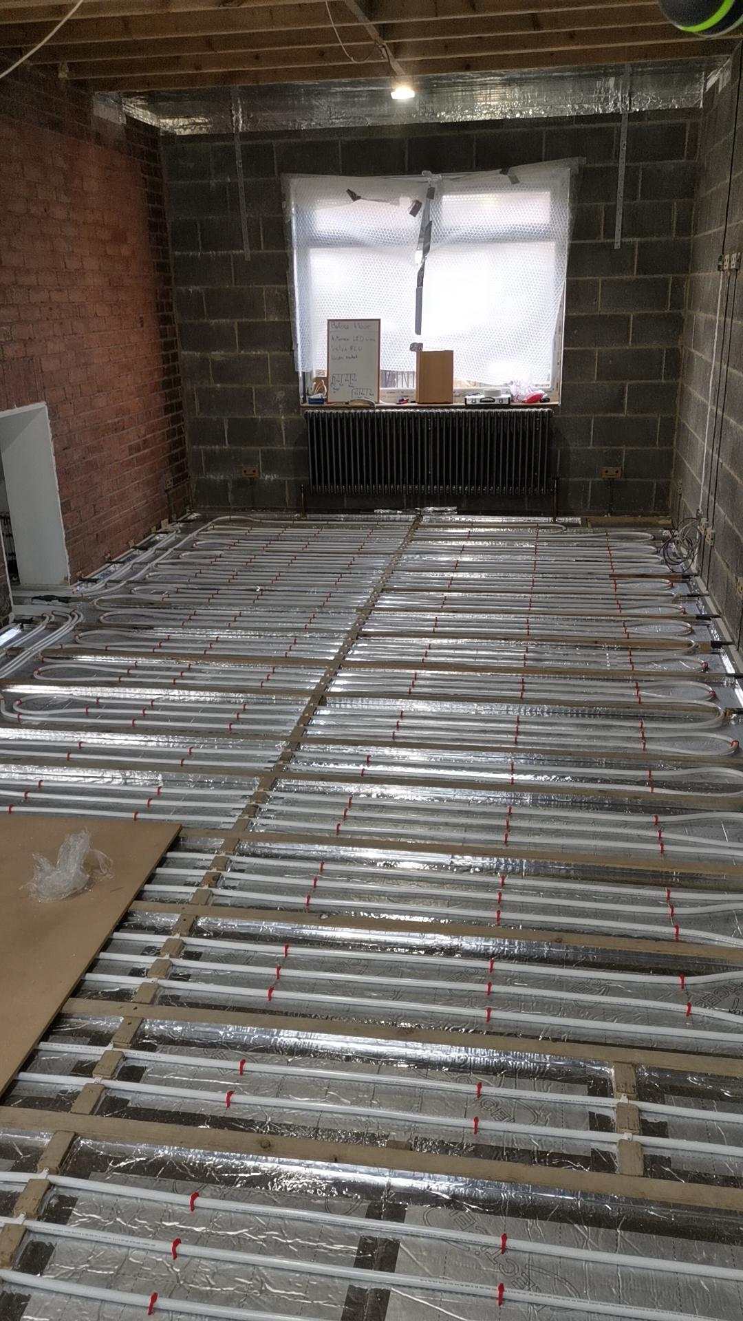

January 30, 20251 yr yeah ive done it and added UFH and as far as i can tell its fine. Significantly warmer than without it but it was backbreaking/soul destroying work, even putting the tape on took days and days. Thankfully once in a lifetime. Insulation saw in the jigsaw, PIR, Illbruck FM330 foam, aluminuim tape, plenty of painkillers.
