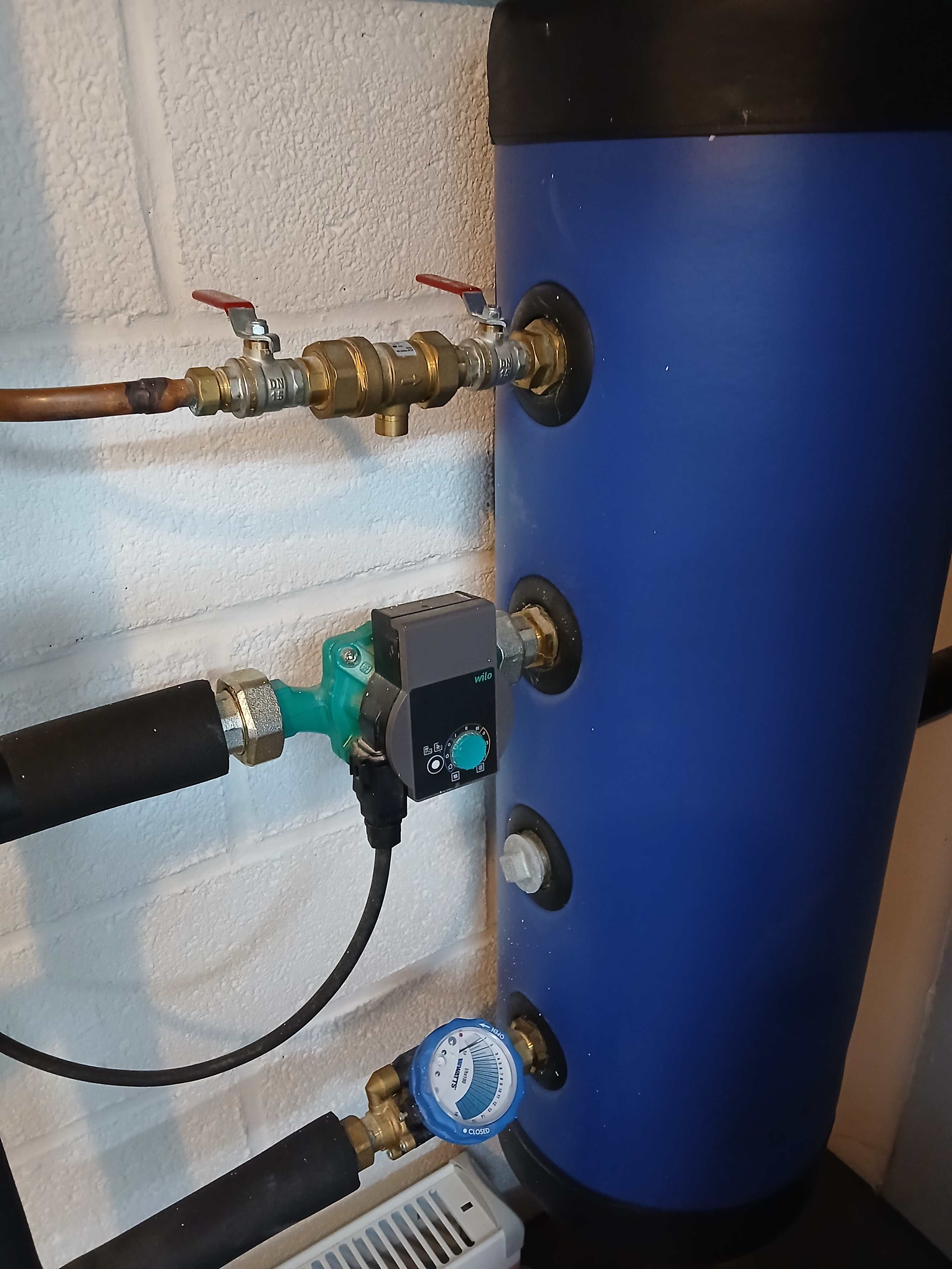

20250102_133930.thumb.jpg.de76ace80f0577ee8448b7f3764718f4.jpgHi newbie here ,got a ecodan air/water heat source pump fitted over 12 months ago, running great so far and got a few basics on running, im curious about these two gauges from the blue tank ,I assume it's the flow rate but what should they read when running?,at the moment the top one when running flicks between 2 readings both around 10 and the needle on  the large blue one underneath points just over half way

The top one is a circulation pump. It can either be set for radiators (left side) fixed flow (top) or under floor heating (right side) each option has three settings depending on the number or rads of square metre size of the UFH. The LED displays a number of things including flow rate and energy used (in Watts) It’s hard to see but yours looks like it’s on the middle setting for rads. Do you have the manual as it will likely give you some idea there.
Thanks for the reply Kelvin,the top one is set for the correct amount of radiators according to the bumph I got when it was fitted,it seems to be running OK, it's more of a curiosity thing about what the flow rate should be ,I'll post photos of it running
