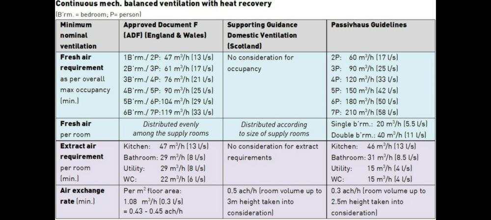

You want 40 in a double and 20 in a single bedroom.
Dump the hall extract, not needed, unless you need to balance the numbers. Use Passivhaus numbers.
Kitchen extract put both ducts to a single extract point - no value having two, keep 9. Lounge area the same one terminal, keep 4.
Normal flow area, multiply 2.5, multiply 0.3. so normal flow about 83m³/h, boost multiply by 1.2.

I am still a bit confused about the calculation. Based on the entire space volume I will need approx 84 m3/h flow. This is more or less what I used for each room in my Excel to calculate for the fresh air intake 0.3 ACH per room in column M. I calculated 0.3 l/s /m2 but it is close.
Using the passive house guidelines for a 4 person household I will need 120 m3/h fresh air but calculating on volume only 84 m3/h which is a big difference. Now taking the bedrooms, based on their size it is tough to consider them single or double. But let's say the two bedrooms of approx 15m2 in which there will be double beds I can consider "double" and the small 12 m2 "single". Based on this guidelines I will need 100 m3/h just for the bedrooms, which will leave 20m3/h (out of the 120 m3/h) left for the living room. For example one of the big bedrooms has a volume of 38 m3 so calculating 0.3 ACH, I will need a flow of 11.4 m3/h. Even if I consider it a single bedroom based on the guidelines I will need 20 m3/h which will bring the ACH to approx 0.5.
For the three spaces requiring extract (kitchen, bathroom and WC) I will need 92 m3/h extract rate. If I consider all the three bedrooms as single I will then need 60m3/h fresh air and to balance the numbers I will then setup the fresh air in the living room to 32 m3/h? This without taking in consideration the 120m3/h fresh air requirement...
Since the kitchen and the living room share the same space, should the kitchen extract (46m3/h) match the intake for the living room or it will be OK to live it at 32 m3/h?

Simple way to think about and you have given the answer - use the most demanding airflow. So if 4P is greater than 0.3ACH, you use the 4P
Double single rooms - how many people will sleep in the room - nothing to do with area. Small bedroom with bunk beds is a double room, no matter how big or small. Treat guest rooms as a single or split the difference.
