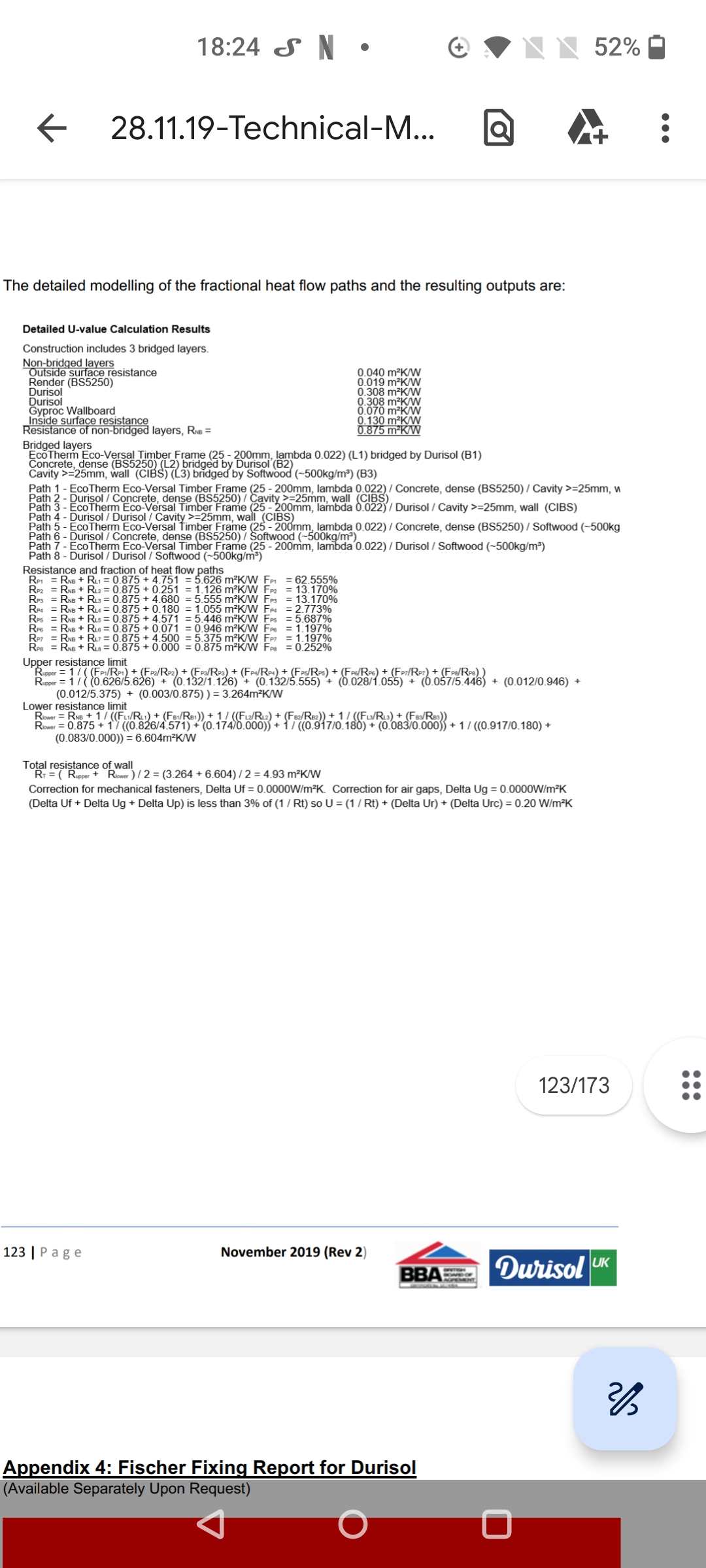

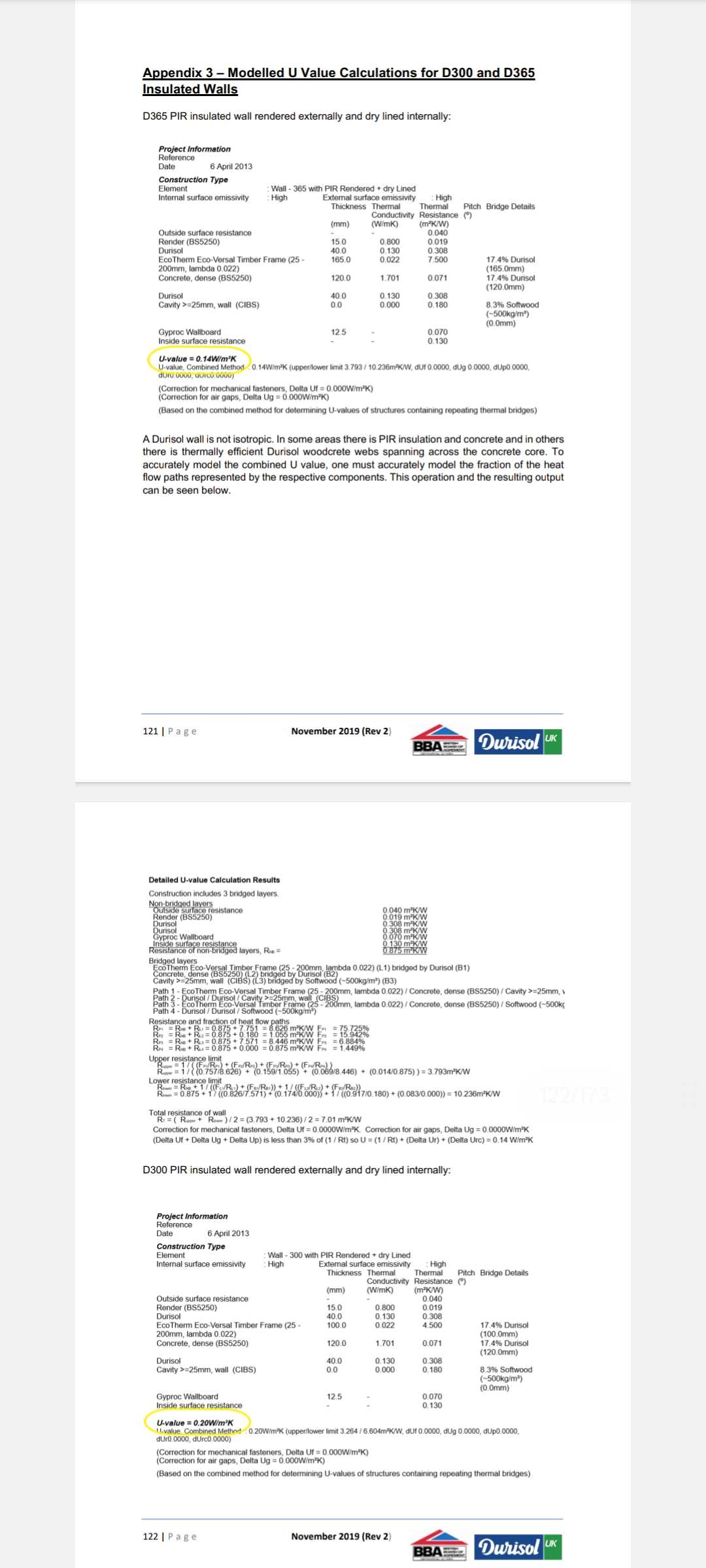

JohnMo Posted September 4, 2024 Posted September 4, 2024 Starter fir your calcs on U value calcs for 300 and 365mm blocks 1
JohnMo Posted September 4, 2024 Posted September 4, 2024 (edited) You can download all sorts here, including the build manual, which is where the calcs came from. It also has all the thermal thermal bridging calculation for all standard details with are all SAP EPC approved. https://durisol.uk/technical-resources/ Edited September 4, 2024 by JohnMo
