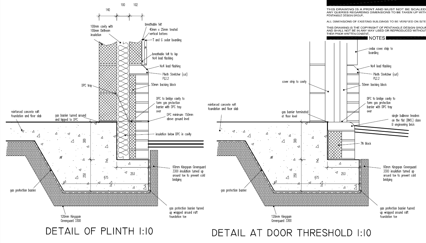

Lead needed at top of plinth under cladding
We're going with feather edge cladding (not the T&G shown below) above a brickwork plinth. The construction drawing detail calls for Code 4 lead, but the separate written specification document doesn't mention it. Is it needed? The Plinth stretcher bricks are actually headers but are Class A Engineering brick. The lead is a cost but also not a nice material if growing things near the garage.
