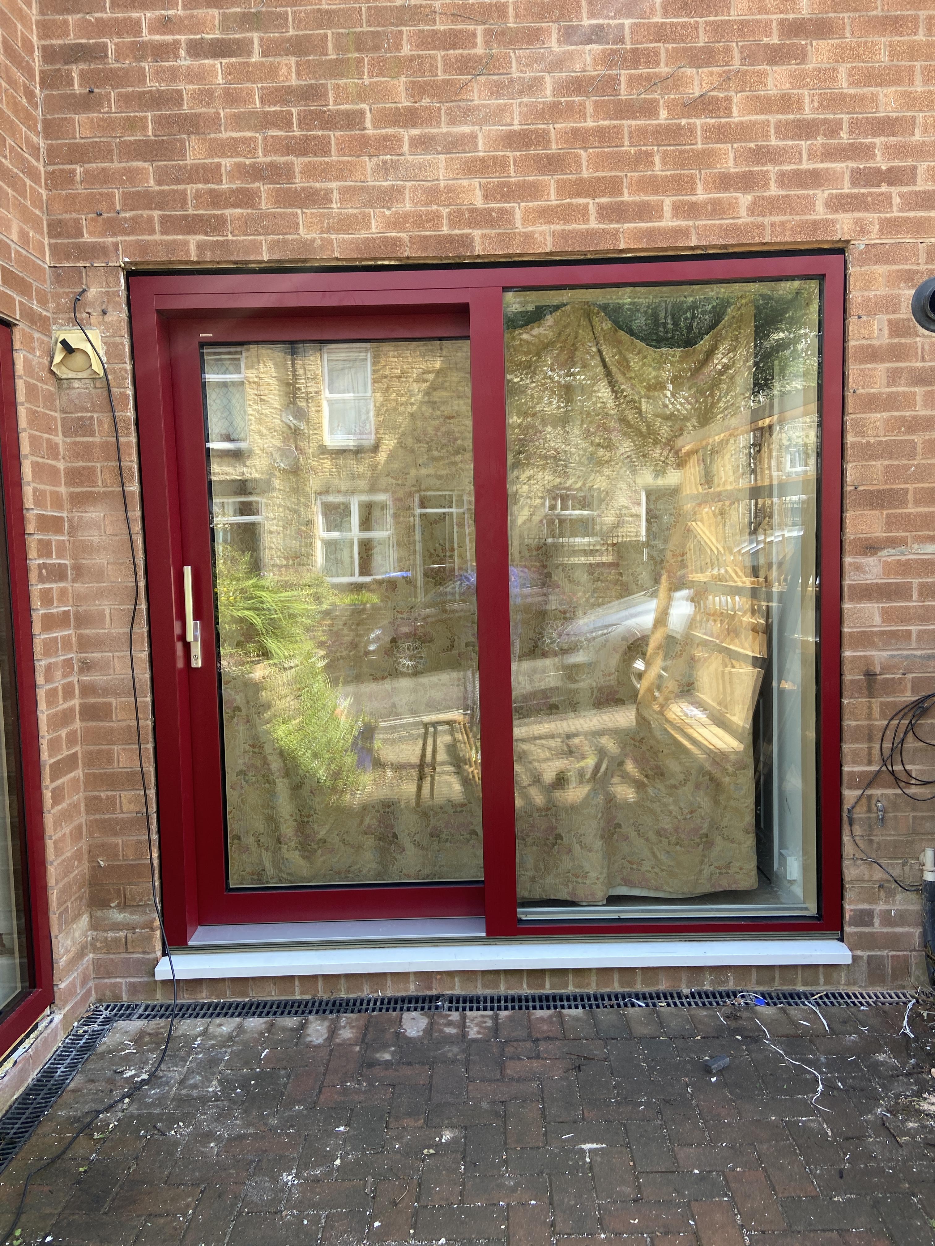

ClairedM Posted June 4 Author Share Posted June 4 The MD and the fitter came out yesterday and it was ok. But today I think I was too polite and just accepted what they said. The large lift snd slide doors at the back. With the horrid gap underneath. The end 60cm or so is just resting on the edge of the 6 floor boards. The floor board joist is about the same distance away and inline with the doors. The MD and the fitter stamped on the floor there and said that it was solid. The fitter said that he was satisfied. Is this correct? Should the door be supported by brick or something for all its length? or part of it? Given the threshold is up (see other thread . sorry I should have put it all in one place.) is the door just too short? (if it has been heigher then it would have rested on both inner and outer brick layers. Link to comment Share on other sites More sharing options...
ClairedM Posted June 4 Author Share Posted June 4 (edited) 2nd thought post visit. The front life and slide doors that rest on the old pvc/chip board ledge are also too short. Or there'd be no need for the ledge. The fitter said that the new doors couldn't be on the floor as the concret was crumbled. ......So I had a look and its not. And the fitter wouldn't have known this when they did the measuring. And there is a continuous gap under the frame of the door. The gap is a gap with no supports. No fixing. This cant be right. Please send check me as I really doubt myself. Edited June 4 by ClairedM Link to comment Share on other sites More sharing options...

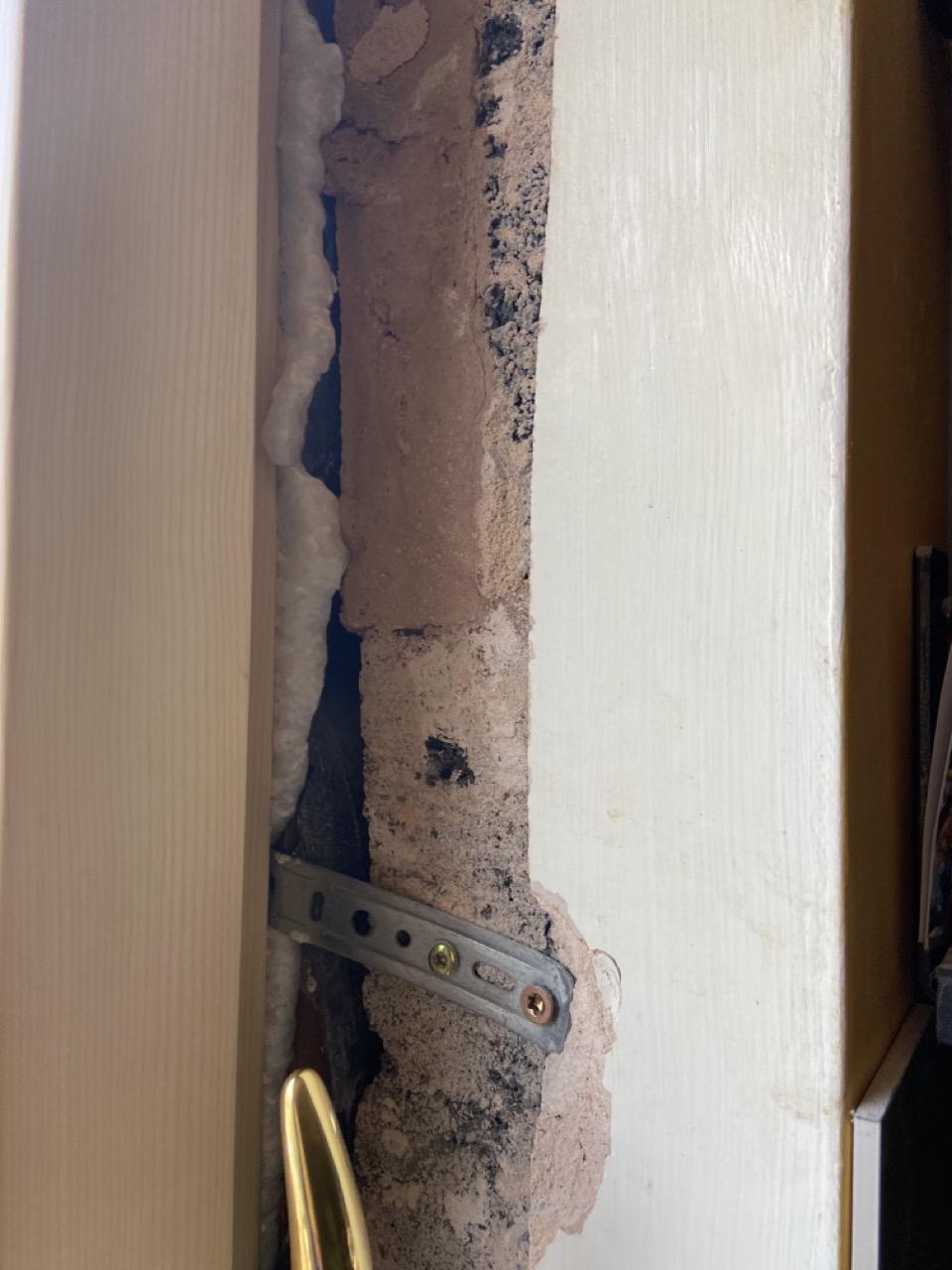

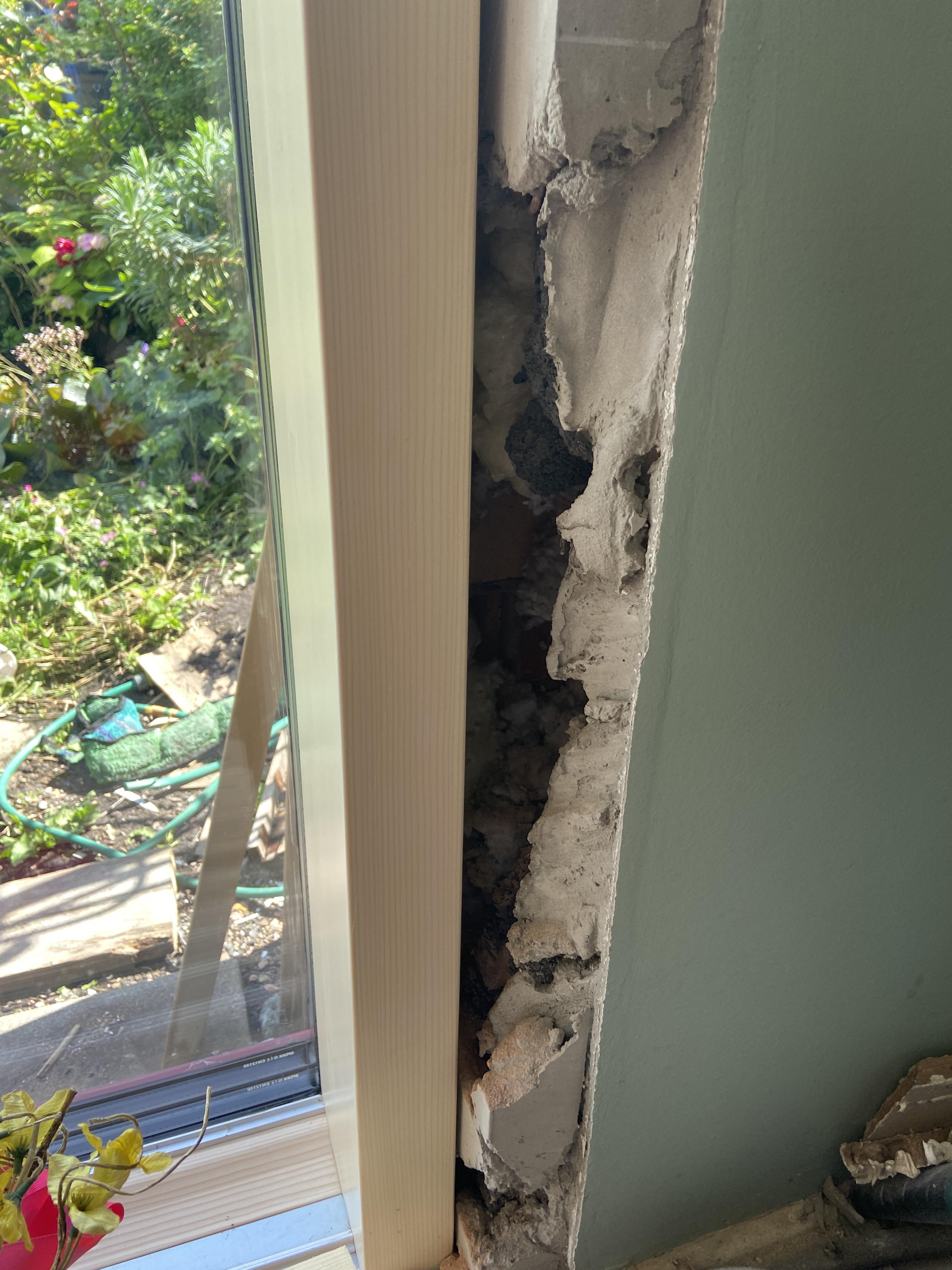

ClairedM Posted June 4 Author Share Posted June 4 Cavity walls and expanding foam and plaster board. Cavity wall breaching. 'All it is is plaster board' But surely this isn't right. They also said ;'that was how your walls where made.' But if the cavity is open and its edge is on the wooden frame of the Internorm would the damp/humidity of the cavity damage the frames? Link to comment Share on other sites More sharing options...

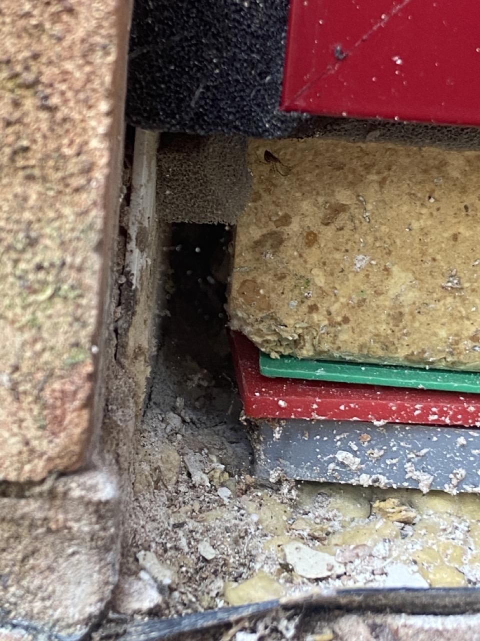

ClairedM Posted June 4 Author Share Posted June 4 and corner lower external edges of windows. Where the wedges are. Is it 'ok' the fill the hole and cover the wedges with expanding foam and then cover with a sill? If the foam isn't all the way around, will water just pool and track back at the wedges? Link to comment Share on other sites More sharing options...

alexo Posted June 4 Share Posted June 4 (edited) 3 hours ago, ClairedM said: and corner lower external edges of windows. Where the wedges are. Is it 'ok' the fill the hole and cover the wedges with expanding foam and then cover with a sill? If the foam isn't all the way around, will water just pool and track back at the wedges? What did they propose when they visited? Have they agreed ‘making good’ on the entire install? It all looks terrible to me (fit and finish). Not just in a fussy internorm passive ‘but I expected the fit to roughly match the airtightness of the windows’ way. It looks so bad that if it is left as pictured they are contravening the basic building regs and you have a clear case against them. And using your old plastic upvc door cill is screaming bodge job, regardless of any ‘making good’. Make sure you put your complaint in writing by email as soon as poss if not already done. Include pics. See if they respond in writing. Do not accept any verbal contact from them. All responses in writing. Then I would contact house insurance legal cover or credit card legal cover and lodge a claim. If you aren’t covered this way try citizens advice bereau. Also complain to Fensa or certass (check who they are registered with) and ask them to do an inspection. And complain to your Internorm rep. The internorm rep will probably offer to come out and take a look (although beware these are salespeople and not surveyors/fitters as far as I’m aware). I would also get an independent surveyor or window expert round to comment in a report. However if you have legal cover they will do this for you. Any costs incurred you should be able to claim back if your legal case is successful. Edited June 4 by alexo Link to comment Share on other sites More sharing options...
alexo Posted June 4 Share Posted June 4 And definitely don't pay them any more money! I would also not let them back on site to do any making good either. Wait till it's been inspected by someone else. They might just try to cover up the dodgy fit with spray foam and trims. Link to comment Share on other sites More sharing options...
ClairedM Posted June 7 Author Share Posted June 7 On 04/06/2024 at 21:00, alexo said: What did they propose when they visited? Have they agreed ‘making good’ on the entire install? It all looks terrible to me (fit and finish). Not just in a fussy internorm passive ‘but I expected the fit to roughly match the airtightness of the windows’ way. It looks so bad that if it is left as pictured they are contravening the basic building regs and you have a clear case against them. And using your old plastic upvc door cill is screaming bodge job, regardless of any ‘making good’. Make sure you put your complaint in writing by email as soon as poss if not already done. Include pics. See if they respond in writing. Do not accept any verbal contact from them. All responses in writing. Then I would contact house insurance legal cover or credit card legal cover and lodge a claim. If you aren’t covered this way try citizens advice bereau. Also complain to Fensa or certass (check who they are registered with) and ask them to do an inspection. And complain to your Internorm rep. The internorm rep will probably offer to come out and take a look (although beware these are salespeople and not surveyors/fitters as far as I’m aware). I would also get an independent surveyor or window expert round to comment in a report. However if you have legal cover they will do this for you. Any costs incurred you should be able to claim back if your legal case is successful. Thank you. I;ve been in tears over this. After their visit I emailed Ecotec with my summary of their visit 'expanding foam to fill the gaps, wrap in Illbruch ME508 and cover with Aluminium sill.' I'm getting my shit together and going to to man up next week. Thank you for your support. C 2 Link to comment Share on other sites More sharing options...
