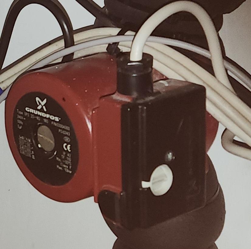

Note there is only one pump in the whole system

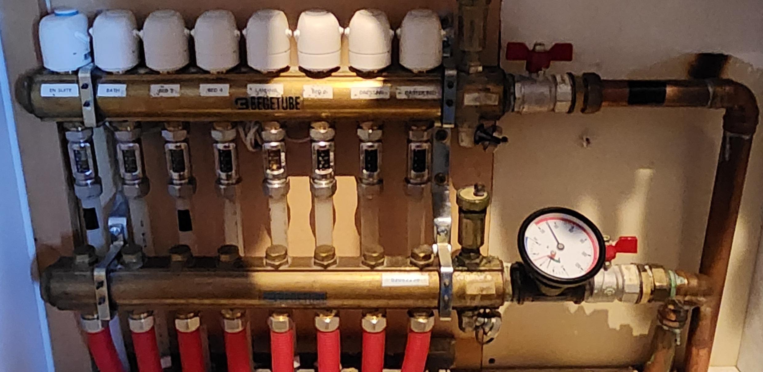

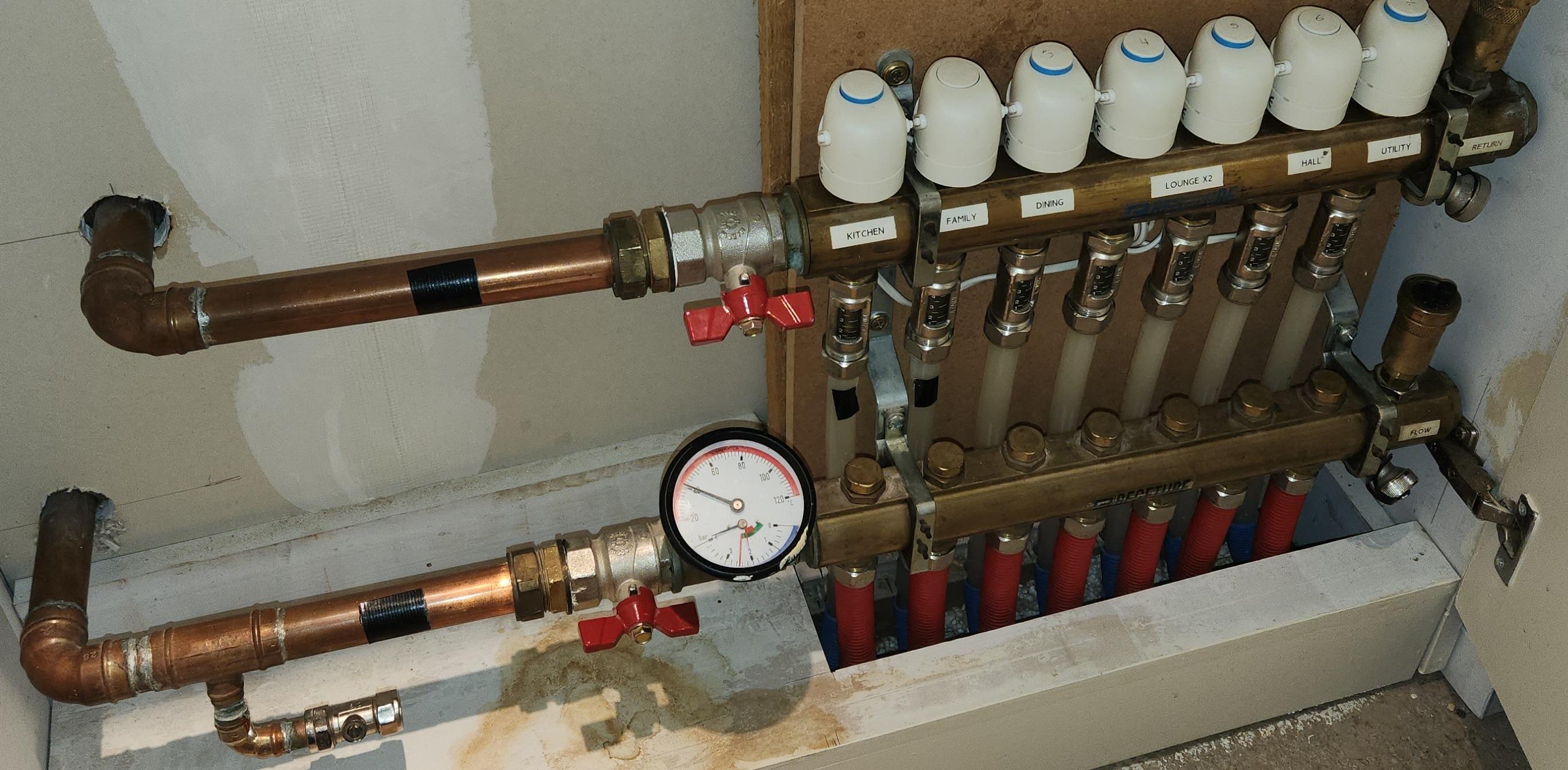

The manifolds have no pump, they look like this
Downstairs
Upstairs
The problem i have is that some rooms are consistantly around 1.5 degrees colder than other rooms while some others are warmer.

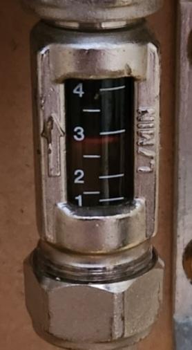

Each circuit has one of these flow rate monitors
the troulble is that most of these are stuck at the top, even if there is no flow.
For the ones that are working i can adjust here with an allen key
Turning Clockwise decreases the flow
Turning Anti-Clockwise increases the flow
I set a one of these to 2.5 but if other circuits come on it drops to around 1.5, is this normal?
What might be the best way forward, should i decrease the flow rate on the cold rooms and increase the flow rate on the warm rooms?
