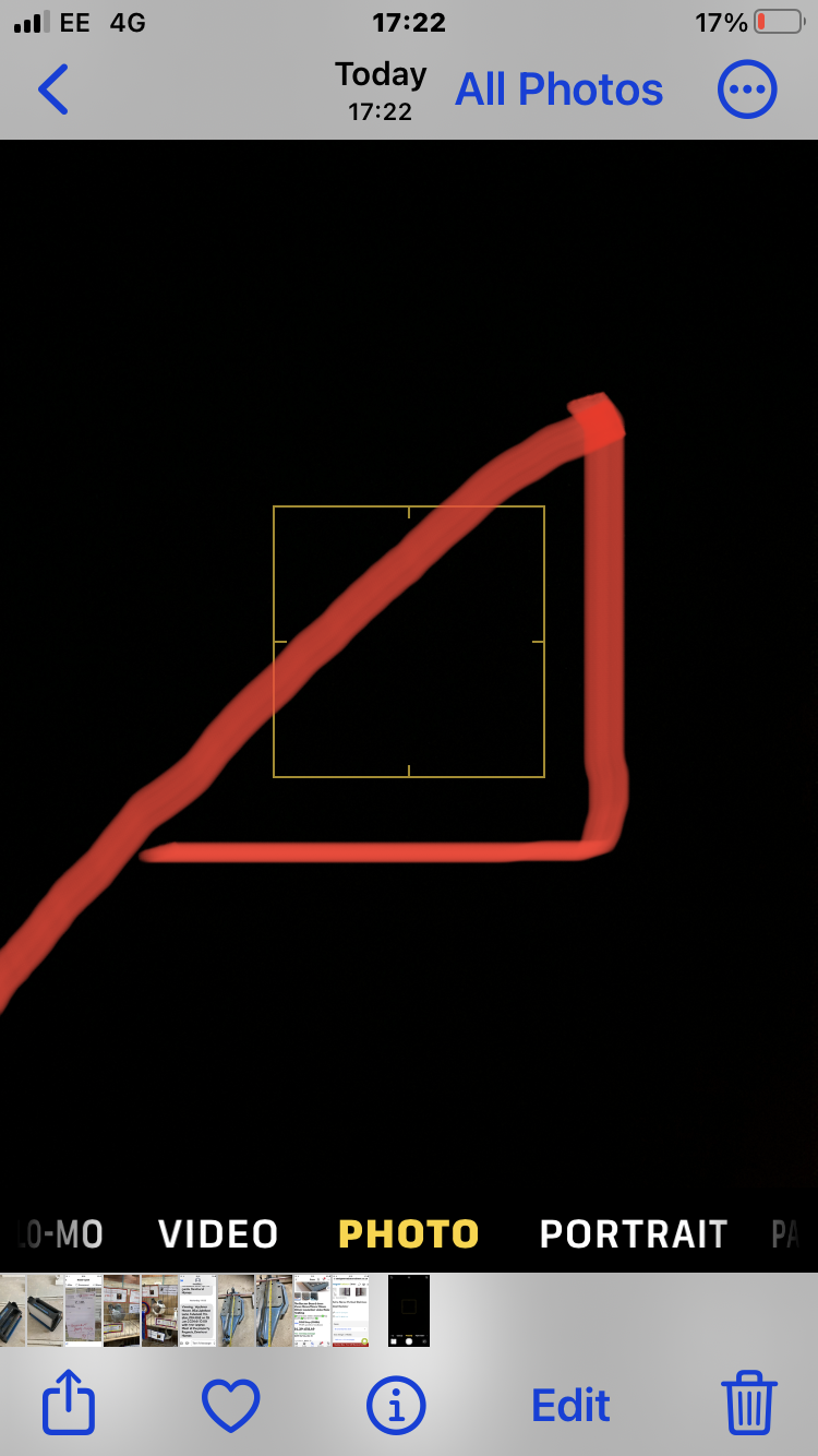

I have a pitch of 18deg. how do I work out the difference in height between the outer and inner (incl. wall plate)? The cavity is uninsulated (old build) and the rafters are 100x50. Want a minimum overhang. Thanks.
I normally make a triangle of the relevant pitch and simply sit it on the wall plate and hang the long leg over the cavity and outer leaf and measure up image.thumb.png.3962daa3d2a5fb5f0c6f73e7ce4c5995.png
