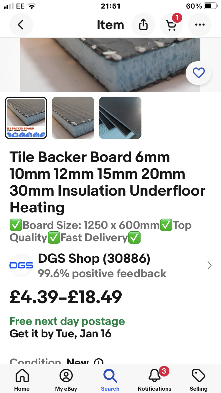

Ply for tiling went out with the arc
I use this on most of my jobs Insulated and different thicknesses image.thumb.png.4d643352497ce354b16420e027c659d7.png
