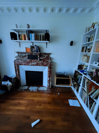

Let us start with a surprise - the two chimneys behave rather differently:
May be an image of text that says 'Cen 18.7 Max 30.4 Min 8.2 30.4 HIKMICRO 8.2 0.5m E:0.97'May be an image of text that says 'Cen 18.3 Max 23.3 Min 14.0 23.3 HIKMICRO 14.0 0.5m E:0.97'

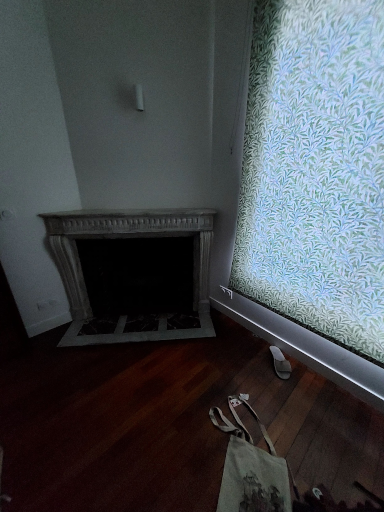

Here is the one on the left:
(Again, my apologies for the mess.)
Here is the one on the right:
As you can see, both have iron shutters. My understanding is that the first one is fully functional, whereas the second one would need some serious cleaning - but it is not sealed as far as I know.
I do not know what causes the difference. I believe I have sometimes heard the wind howling through the first one.
All I can think of is:
- using a chimney stop such as this one (how does one size it correctly?): https://www.amazon.fr/Anti-courants-dair-pour-cheminée-33cm/dp/B00SEL5VXS/ref=sr_1_14?__mk_fr_FR=ÅMÅŽÕÑ&crid=YCB9JMDUFCP7&keywords=chimney balloon&qid=1704853489&sprefix=chimney balloon%2Caps%2C150&sr=8-14&fbclid=IwAR2OCmsZlQjP0k_4syBo2itzNmKYscrUc1DWMYPfL86fY9JMKT9ui_2ESt8
- getting a solid-wood book case with a heavy back to put against the chimney; that would add resistance while being easily removable.

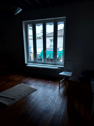

a) Bathroom and shower room. This is double-glazing installed some ten years ago by the previous owners.
May be an image of text that says 'Cen 16.7 Max 21.0 Min 14.1 21.0 C HIKMICRO 14.1 0.5m E:0.97 C'May be an image of text that says 'Cen 18.0 Max 21.4 Min 14.4 21.4 14.4 HIKMICRO 0.5m ६:0.97'

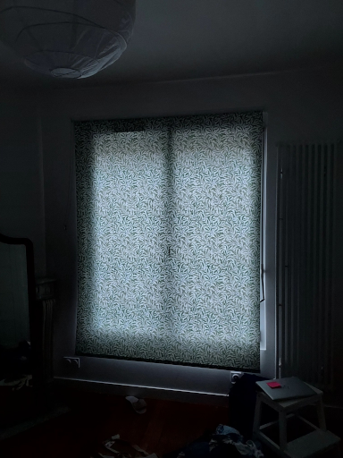

b) This is the bedroom. Again, this is old double-glazing, and the orientation is NWN, but still, a minimal temperature of 12.4 seems low. Maybe there's an issue in the upper edge?
The thin roller curtain does seem to help some - or is the fact that its surface temperature is not lower than that of the walls meaningless?
May be an image of text that says 'Cen 17.4 Max 24.4 Min 12.4 24.4 T HIKMICRO 12.4 0.5m £:0.97'May be an image of text that says 'Cen 18.2 Max 24.3 Min 15.4 24.3 C HIKMICRO 15.4 0.5m €:0.97'

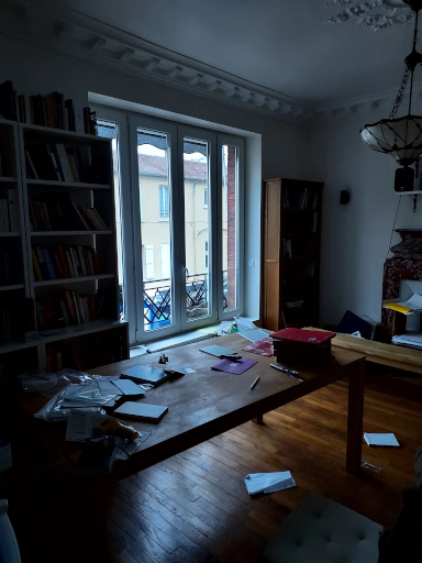

c) Library
This is new double glazing.
May be an image of text that says 'Cen 18.0 Max 24.3 Min 14.1 24.3 C HIKMICRO 14.1 0.5m £:0.97 C'image.png.50ec612e76fb25601bac372f0bb7b168.png
May be an image of text that says 'Cen 17.3 Max 27.5 Min 14.6 27.5 14.6 1 HIKMICRO 0.5m E:0.97'image.png.ee8421d6c319a22ba0238a96406aafad.png
No great surprises here (other than the chimney). The PVC frames seem significantly colder than the glass itself - yet another reason (other than maximizing light) why I believe it would have been better to have two-pane windows, even if opening it would have been somewhat inconvenient.
The (sold wood) bookcases are noticeably warmer than the rest. I will probably put some 2cm wood on the windowsills - or is there a reason not to?

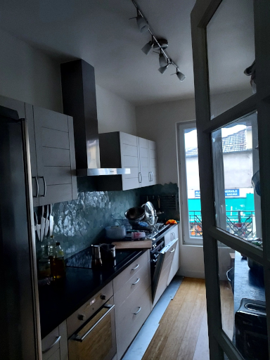

d) Kitchen
May be an image of text that says 'Cen 21.5 Max 24.1 Min 17.3 24.1 T HIKMICRO 17.3 0.5m E:0.97'image.png.f31494e6811c790411c906643a80e4a1.png
I do not see much to comment on here. I do wonder what that hot spot is (marked in red).
