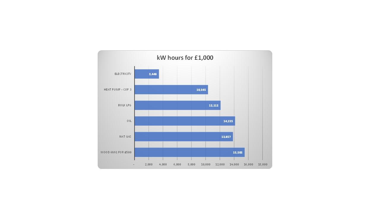

Latest energy caps - source comparison
Not much cheer here although oil has fallen recently. However I see that battery prices have fallen (with lithium) and Fogstar are about to offer 15kW.hrs for £2,500 which is a total game changer. Time shifted night rates and heat pumps - nice. Looking for an inverter/charger for said battery I see that the Victron Quattro-II has a spare 240V input which could connect a V2L from a car (the plug behind the back seat on a few). That would be very interesting.
