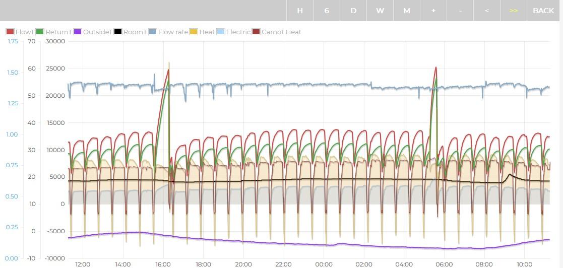

ASHP defrost cycle
Does anyone have an proper data on this?
It would be interesting to correlate it with local weather data and see what conditions make it better, or worse.
Depends what you mean by proper data.
A defrost energy calculator has recently been added to the Open Energy Monitor heat pump app, so you can see data from lots of monitored systems at https://heatpumpmonitor.org/
There's a discussion on defrosting at https://community.openenergymonitor.org/t/ashp-sizing-for-freezing-conditions/24802/60
My system shows a calculated energy loss of 7% for defrosting, but these are quite extreme conditions. (-6C last night and 94% rH.
Basically a time series, in a useful export format i.e. .csv, .txt, .xls
That can be correlated to local temperatures and RH, which is usually easy enough to get hold of.
Initially I would just look at instances of the defrost cycle happening, just to get a feel of the problem.
