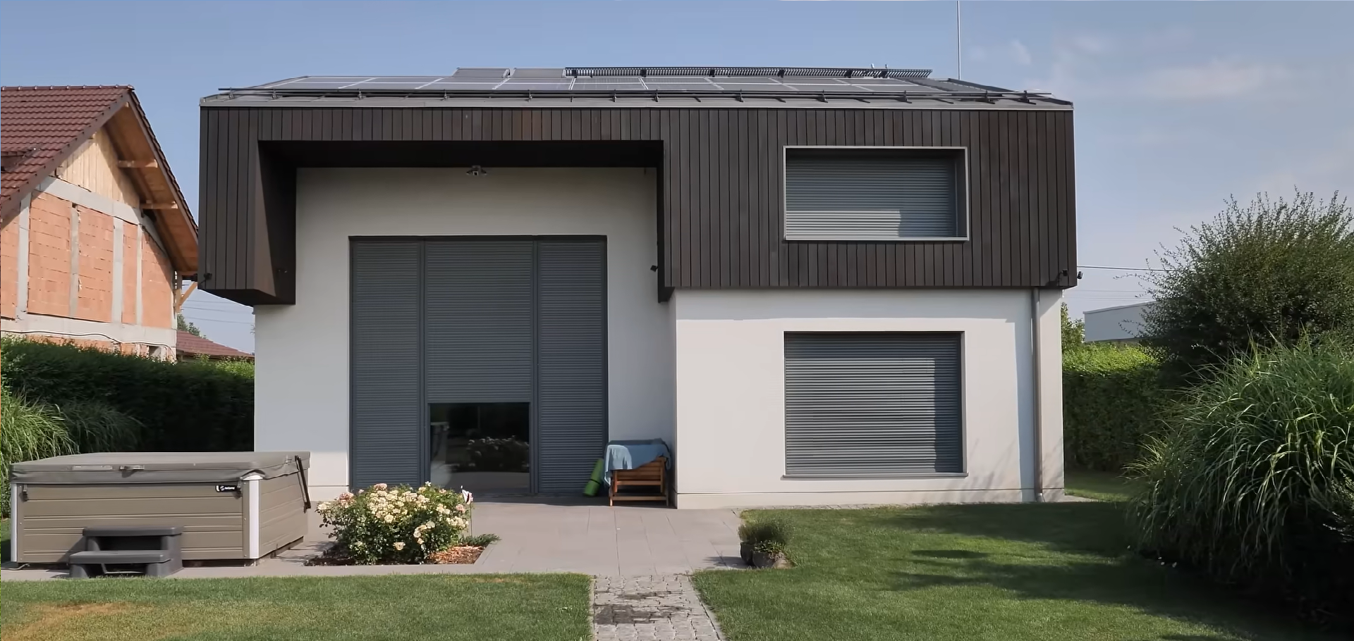

Oh and *don't* chase solar gain in the winter with lots.of south facing glazing!  It will cause more problems with overheating on sunny days and especially in summer than it solves with "free heat" in the winter
This is a passive house that as you can see, keeps the shutters down on sunny days.
