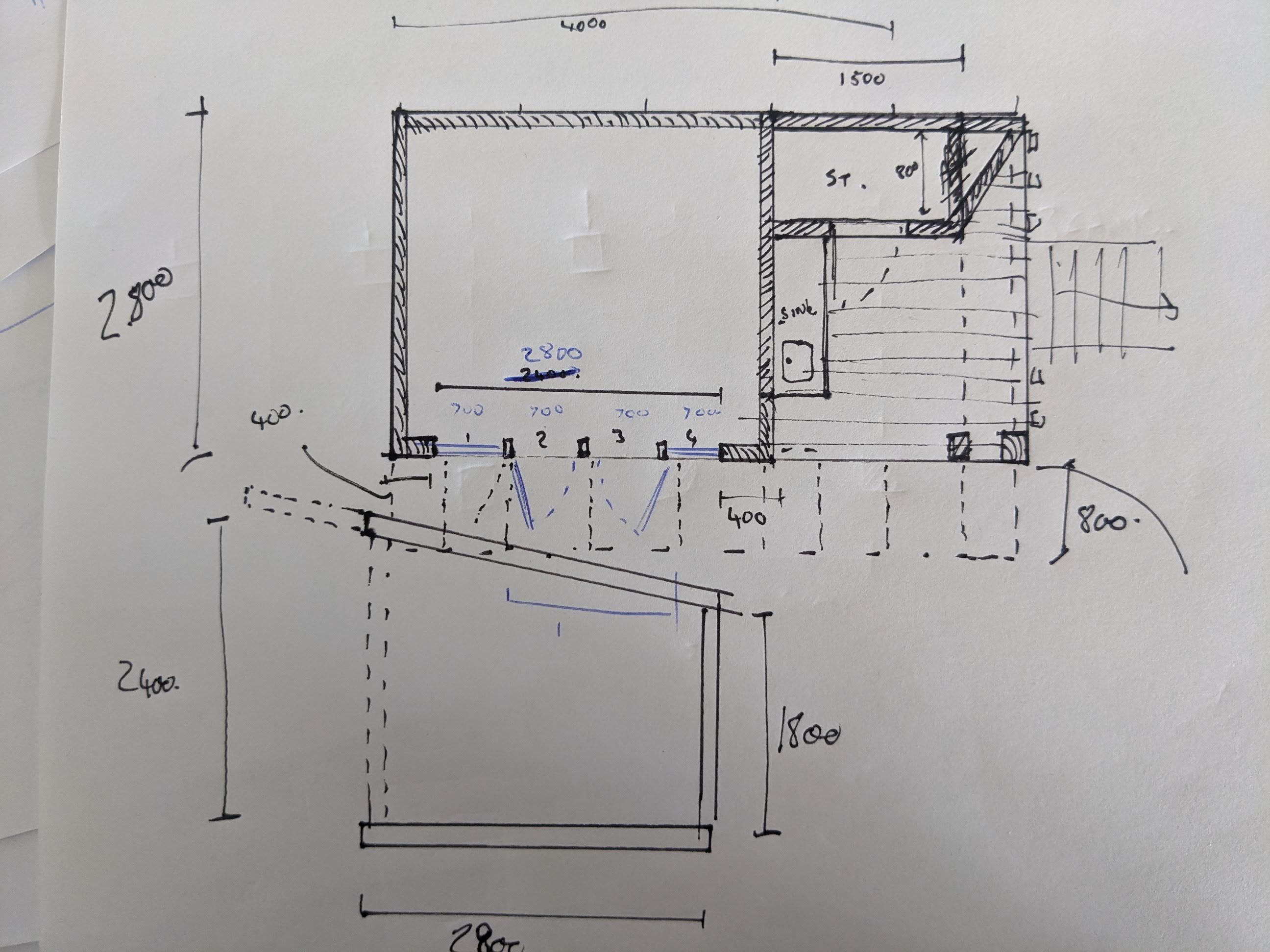

After a little advice/ thoughts on my pads/ beam and and joists dims for a smallish garden room/ deck i'm building. Its on a fairly substantial level change - approx 1m.
See attached sketches that hopefully explains well enough, perhaps i'm over engineering here, but perhaps not!

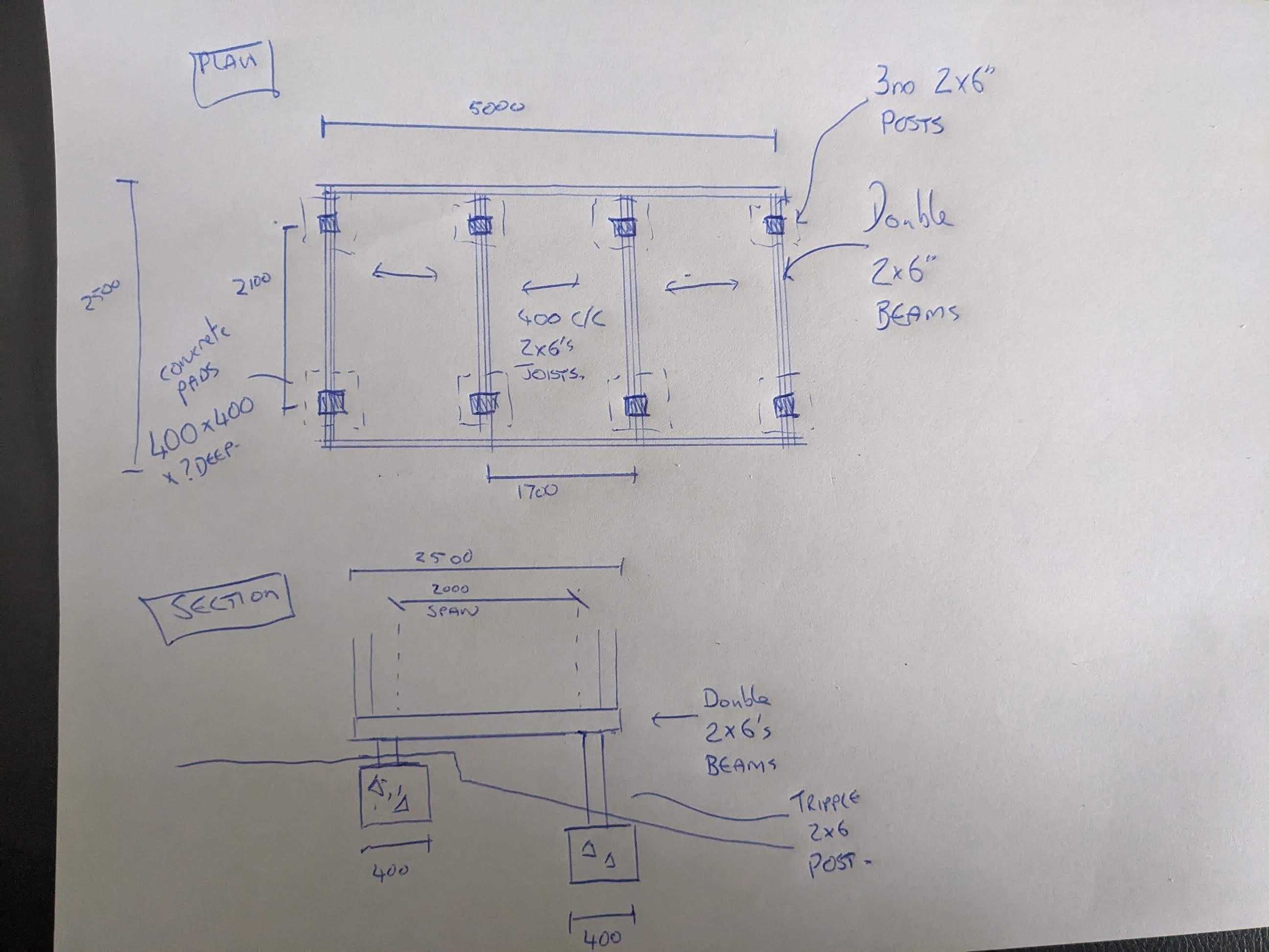

- Basic premise is footprint of approx 5000mm x 2500mm. 2 rows of 4 pads to make 4 short beams running front to back. Posts to be tripple 2x6s ( too much!?) to double 2x6's for beams with 2x6s joists on hangers. Beam spans will be approx 2000mm between posts, and joists span 1700mm.
- some simple cross bracing to posts
- Single story timber frame building with cedar shingles 3m width and then 2m width decking.
- Concrete pads approx 400x400 x tbc depth with post shoes cast in to hold above ground level
- Ground is soft topsoil but down to much harder sand/ clay.
