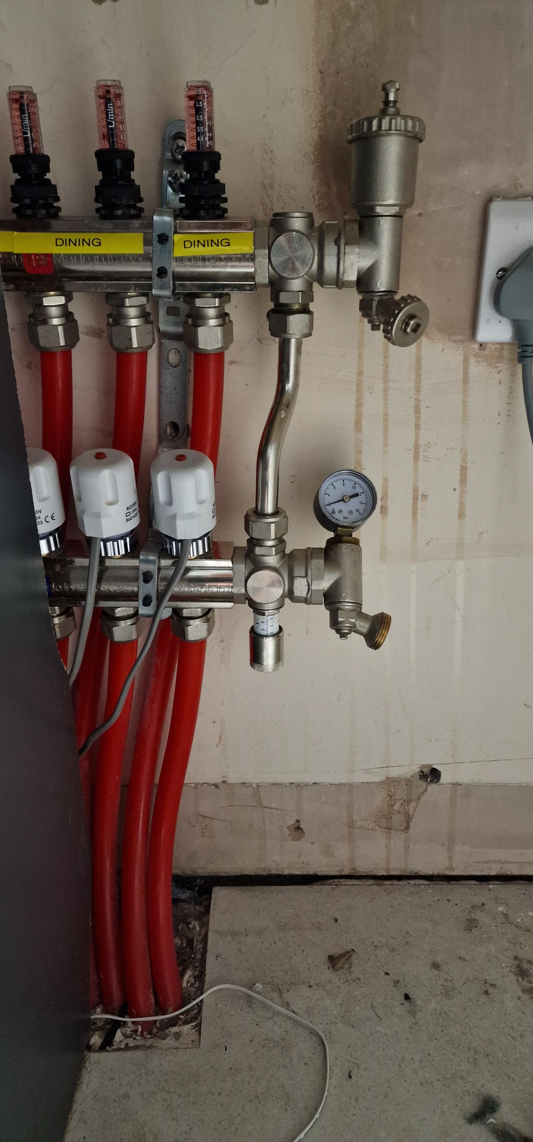

I have a Ecodan ASHP connected to an underfloor system.
On controller the flow input temperature target is set to 45 but after a few hours it can't get past 40 degrees. What can cause this and what's the solution.
I have a second of the floor that's pretty cold yet the loop has 1.5l fliw rate. What would cause this .
Last up the differential pressure bypass value seems to be fitted upside down. What effect would this have on the system? ( see pic)
Thanks
Paul
If you have a buffer you may well get a temperature drop across the buffer so will have to compensate.
Increase your second floor flow rate, that will increase the mean flow temperature to increase energy input to the room.
