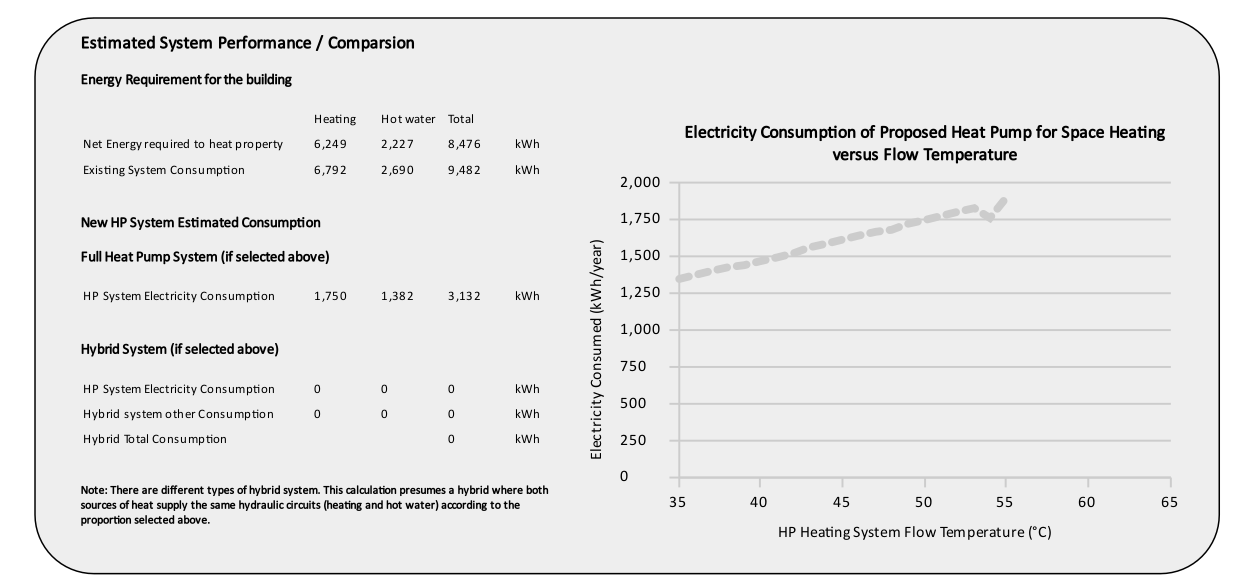

Just trying to get a head-start on planning the UFH here. Heat loss survey done at the time of heat pump insulation puts the annual space heating demand at 6250kWh, and suggests a flow temperature of 30°C would save a good 500kWh of electricity/yr compared to 55°C, so if I can get it in relatively cheaply, it seems like it'd be a win:
452759025_Screenshotfrom2023-01-1709-02-01.thumb.png.04f1a78e9d61438b8bb3312aa6f22fb8.png
(Weather compensation is on and the radiators never feel like they're at 55°C; I don't have a good idea of what temperature it's actually running at, so saving 500kWh/yr is probably the best case scenario).

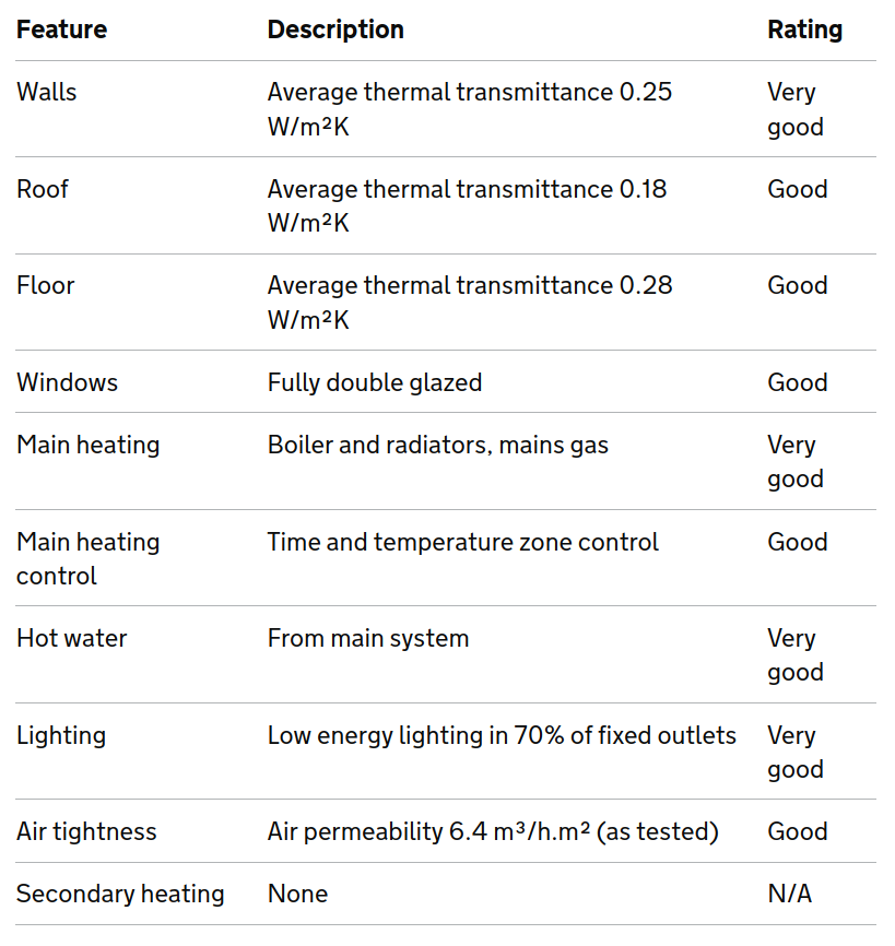

It's a relatively-new-build, with a solid concrete floor downstairs. The original EPC gives the floor a U value of 0.28W/M²K, so presumably 75mm PIR or so underneath the concrete - feels insufficient? Although on par with the walls 🤷‍♂️.

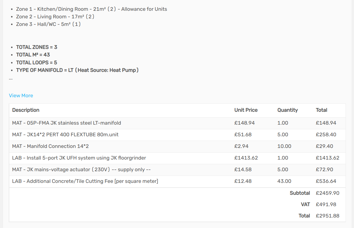

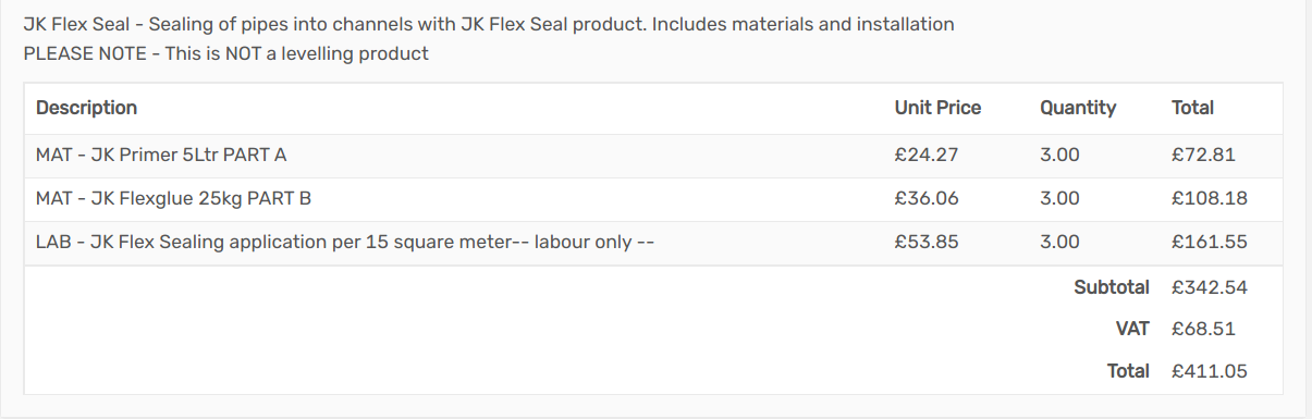

Just following this up - I got a quote off them today. They do the grinding and install the pipes quite happily, but you have to get someone else to pour a 3-10mm screed on top for most finished flooring types, and of course, that has to dry before the UFH can be used. To avoid that:
> NB: Tiles, Natural Stone and bonded wooden floors can be applied directly on top of the JK® system without any levelling or smoothing compounds. A suitable flexible, UFH suitable, adhesive need to be used in all cases.
but I was never going to do any of those.
Pricing detail:
1222803544_Screenshotfrom2023-01-2019-19-59.thumb.png.ba3a1834b5ea6f002114e94a55756628.png718676494_Screenshotfrom2023-01-2019-20-13.thumb.png.a0664e78df38f617d72c2d52a31c264d.png
So nearly £80/sqm (inc VAT) for everything except the covering screed and a bit of electrical work. Grinding the grooves in a sand/cement base is ~£33/sqm (+VAT) at my scale; doing it in concrete or tile adds ~£12.50/sqm to that. The kitchen is (badly) tiled so the idea that they could put the grooves straight into what's there, rather than me having to take it all up, is attractive.
All in, probably too much for me, and more disruptive than I was hoping ^^ - but maybe useful information for someone else.
