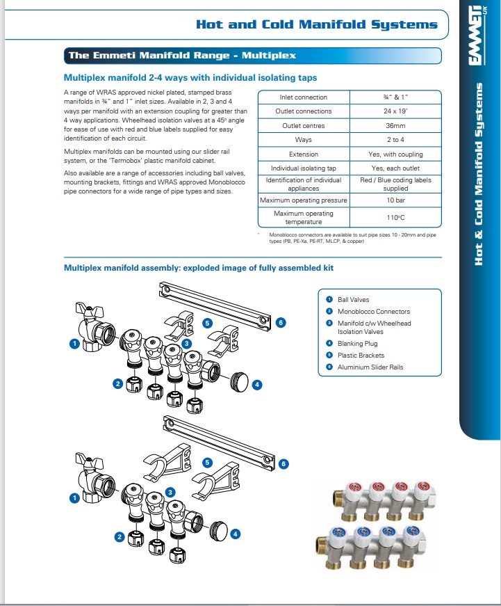

Hello,

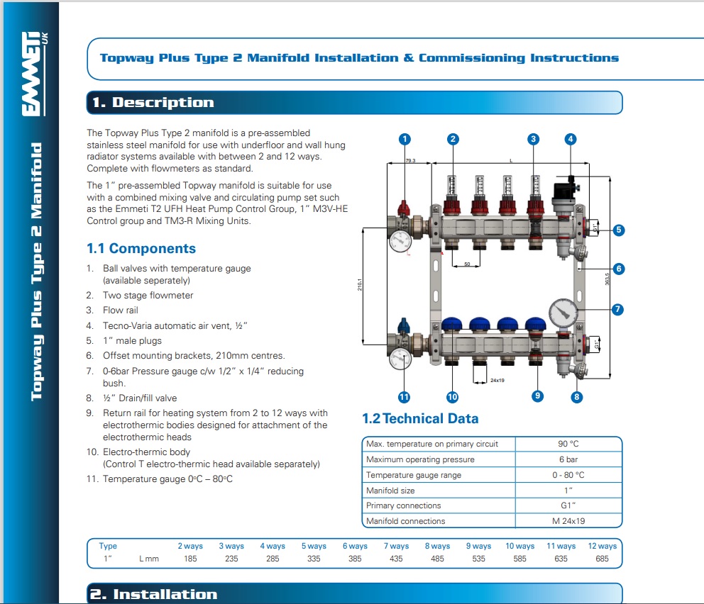

I have installed my underfloor heating system and specified Emmeti Topway Plus Type 2 Manifolds. I fitted my 16x2 pipe with the connectors that came with the kit. I assumed that these were Eurocone connectors.
I have now bought some Emmeti Multiplex Manifolds for my house hot and cold water distribution. I will be using 15x2mm PB pipe. These have the same type connectors.
In my ignorance, I bought some Eurocone connectors and they don’t fit.
I have attached the data sheets for each product. They show a 24x19mm connection for both manifolds. Whereas a Eurocone connector is apparently ¾” BSP.
The connectors appear to be an Emmeti product called Monoblocco, which hardly anyone seems to stock.
Has anyone come across these connectors? I’m not quite sure why Emmeti have re-invented the wheel with a very similar connector, when most of the other UFH manifolds seem to use Eurocone fittings.
Thanks.
