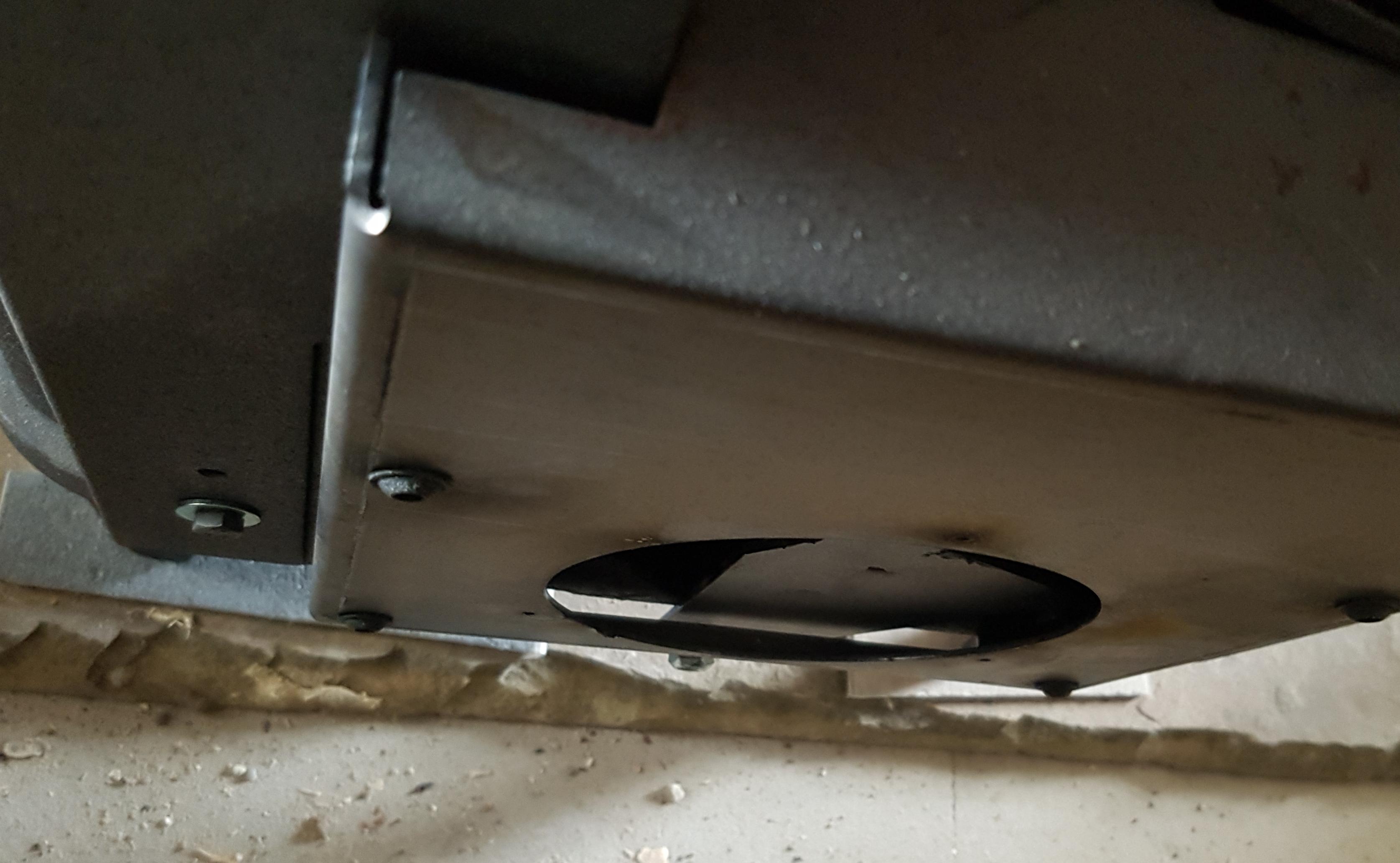

Morso 3116 option for Direct Air feed duct connection allows air to escape
Just a warning to those looking to fit wood stoves into airtight homes... it is not enough to just look for one that has the option offered of 'Direct-Air' feed. You need to look for 'Room-sealed'.  The Morso 3116 direct-air kit is a very poor design and will let air into the room as well as into the stove.
