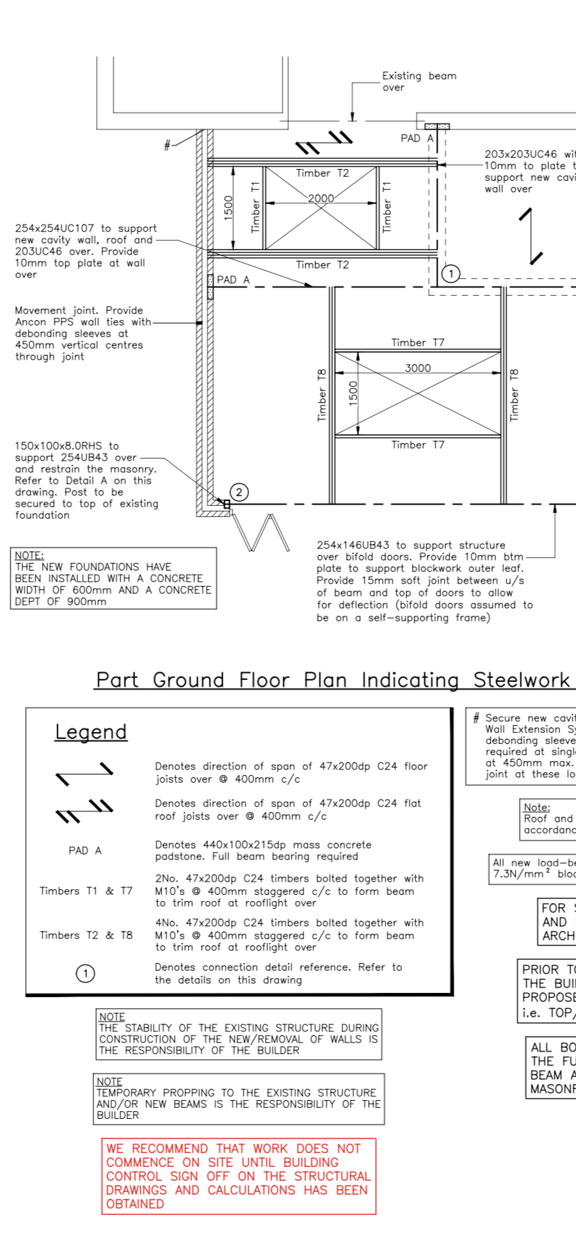

We’re putting the joists for the roof in next week. Roof lantern at the back is going to be substantial smaller so not a problem. The 3x1.5 lantern at the front shows 47x200 joists tripled up but the key says 4 of. My chippy is saying 4 is a problem as you can’t get hangers that big. I’m going to try and contact structural engineer next week but in the mean time can anyone offer any advice?
