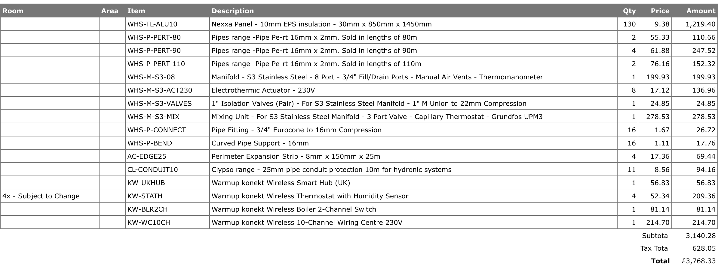

I am installing UFH in a new build along with an ASHP.
The UFH will be laid on top a a 175mm floor slab with 150mm insulation underneath this. I am proposing to use a warmup nexxa system with the panels and have received a quote from them for supply or around £3.8k for an area of around 145m2. This includes everything I would need as below.
FYI panels to be used as I don’t know a better way to install as it is directly on the floorslab.
Looking for advice on the following.
  • Is this a reasonable quote, what other manufacturers should I look for, warmup came recommended?
  • How many zones should I have? Currently have 4 stats spec’d. I have 1 big open plan kitchen/living/dining and 3 other rooms tv/study/lounge outwith this and then the hall/wc and utility. I know for certain the lounge won’t be occupied that often. Should I look to reduce the number, have seen numerous threads people recommending to use just 1 for the floor but don’t want to heat a room that doesn’t need heated?
  • Because the Insulation is below the floorslab what are the pros and cons. I know the slab will act as a thermal store but how will the response times be and should the UFH be set to a temp and be on all day?
  • Any other advice and tips would be greatly appreciated.

Thanks for the reply John. The insulation is actually below the floorslab so unable to staple on. This is the difficulty in finding a cost effective solution.
