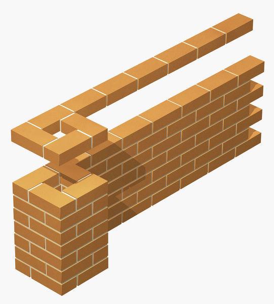

landscape building a curved wall with piers outside to go around a patio
agreed width is 400mm as it will be used to sit on also with some flat coping stones.
my plan was a half-brick skin either side with a 200mm void.
could I use brick ties to hang over into the cavity and infill with a dry mix of concrete - is this too much, what would be your advice please
also does the wall have to be built into the piers so the bricks overlap into the piers and would I need to use ties or could the piers be freestanding with ties and tie the wall into the piers?
thanks In advance
If its not a retaining wall I don't think you need infill or piers. If it is a retaining wall how high is the earth its holding back?
Are the piers going to be on one side of the wall or symmetrical/both sides? Just the ends?
That's how it would normally be done. Some ideas..
singlehalfpier.gif.4d2e28c229bf18338a58b080c780a0db.gifsingle_pier.png.6c99cdc9b44f0544de71bb65deaff0ff.pngoffset-end-pier-brick-wall-built-stretcher-bond-13547055.jpg.1d03081d991f5bef85bd8ca3f4b63eea.jpg
Thanks for the reply. Not a retaining wall and piers will be symemetrical - either side
