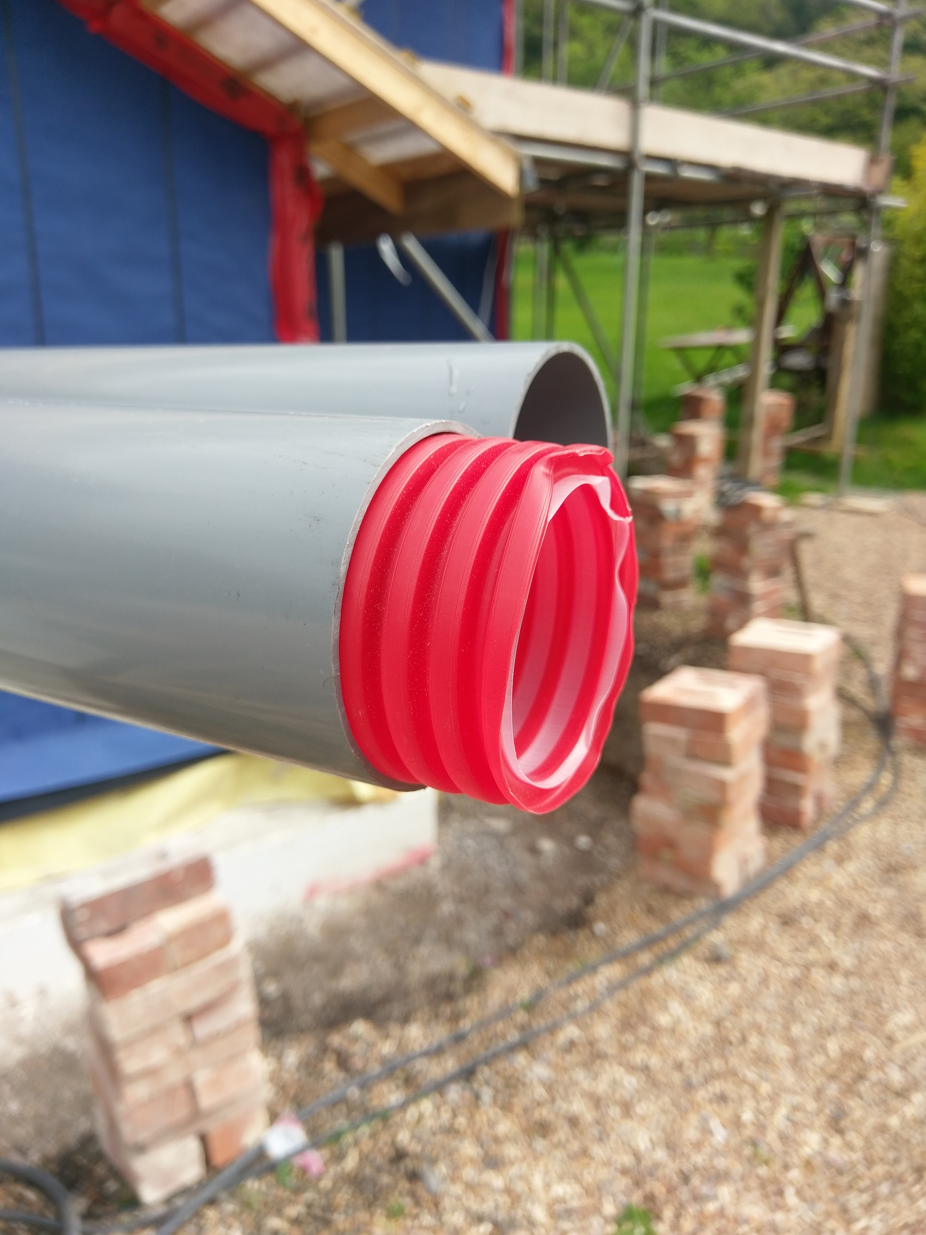

sleeve / duct for 75mm radial pipe
I needed to run a length of radial through the airtight wall and didn't want to run a 100mm duct as a sleeve.
For those looking to do the same
80mm downpipe from floplas is a perfect fit
