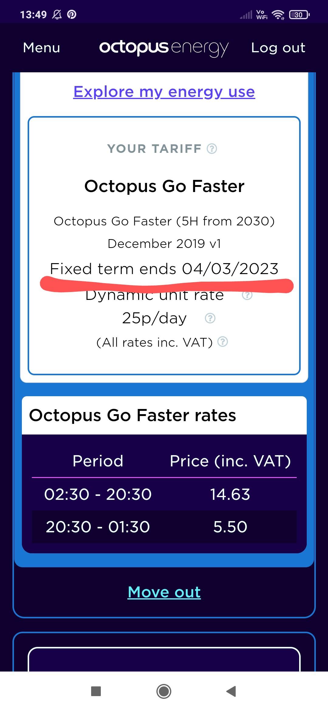

8 minutes ago, JamesP said:
Can you let us know of any changes to your tariff in April, Thank you.
There hasn't been any change, I think our fix must have been for longer as we seem to have stayed on the same one I signed up for last February and it now says it's fixed again until March next year which is a relief.
