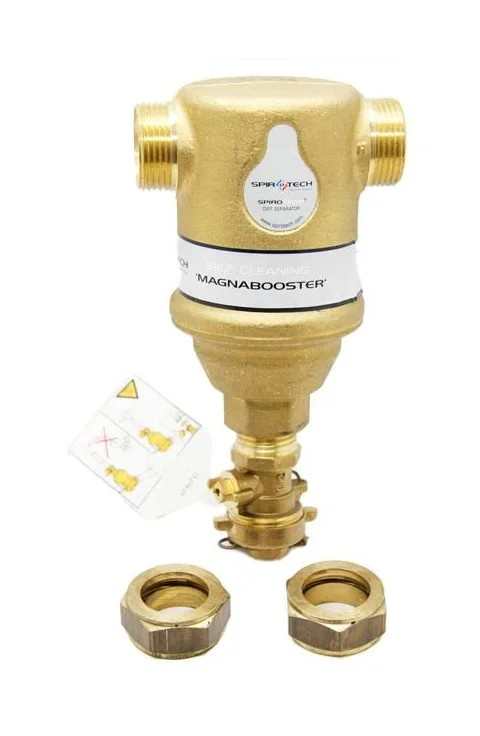

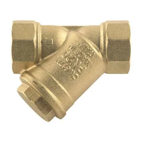

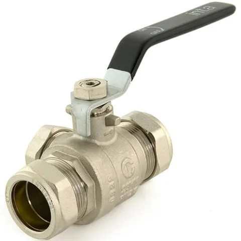

Strainers in system, replace with a low pressure loss central heating filter. Strainers have a pretty huge pressure loss, ball valve strainers are the worst.

not sure what a strainer is
A Y type looks like this
A ball valve strainer looks like this
This what removed and replaced with
